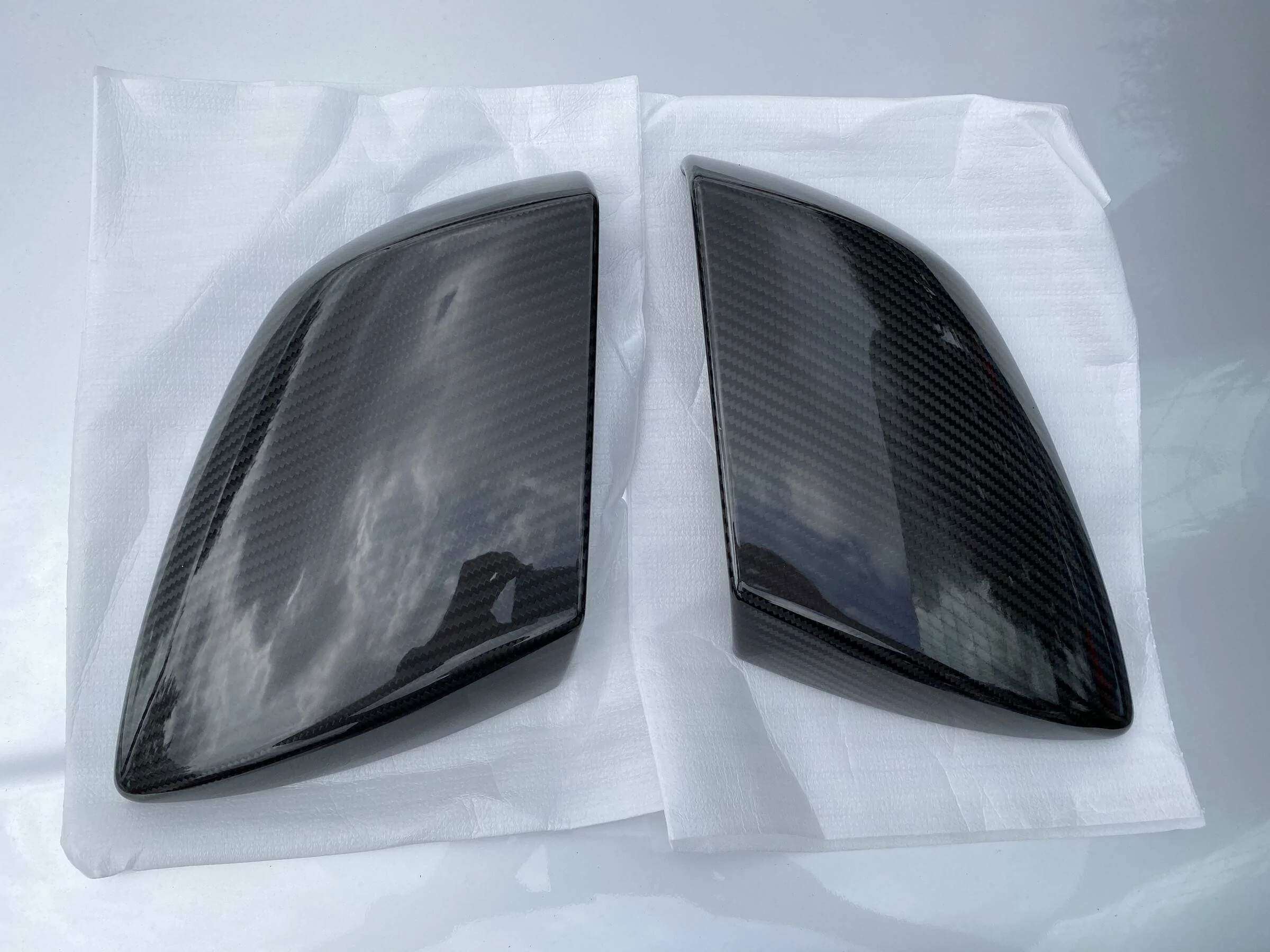

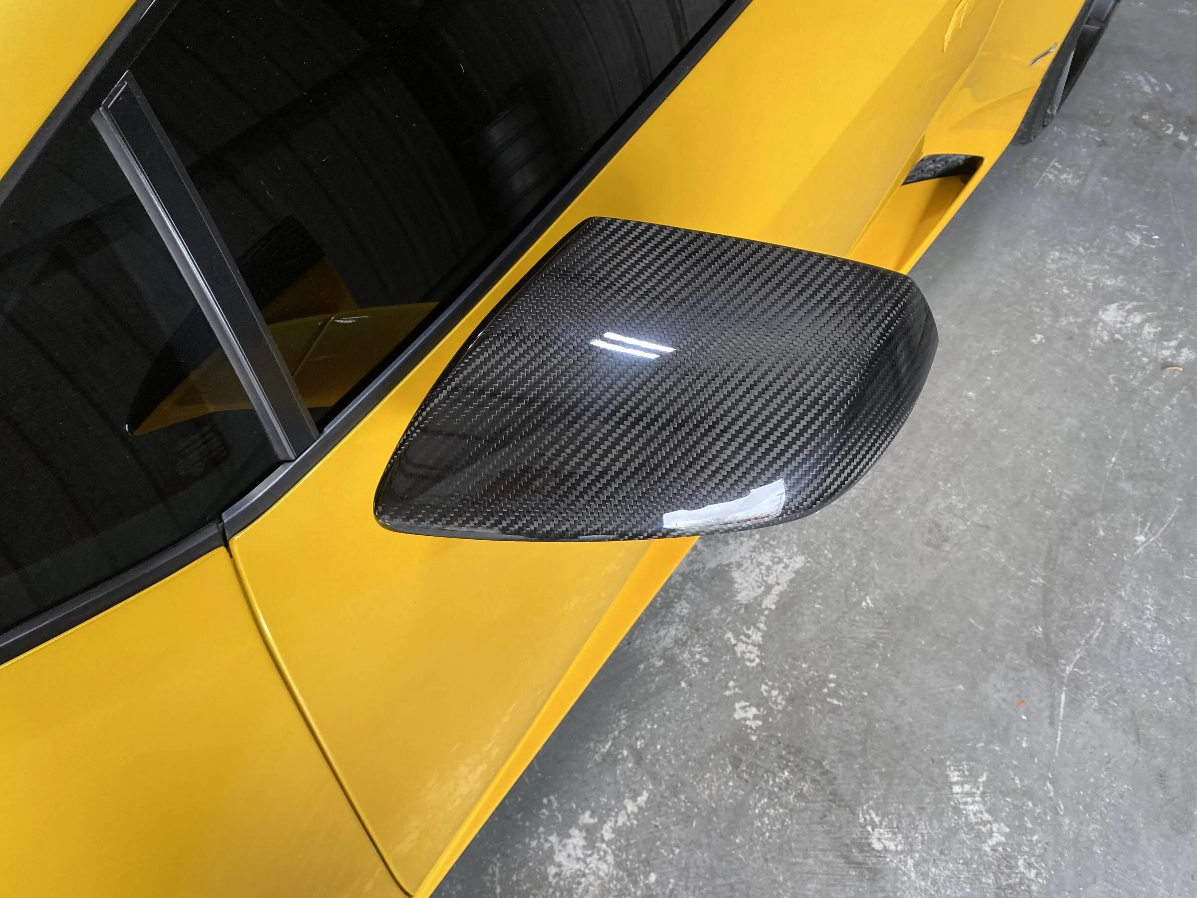

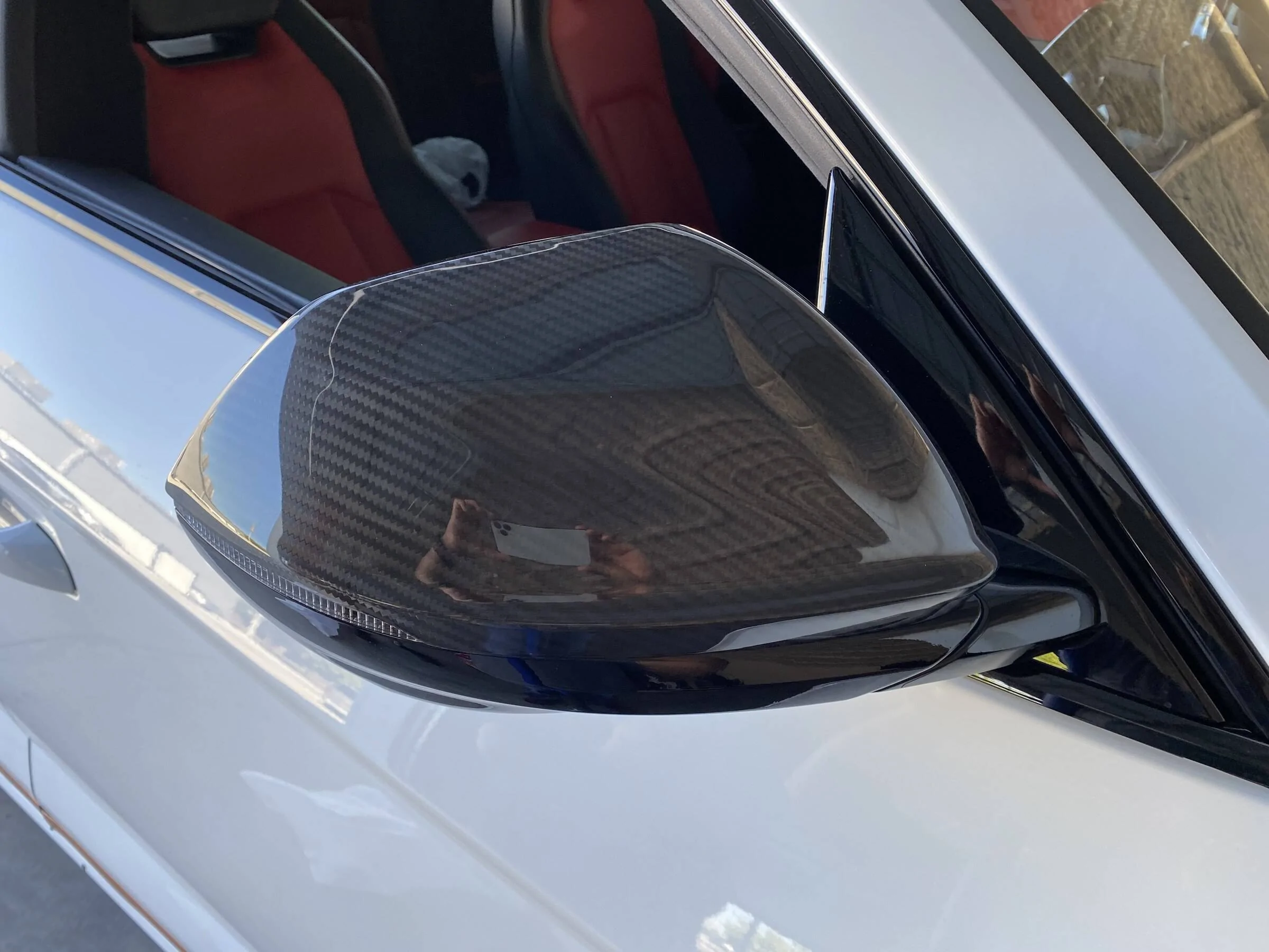

These are the ones that I get made for the Huracan and Urus. So the principle will be the same for the Taycan ones.
Perhaps if you get these made, you can post a video on the ease of instillation and this could be a win-win....you will sell more once people understand the instillation and total cost of ownership and the buyer will have a solid reference to install?
I can tell you, if the price is reasonable (must low enough from factory option to not have it make sense to purchase a branded product) and is a DIY project, I would be interested.
