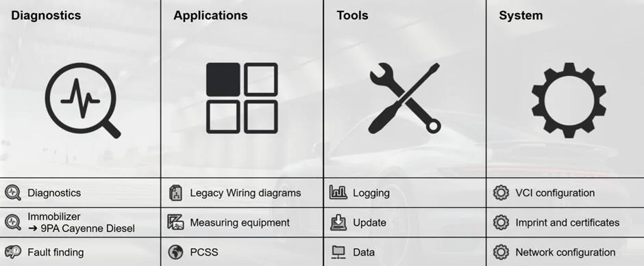

PIWIS is not the friendliest system to use so decided to have a play around in the simulation mode as follows:-
Select Diagnostics

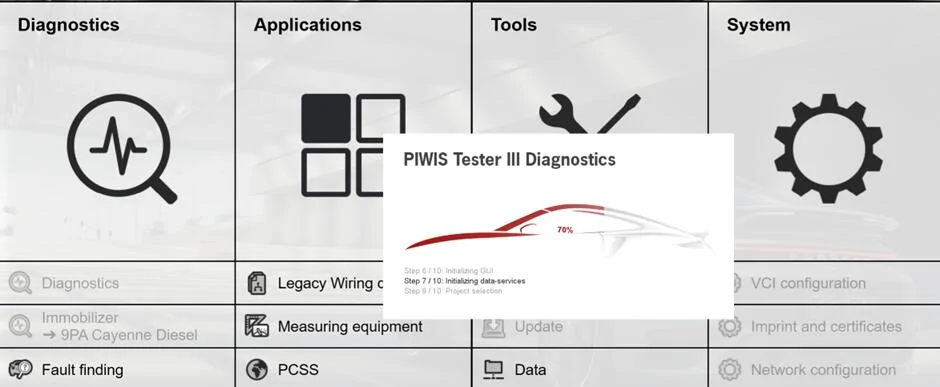

Porsche Taycan Soft brake pedal and thinking about bleeding your brakes? 1742656183843-u
Porsche Taycan Soft brake pedal and thinking about bleeding your brakes? 1742656212115-8f

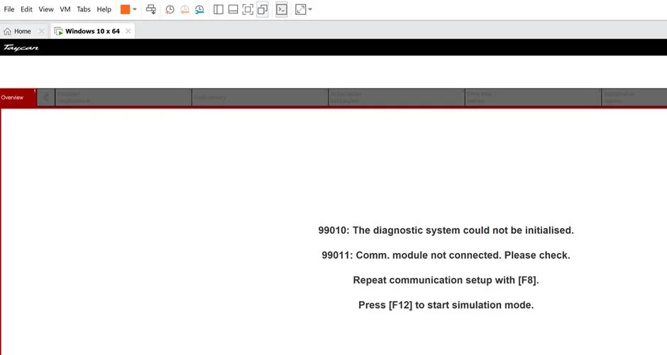

F12 simulation mode
Porsche Taycan Soft brake pedal and thinking about bleeding your brakes? 1742656248309-kx

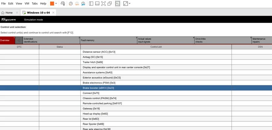

Select your model
Porsche Taycan Soft brake pedal and thinking about bleeding your brakes? 1742656288622-k8
Select Brake booster then F12
Porsche Taycan Soft brake pedal and thinking about bleeding your brakes? 1742656329658-f

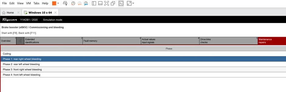

Select F11 or F12 for VAL / No VAL
Switch to the Maintenance tab and select - Service bleeding and Maintenance repairs
Porsche Taycan Soft brake pedal and thinking about bleeding your brakes? 1742656412541-wc
F12
Porsche Taycan Soft brake pedal and thinking about bleeding your brakes? 1742656445507-9g
This guidance is then provided – F12 to continue
Porsche Taycan Soft brake pedal and thinking about bleeding your brakes? 1742656486540-c0
Select the wheel to bleed, then F8
Porsche Taycan Soft brake pedal and thinking about bleeding your brakes? 1742656519679-0v
F8 to continue
