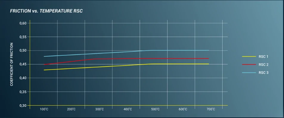

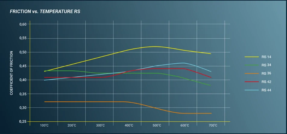

One other area where CC brakes have an advantage is the consistency of CoF. Having combed through enough friction graphs for traditional pads, I was curious. Pagid has their CC pads Cof plots and they are dead flat. That consistency is definitely noticeable for anyone using their brakes repeatedly at the limit.
Porsche Taycan Nice vid about ceramic brakes 1653683079880
Compare that to typical pads. Anyone who's been on a track with track or race pads knows the feeling when your brakes are cold, or too hot.
Porsche Taycan Nice vid about ceramic brakes 1653683298771
Modulation is less easily quantified, but also an important aspect. Have never tried CCBs but would be curious how they compare. And, as any student of Claude Rouelle knows, the bulk stiffness of the pads (and system) is also critical for driver confidence. Doesn't matter if you have a high friction or heat stable compound, if it feels soft under foot, you lose confidence. That's where driver feedback is more important than data alone. Again, I'm curious is there is any appreciable difference there between iron and CC brakes.
