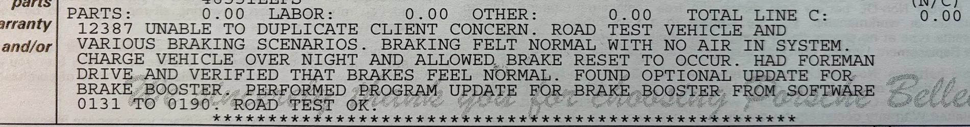

for J1.1, this is the brake booster TSB:
WPK0 - Re-Programming PSM Control Unit (Workshop Campaign): https://static.nhtsa.gov/odi/tsbs/2024/MC-11007026-0001.pdf
I mentioned here previously: https://www.taycanforum.com/forum/threads/braking-while-downshifting.33926/page-2#post-527223
Porsche Taycan Brakes feel soft 1776268635209-uz
I've driven 2 separate J1.2 Taycan 4 loaners (a 2025, and a 2026) before mine had the updated brake booster software applied, and the braking was much better. My car and the loaners all have iron brakes.
What's strange is I had mentioned WPK0 and ARB0 to my service advisor and I was told they were both listed as already being done (by my out-of-state CPO dealer). Regardless, because of the critical safety concern, the technicians road tested and checked on the car while it was in for other recalls. They did find an outstanding brake booster update from version 0131 to 0190 (190 is the same one in WPK0). They charged the car to 100% overnight (to ensure no regen braking) and the lead tech road tested in the morning- the note says they were not able to replicate my concern but I can tell you it's made a significant improvement.
@DadOfFive I had your same concern before and now the car stops confidently every time. With just the mechanical brakes, my car stops in a shorter distance with much less pedal pressure. The braking is still much stronger with recuperative braking in play. I recommend anyone with a J1.1 with a brake concern to reach out to service and have them double-check on the brake booster software release.
