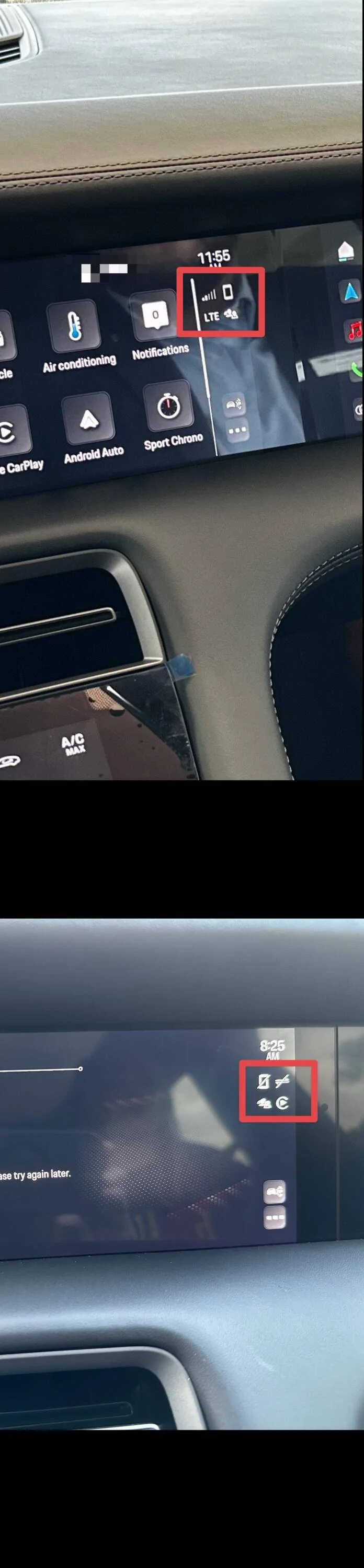

my car recently stopped updating the servers. it basically has no data connection anymore.
Porsche Taycan [SOLVED 09.07.2022, Europe] Porsche Connect Network Problems [3rd UPDATE!] CleanShot 2022-10-13 at 14.10.08
the icons on the dash seem to indicate it lost its ability to use the LTE modem - before on top, after on the bottom.
Yep, dropped off the network. Obvious question would be, how is your cell connection from the same location (no WiFi)?

its dead everywhere. those symbols with cross-through are always there now, no matter where i am. i've tried rebooting, no dice.
Ok so most likely a hardware issue and the Comms module needs replacing.
