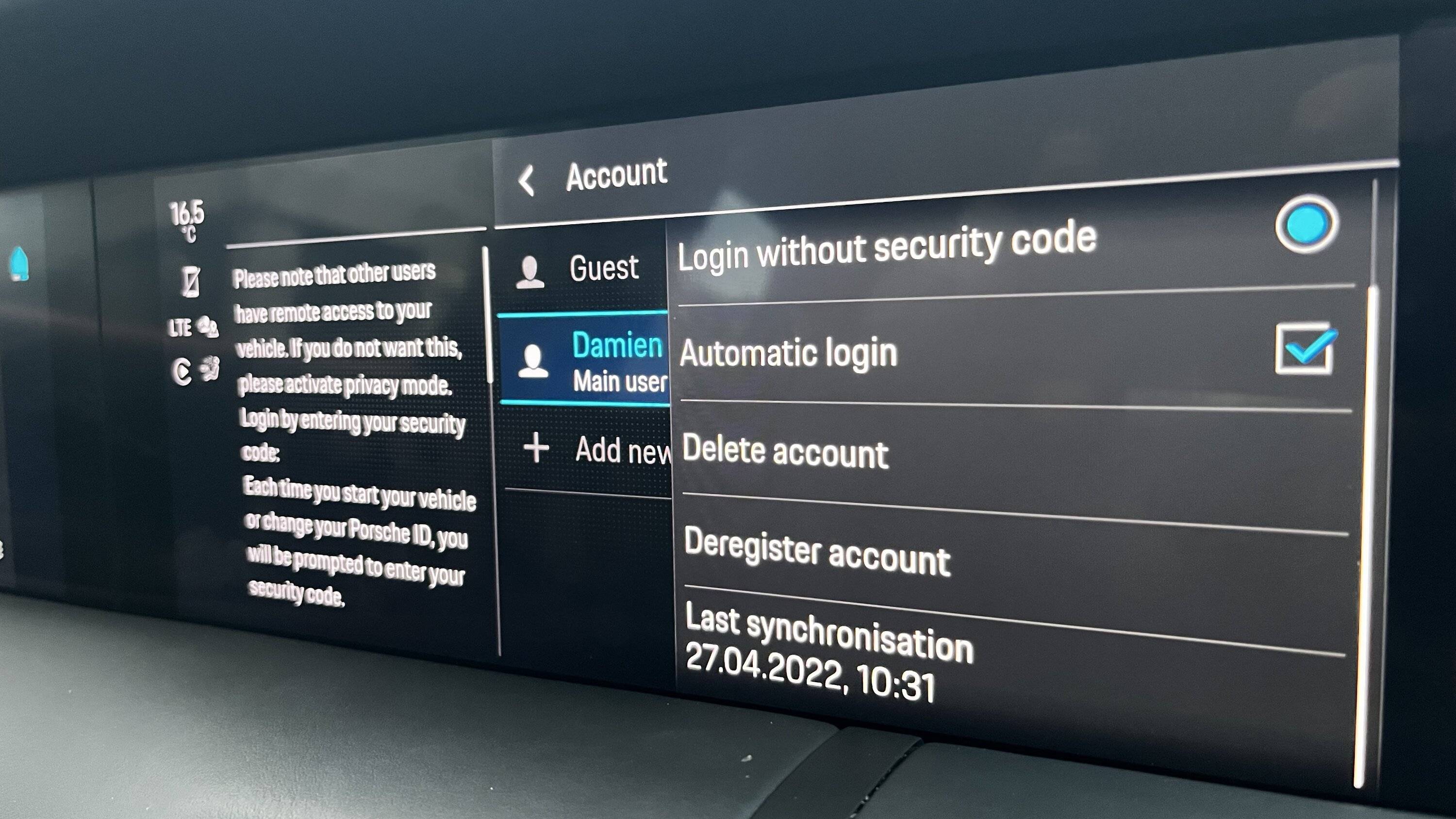

can you guys do me a favour: and check the date of the last synchronization of PCM with the backend?
Porsche Taycan [SOLVED 09.07.2022, Europe] Porsche Connect Network Problems [3rd UPDATE!] IMG_2865
Everything else – data wise – seems to be working okay (nav, sending commands to car, sending routes, weather, traffic, apple music, etc).
rs38
Nov 16, 2020
703
762
Düsseldorf
Taycan,GT2,i8,Tesla
my best guess is, this timestamp is reflecting the last sync with the old backend and the PCM client isn't able to update that part because the name has changed :)
