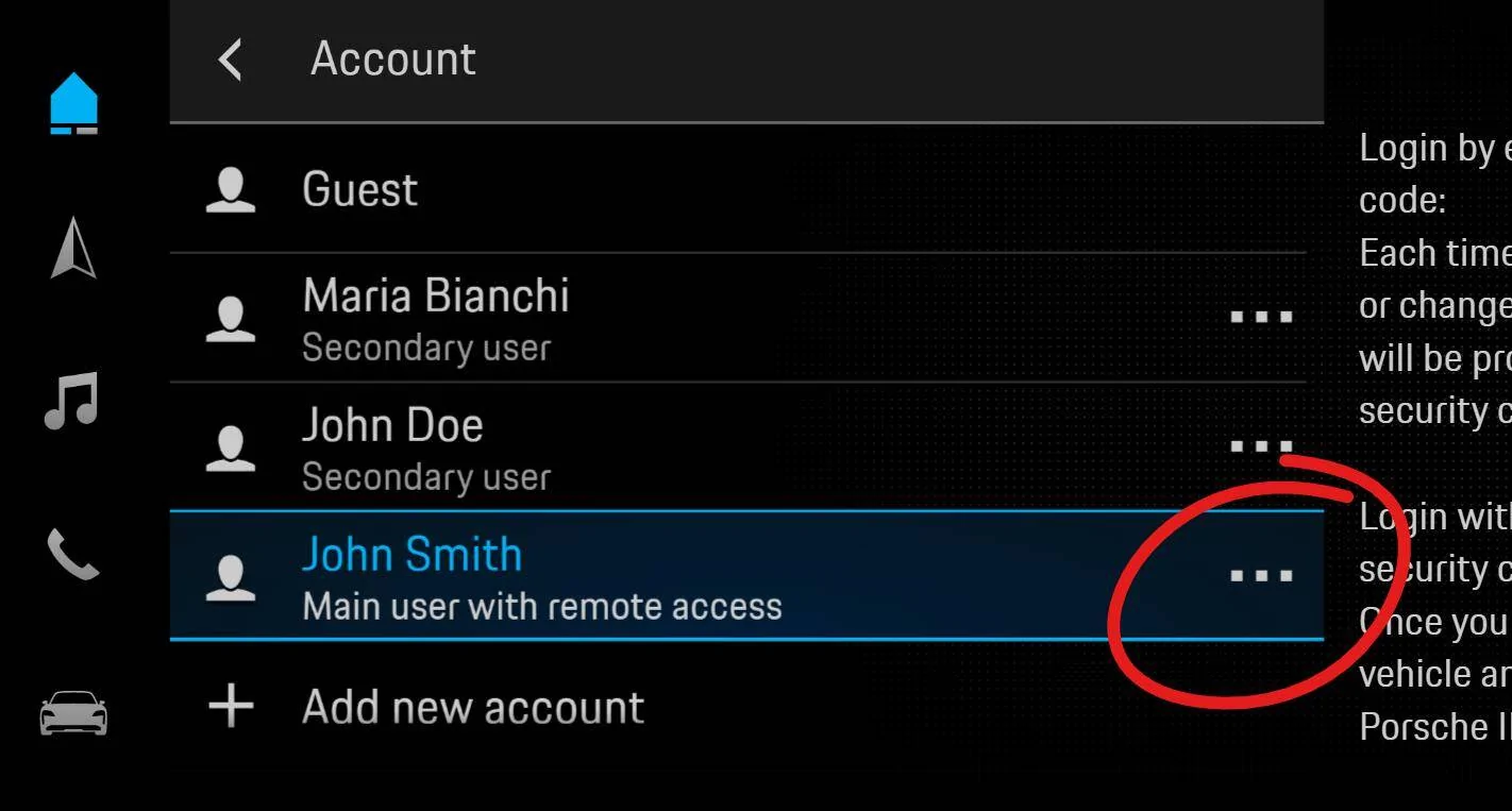

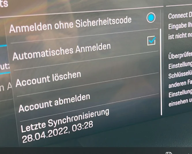

can you guys do me a favour: and check the date of the last synchronization of PCM with the backend?
Porsche Taycan [SOLVED 09.07.2022, Europe] Porsche Connect Network Problems [3rd UPDATE!] 1657440274814
you find this info slightly hidden in the accounts menu:
Porsche Taycan [SOLVED 09.07.2022, Europe] Porsche Connect Network Problems [3rd UPDATE!] 1657440398837
then you need to scroll down to see the timestamp.
my last sync is out dated and showing the days of backend migration.
What date is your cars show? pls only date and MY, no pic :)
3,904
3,549
Mine shows 02.06.2022 09.30.
MY2020
But surely that is wrong since I have much more recent info on MyPorsche account. Trips and charge levels etc.
