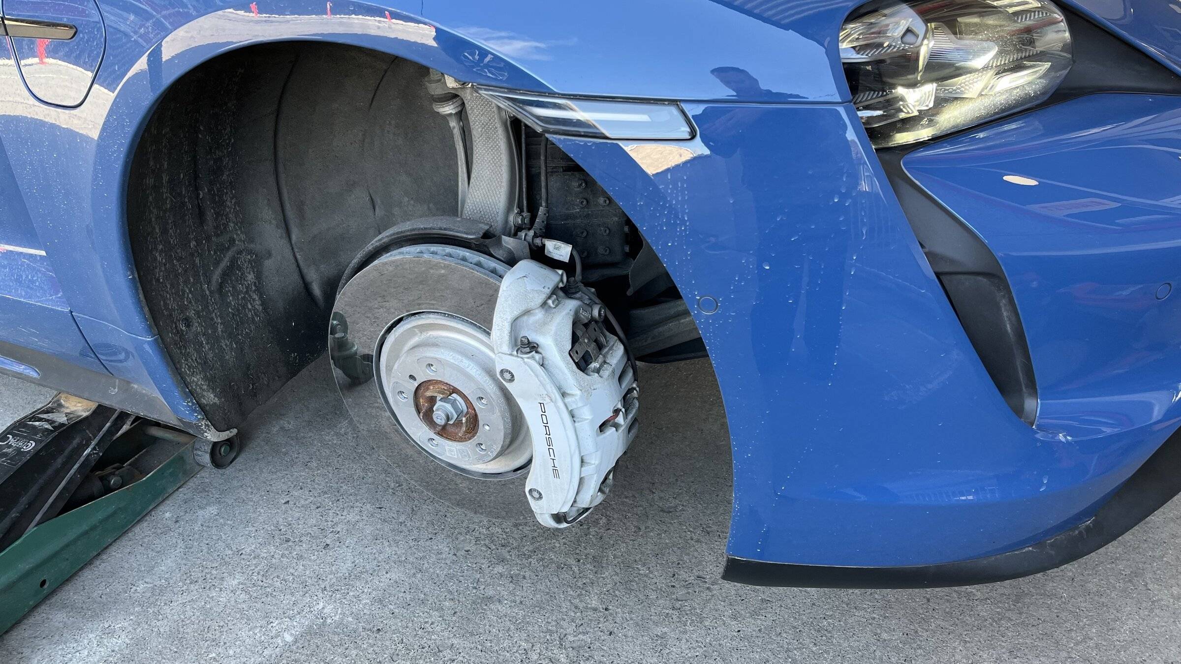

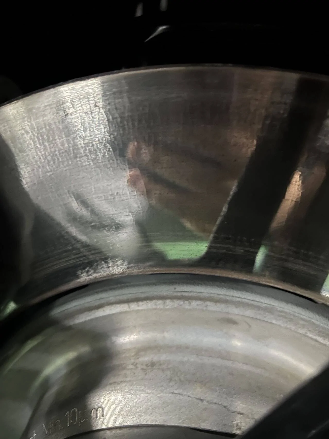

I have driven my taycan 4s for 12,000 km.At 10,000km, everything was fine with the brakes.Then I went to a track day event,Drove my car intensely for 15 minutes,the annoying thing appeared.First of all, the coating of the brake discs cracked, then the feeling of the brakes changed from before,The worst part is a rustling sound.
Mirror effect of PSCB was gone,a lot of lines like quenching appeared(all four of them).
Porsche Taycan Some questions about PSCB——Noise and  Surface coating cracks _20220504004734
I thought it was just a temporary symptom and drove on for 2000km,The symptoms are not relieved and even I now hear a rustling sound when driving at low speed in a quiet car without using the brakes.Of course, the coating still has many cracks, as if it lose effectiveness.
I returned the car to the aftermarket center and got a reply that this is a normal situation? but I always felt that it was unreasonable.Can an electric sports car from Porsche cause thousands of dollars of optional damage after just under 15 minutes of driving on a low-speed track?
Are there any guy who have the same problem as me?I've uploaded the pictures and the video of noise in the attachment, thanks you can check it.

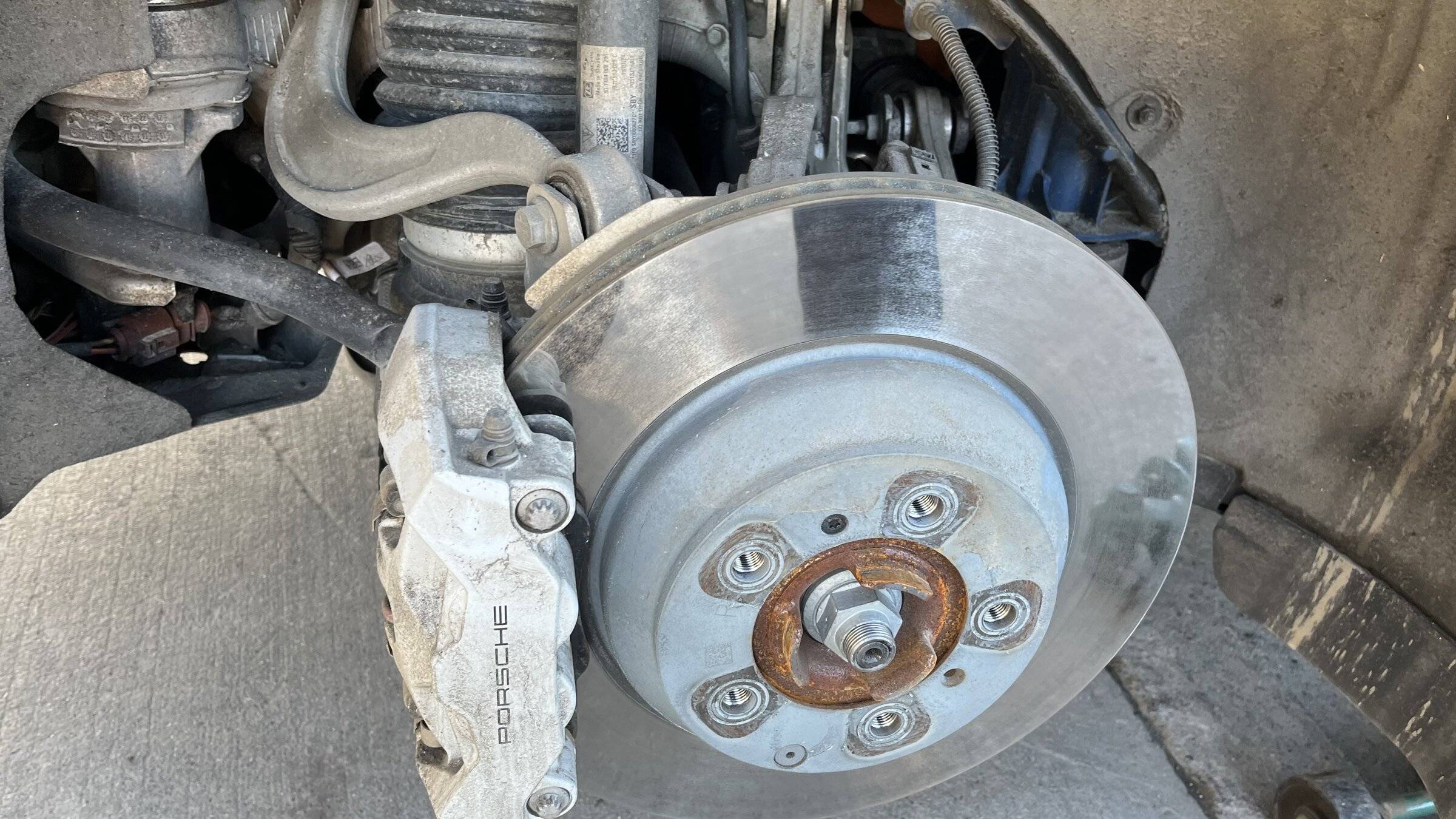

For reference, these are my PSCB's at 35,000km with zero track use. Did do around 1000km of high-speed autobahn driving over a year.
Porsche Taycan Some questions about PSCB——Noise and  Surface coating cracks IMG_9874
Porsche Taycan Some questions about PSCB——Noise and  Surface coating cracks IMG_9878

The surface finish in both photos look similar to me. The 2nd set of photos are helpful in understanding the level of brake dust.
