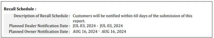

750
4,505
3,676
Thanks Tooney. Wonder when dealers will start getting replacement brake hoses and start implementing fixes of the cars on their lots that are impacted. Hopefully before August 16…
Not sure when, but Porsche and dealers are probably highly interested in the yet-to-be collected revenue from new cars held on lots with this stop sale.
Your stop sale report beat NHTSA website and the press. Thanks!
