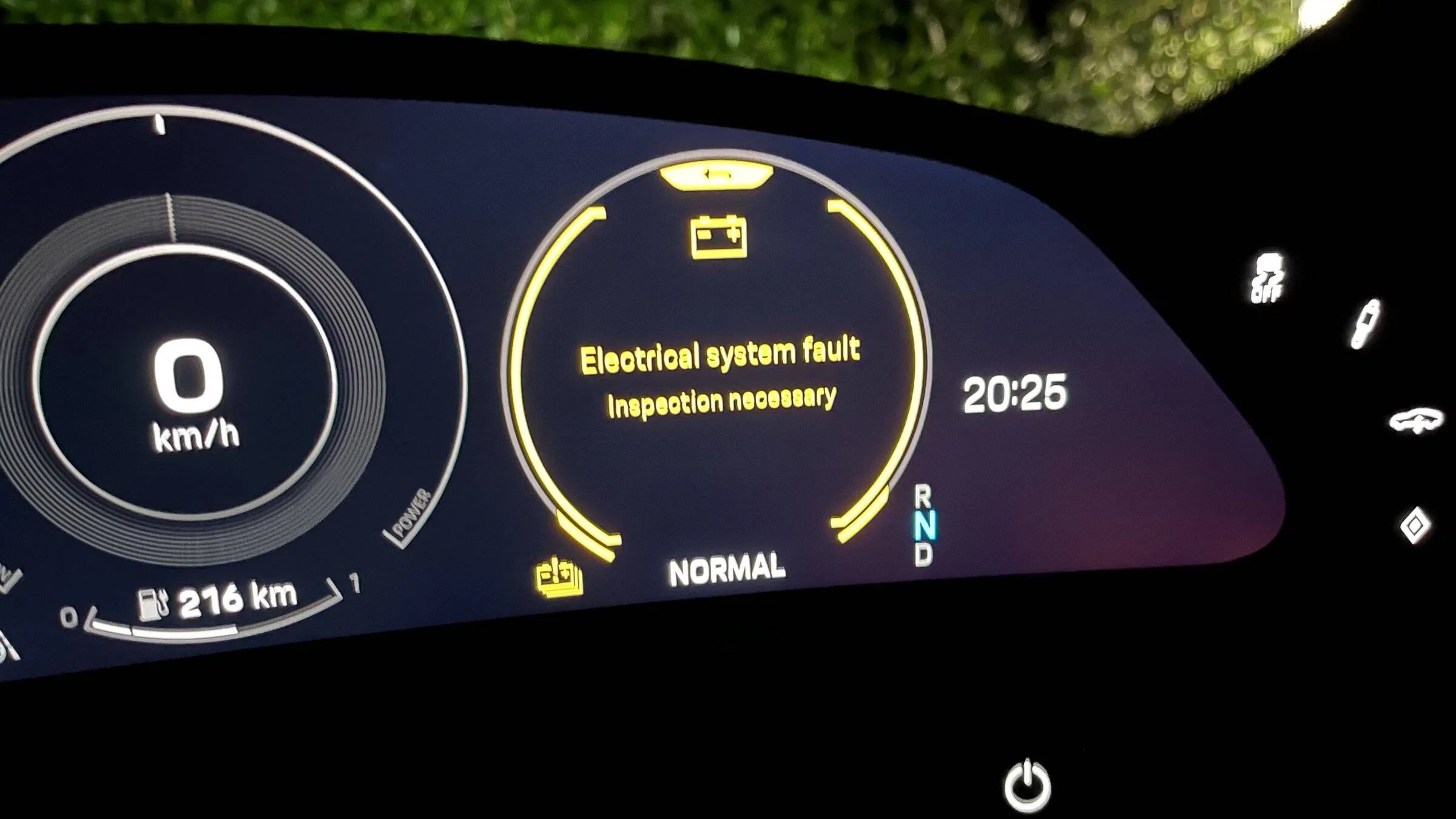

Spending weekend in Lake District, UK. Plugged into hotel destination charger - which worked fine yesterday.
Today it charged at 22kW for about an hour and then got a charging error.
When I went out the charger was dead. Car showing this error and refusing to go into any gear or move.
Any ideas?
Hmm. I just got that. Car was on charge at 25amp/6kw like it normally is. I have the 22kw thingy.
Left it unplugged for an hour or so and the error message has disappeared. i took it for a 20 second drive. Have put it back on charge again and seems to be doing so normally.

Hi,
Was your car on charge each time your 22kw charger packed up? Or has it randomly failed after charging sometime and caused a problem during an outing?

Hi,
ta.
It actually failed on a 22kW destination charger at a hotel – that was supplying me with 20kW power. I also used it the previous day to charge with no issues!
I also used reduced 6kW 1-phase charging at home for past year – since that MY22 configuration notice came out (my car is a MY21).
However, I did charge a few days previously at Chester Zoo car park at 7.2 kW 1-phase.
When I got your yellow warning - the car wouldn't go into gear (only neutral and park).

Let me answer your question better:
First failure: At home on 7.2 kW 1-phase charger supplying 7.2 kW (well before any hint of a configuration warning was published). Impact: Car drove fine. AC charging failed. DC charging fine.
Second failure: At hotel on 7.2 kW 1-phase charger supplying 7.2 kW (well before any hint of a configuration warning was published). Impact: Car drove fine. AC charging failed. This time DC charging also failed. I did drive to a IONITY in the hopes it would be the same as the first failure and I could charge and get home. Car had to be flat bedded to dealer as not enough charge to get home.
Third failure: At 22kW 3-phase charger supplying 20 kW. Impact: Car refused to move or AC charge. No clue if it could DC charge as couldn't move to one.
Third failure: At 22kW 3-phase charger supplying 20 kW. Impact: Care refused to move or AC charge. No clue if it could DC charge as couldn't move to one.
Thank you. Mine would still drive. Then I carried on charging on AC and warning sign not reappeared. Hopefully just a glitch/totally unrelated - i imagine that warning covers a multitude of sins.
Any ideas?
I had exactly the same issue - bricked car. Porsche Recovery (provided by AA in UK) sent technician out. He “reset” the car by disconnecting and then reconnecting the 12V battery. This enabled the car to be put into Drive and for him to drive the car to Porsche dealership to have the problem fixed (hopefully)
