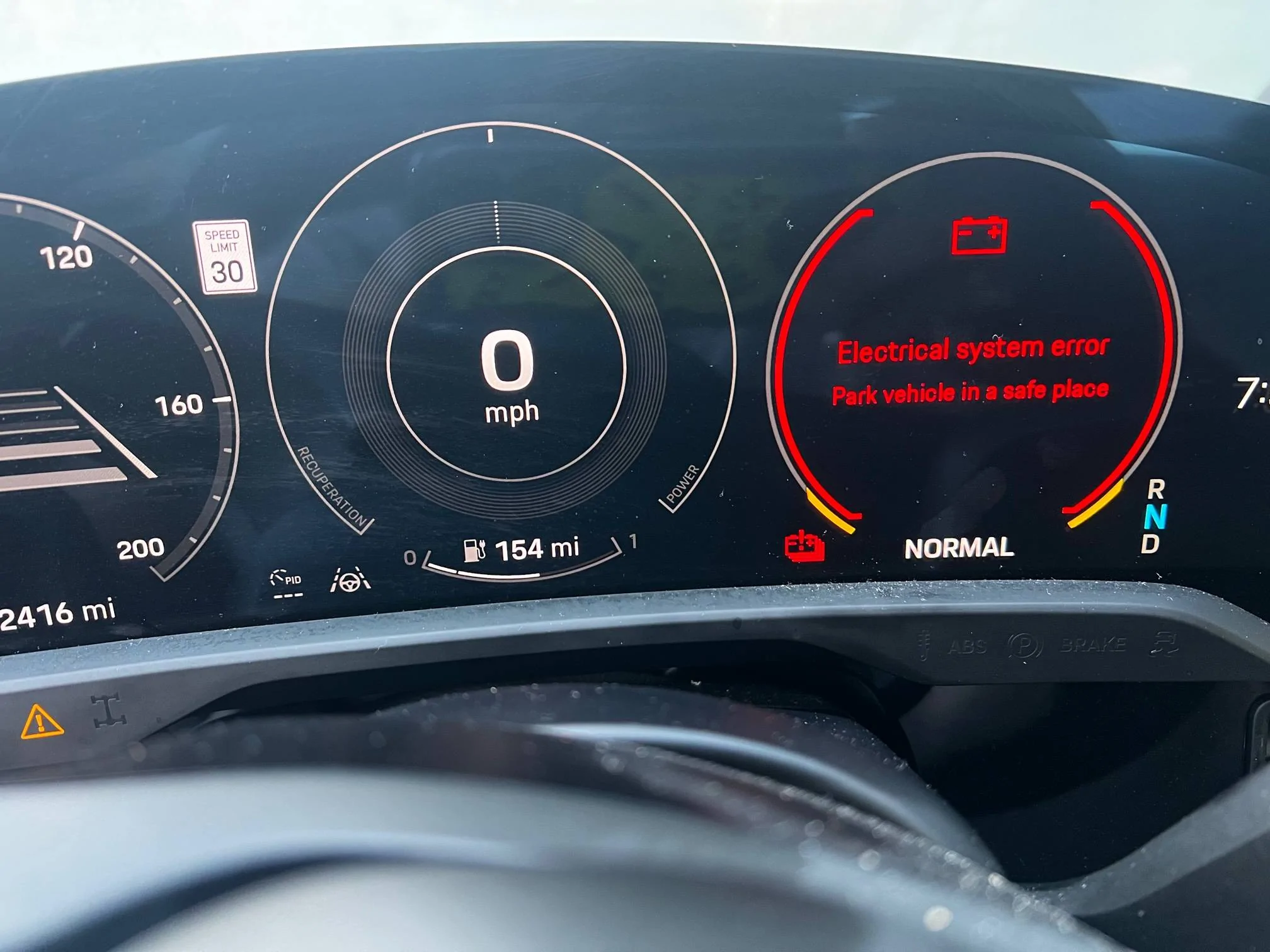

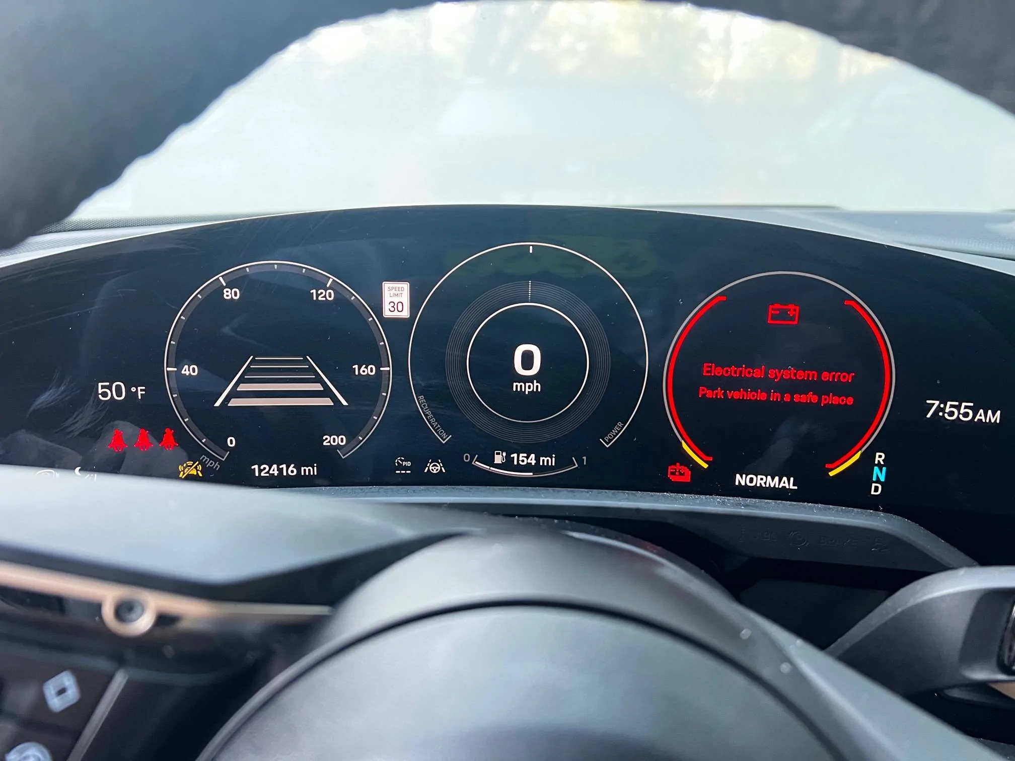

so this happened to me today, how best to proceed. hook up a batter charger to it? ( its seems to have power) or get it towed to dealer? I cannot even move it

Is it refusing to go from neutral to drive/reverse? Do you have the optional 22kW (or equivalent) AC charger?
Firstly, I would try locking the car – waling away from 15 mins or so – and trying again – see if a car sleep/wake cycle improves it.
Just a qualifier - we had this happen once in the lifetime of the car (we know def to do with a one time adapter attachment issue, another story) but we also tried a ca 15 min wait and that did not work - so we locked and left it again but this time for a full 40 mins (possibly 45mins) and that DID work! Started up as normal not a single issue since, 1000 miles later.
Now this is not a solve all i.e. this error springs up for a host of reasons however I would def advise a min. of 40 minutes locked before reattempting to restart - my 2c!
