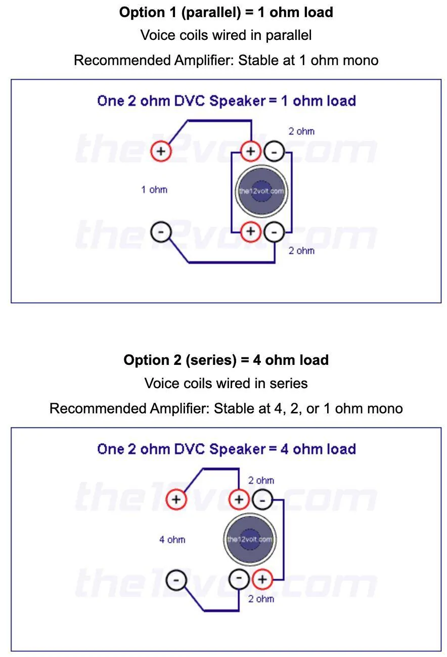

I bought the p3sd2-8 and wired it like the picture on the right as well as the picture on the left. It was my understanding that the p3sd2-8 was already a 2 ohm speaker. What would be the reason for going with the 4-8 version? I'm def. not an expert on this.
My understanding, and I am not the expert, is that the 2-8 version wired like the left side picture will give you a 1 Ohm load. Wire it like the right side, and you get a 4 Ohm load.
If you get the 4-8 version, you get either a 2 Ohm or 8 ohm load based on the left/right side picture wiring.

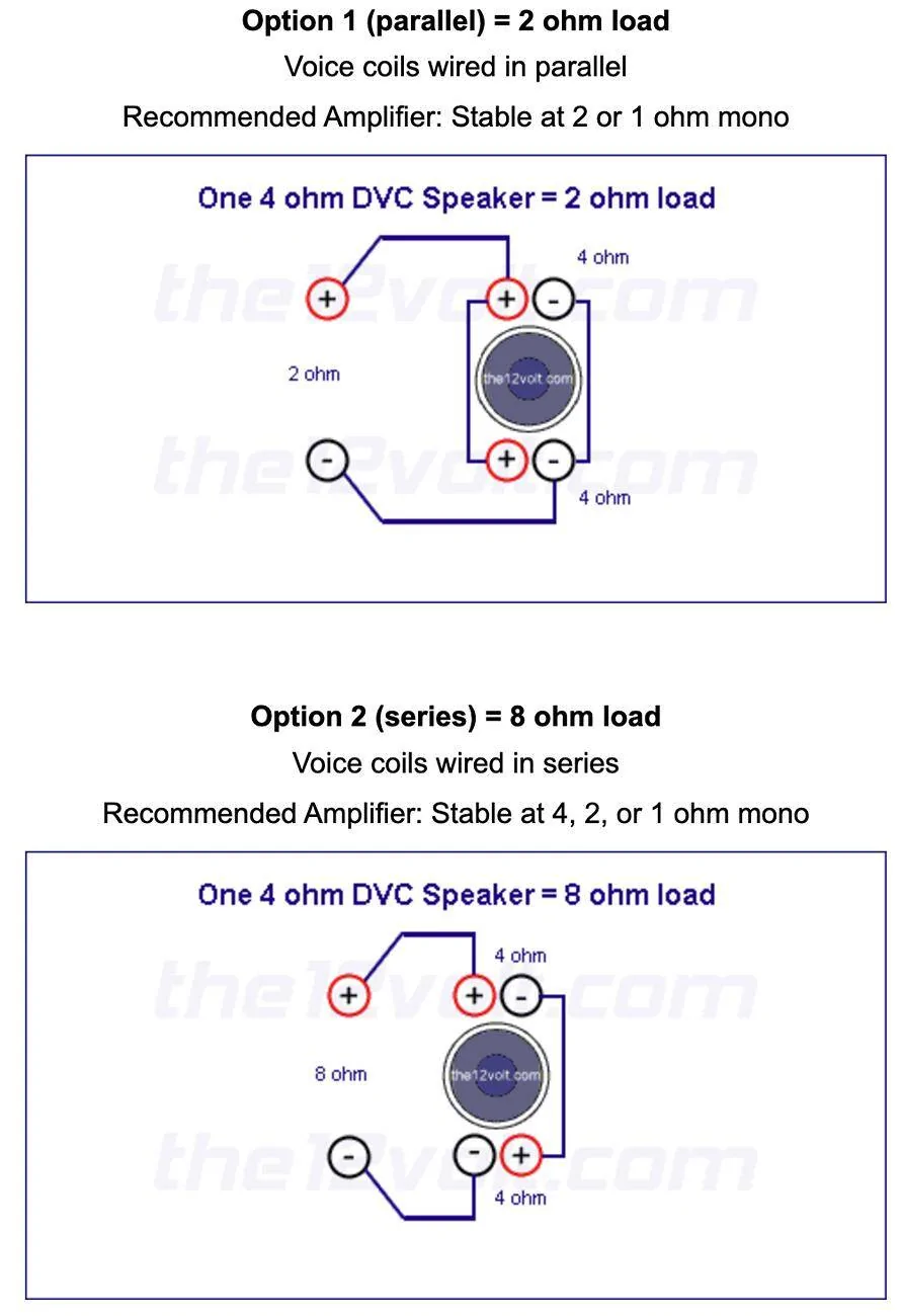

Here's a guide from another brand showing single speaker wiring options for a sub with dual 4 Ohm voice coils (which is just iike what the p3sd4-8 is). Same 2 / 8 Ohm load results, depending on parallel/series wiring method.

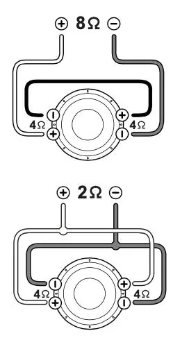

If you are wiring both of the 2 ohm voice coils of the P3SD2-8, which is a must, you have to wire them together in series, or in parallel. If you wire the two coils in series, you end up doubling the impedence/ohms to 4. If you wire them in parallel, you end up halving the impedence/ohms to 1. There is no way to wire up the dual voice coils of the P3SD2-8 in series, or in parallel, and have a net 2 ohm load.
That's why you need the P3SD4-8, which has dual 4 ohm voice coils. Wire those two voice coils in series, and you get an 8 ohm load. However, wire them in parallel and you get the desired 2 ohm load.

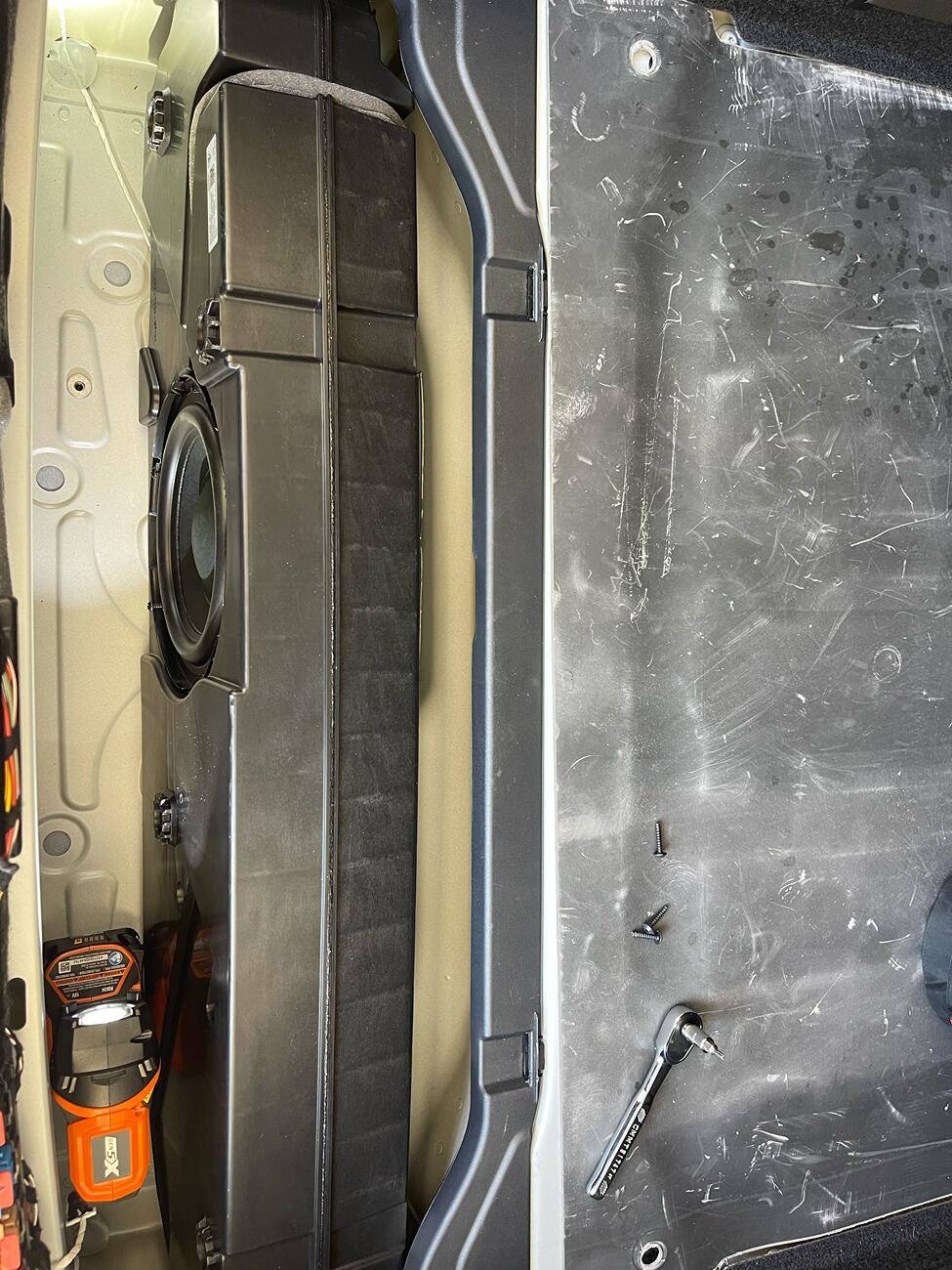

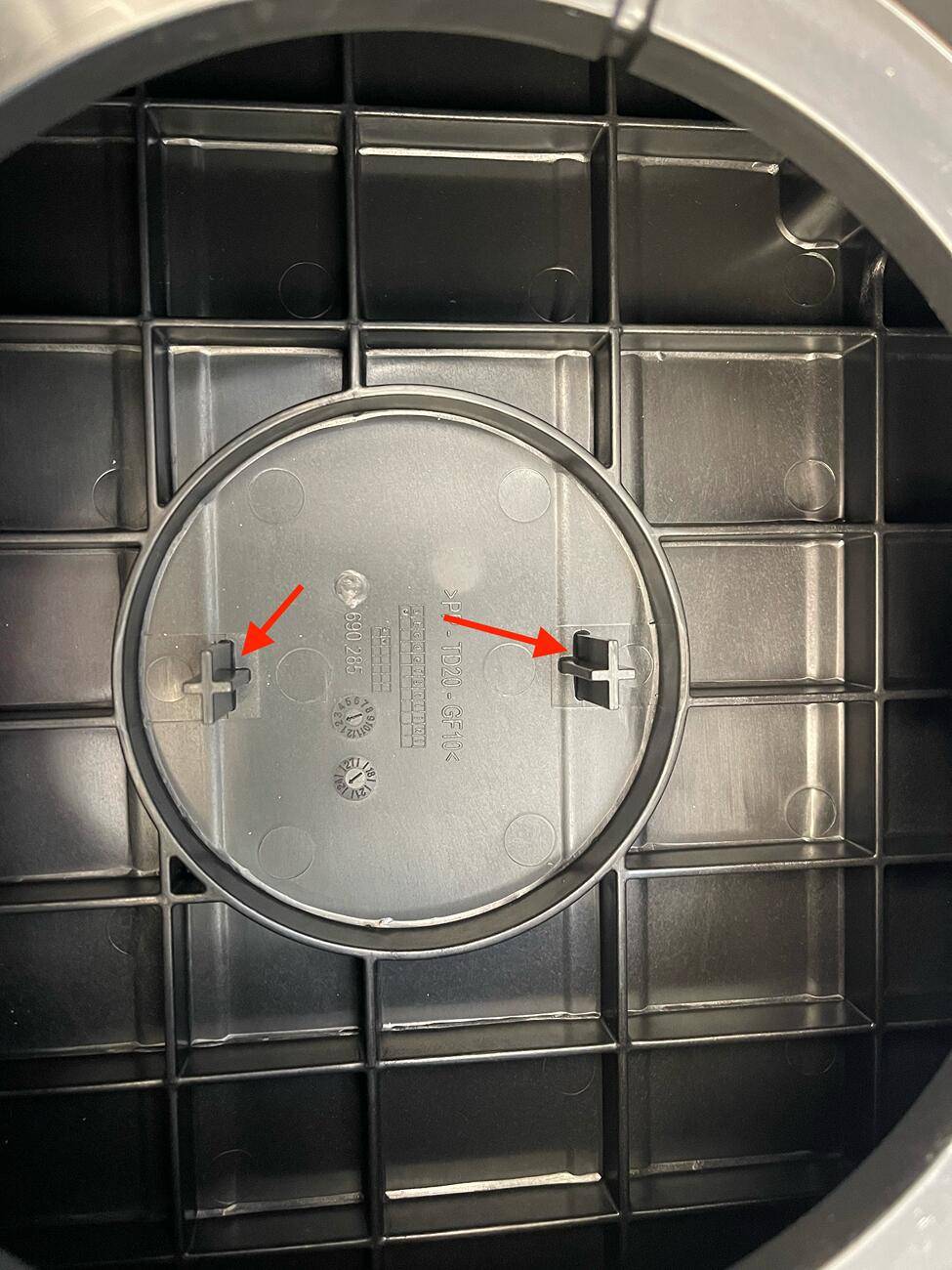

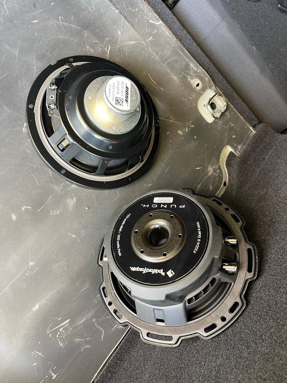

Did this upgrade today. I didn't want to remove the left and right interior panels for fear of breaking clips.. I man handled the enclosure and flipped it 180 degree and installed the Rockford Fosgate P3SD4-8. The picture below shows the box flipped 90 degree.. but It was impossible to mount the new speaker this way, so I flipped it another 90 degrees. You have to trim the mounting surface and remove 2 tabs (red arrow) inside the enclosure. The new driver does indeed hit a little deeper, and it sounds more controlled. It does seem a bit louder.. but not as loud or hard hitting as my Jeep with dual 10's JL and a dedicated 500 watt JL amp ;) Look at that tiny Bose magnet. I dont think a dedicated aftermarket amp would make the 8" sub much louder. so for now I'm happy.

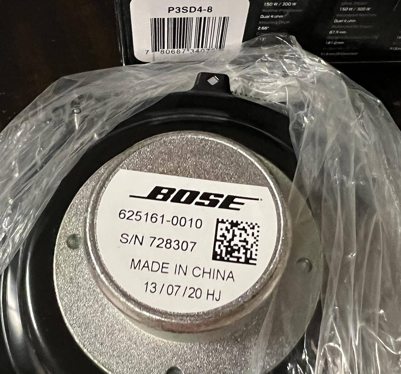

Thank you for posting those instructions and pictures. I can confirm that your Bose subwoofer is the same speaker that I had in my 2021 Macan. Definitely good to use the P3SD4-8 wired for 2 ohms.

Alright, I did this upgrade with the 4 ohm speaker wired to 2 over the weekend. Unlike the 2 ohm speaker it doesn't sound worse. I agree with theblksurfwagon . It sounds more full, and deeper, a subtle upgrade. I'm sure it will continue to sound better as it breaks in. Worth the upgrade cost? That depends. The swap out takes around 30 min if you don't pull the box and rotate, and the cost is around $170. So cost and difficulty are low but so is the return. Best way I could describe the improvement is like getting an extra 1-3 steps on your bass adjustment. Like being able to move it to 11 instead of tapping out at 9. For me, improves it enough I don't think I need to pursue any more difficult/expensive options. But if you really want to feel the bass, you're going to need to do something else.
