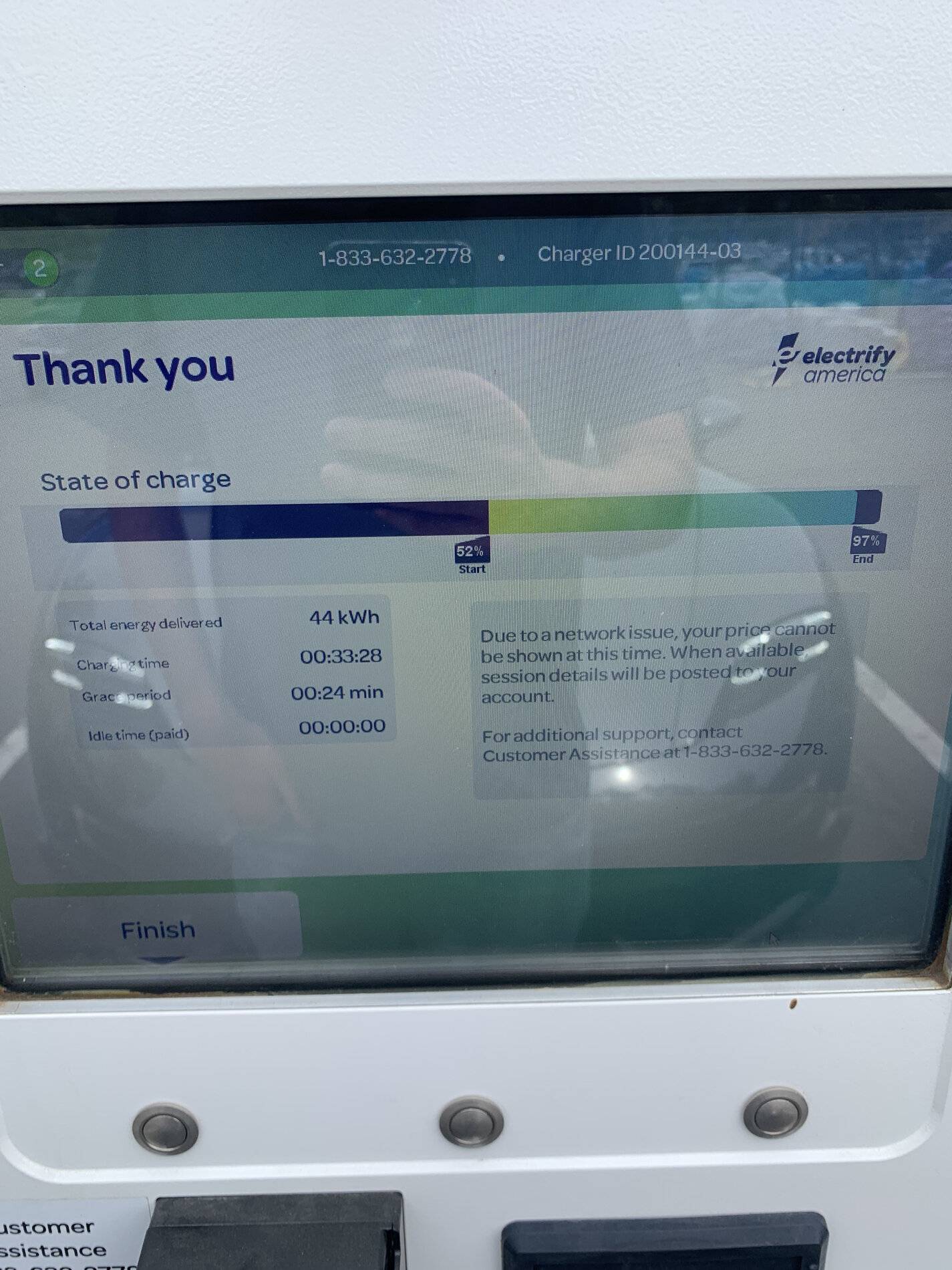

At this specific 150kW charger:
200144-03
150kW
Walmart @
3382 Murphy Canyon Rd.
San Diego, CA. 92123
I plugged in and immediately got "Initializing Charge...", the green charge light on the car, and a zero-cost charge to 97% at which point I manually hit Stop on the terminal.
This is despite the presence of the corrupt 19.2kW on-board charging option. Does this mean that....
  • A recent OTA update fixed the problem?
  • My vehicle, built 4.30.2021, shipped with a valid digital certificate?
  • There was an error with the charger. It's just giving out free charges to all comers despite quoting a specific per-kWh $ amount on the screen?
Other points of interest:
  • Nothing shows up in the Charging app's history for this particular charge
  • Nothing shows up in the Electrify America app's history for this particular charge
  • No payments hit any of my credit cards for this charge
  • At no point did I use NFC in the phone to supply payment information to the terminal. It "just worked."

You just got a free session which happens once in a while at EA when they have problems. You can see that the station reports a network issue. You also crossed the 30min free limit and you were not charged either, yet another proof.
This was probably not plug and charge, it was just this station offering freebies to anyone. I bet if you plug in a 2020 Taycan or a Chevy Bolt or Bmw i3 they will also start charging without starting a session from the app.
Got it. Sucks, but nice to get a free charge. We'll see how long the glitch lasts.
