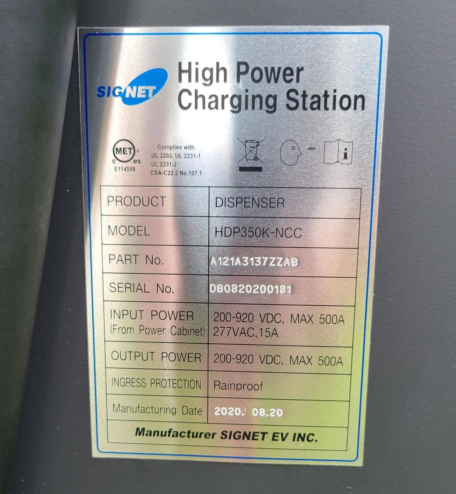

As it turns out, EA uses at least 3 different brands of charger hardware. One of the newer chargers is from Signet, and the root of the issue is that the CP duty cycle % from these chargers is higher than normal and thus considered out-of-range by the Taycan, which would in turn refuse to connect. (Some light reading on J1772 here)

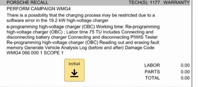

This is exciting news. Is there a campaign code or other reference for the software update? I received an update for the 19.2kW charger on 8/24-25. I’m trying to find the invoice for the code. Based on the timing I wonder if this is the update you’re referring to or something else.
Edit: WMG4
Edit: WMG4
Indeed! I don't see anything on my repair order, just a PRMS ticket # which I assume is specific to me. I've been told that if your dealer asks they will know which one. I will see if I can dig anything else up tomorrow...
I too received the WMG4 update in July and it had no impact, so probably not. You will see the P&C option if you have the fix.

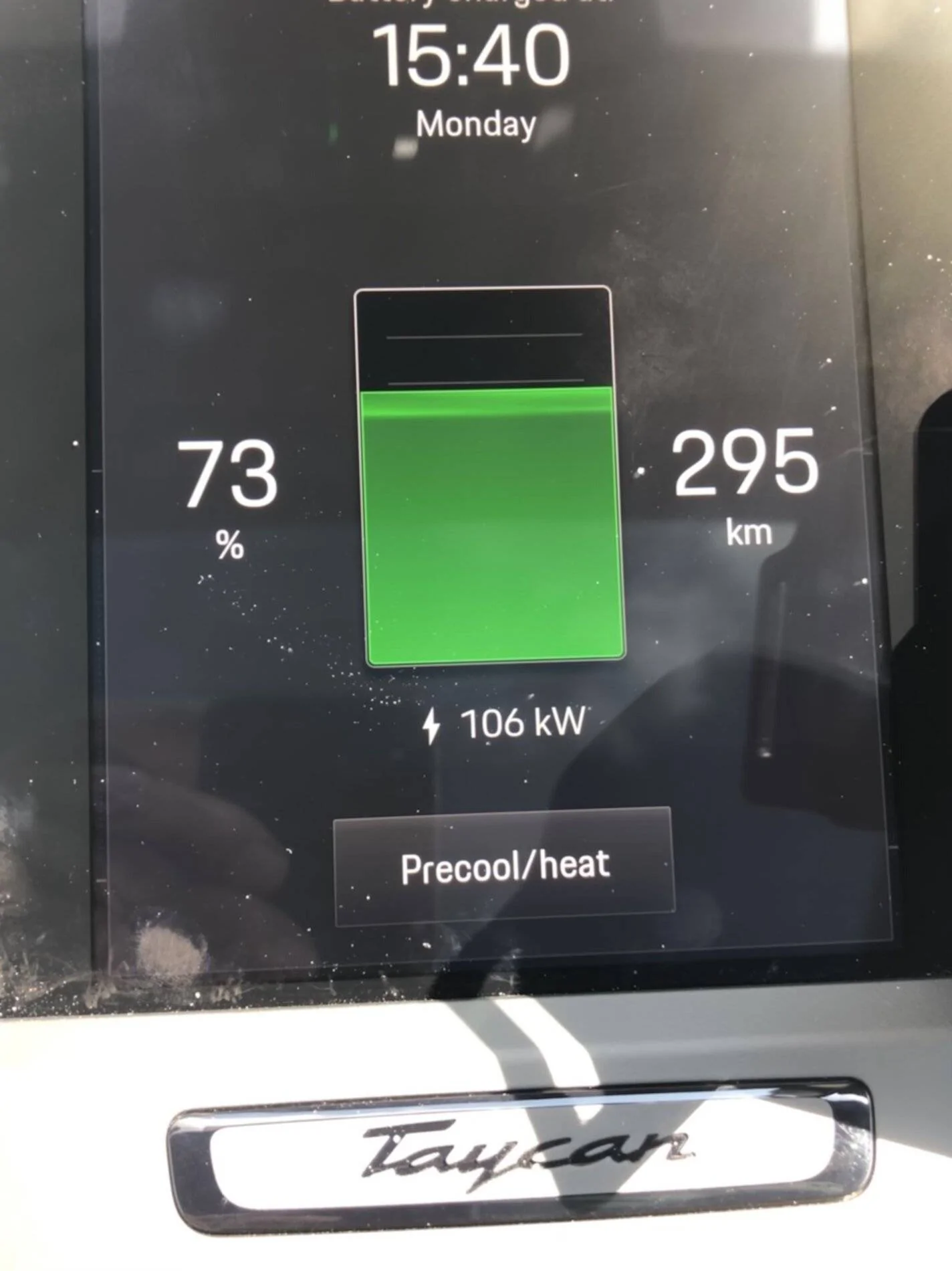

Well this is interesting - i have a MY21 T4S with PB+ and “normal” charger (not 19,2 kWh). When i got the car in january this year, the plug@charge worked perfectly, and all my sessions at IONITY (fast chargers i Europe) also worked great..
After the major software Update in april, my Plug@charge stopped working, and also experienced problems fast charging (Low Speed, session would quit after a minute etc)
Do anybody else experience something similar after software Update??

I have not had any problems or issues with HPC charging after the latest recall update. I have however a MY20 and never had P&C.
Here is a picture of a recent Ionity charging session. Very decent speed at the stage of charge, 73%!

Quite welcome! I do not have anything other than what I've already shared -- tell your dealer to ask PCNA technical for the new 19.2kW fix for EA Signet charging issues. It's all very fresh and so it hasn't run through their formal release process yet. That said, I know many like you have been struggling with this and so I wanted to share right away, after getting Porsche's blessing to do so.
EA Asheville is more intermittent -- even though I was unable to charge there, Porsche did have some success. Apparently the duty cycle % on some of the Signet chargers is borderline, and may be impacted by other factors like temperature. So it can work sometimes and not others. Personally I've had more success with the 150's than 350's. I haven't been to EA Statesville but you can tell if a charger is Signet by the silver label on the side:
I also have had more successful charges on 150 units. The signet issue is new to me, I will now note the brand of the chargers
