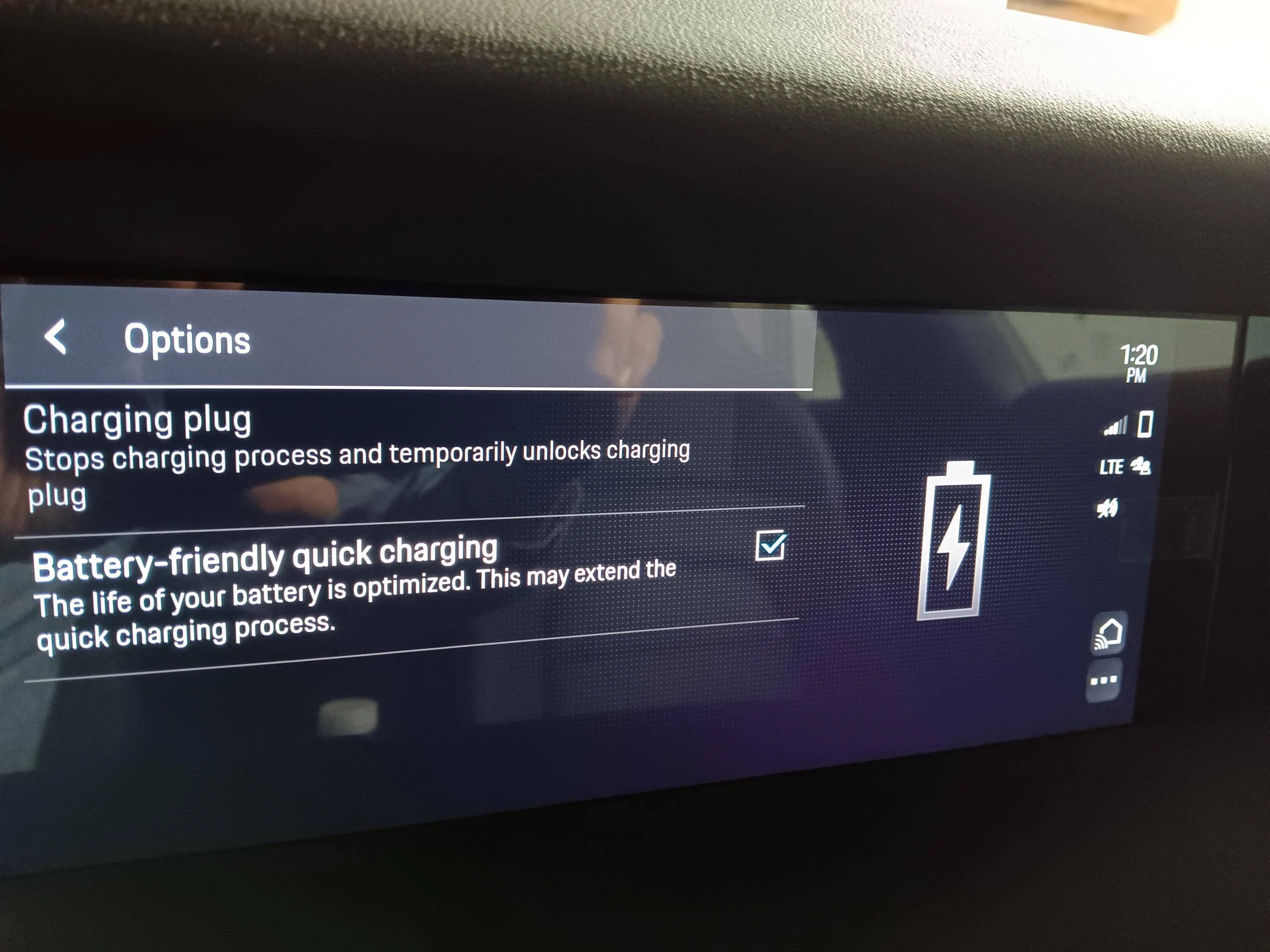

I was unable to use plug and charge at EA station today for my 22 4S. Fast charging worked ok with the Porsche app. Tried two separate dispensers at the EA site.
Got home and found that plug and charge is activated in PCM at:
Home...charging....overview....<3 dots>.
There is no Plug and Charge entry on that screen.
Edited: added picture of screen

Good question. Privacy is inactive. I charged at EA using Porsche app, so my Porsche charging service works. Plug and charge feature is not on the PCM menu. It used to be there.
788
4,705
3,813
I edited original post to add photo of my car's Home...charging...overview...<3 dots> screen.
