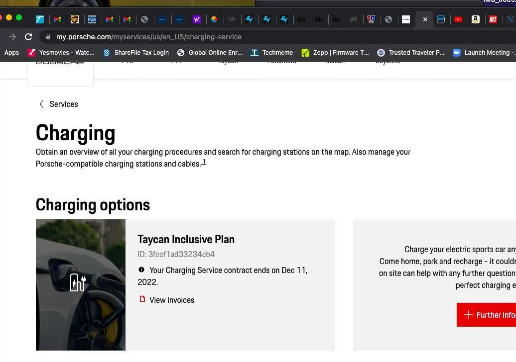

Did you go thru the order/credit card process on porsche.com? You need to do this first.

I have enabled it on porsche.com and it says my subscription is active. I also have it in my menu on my 2022 4S. I didn’t check the menu prior to activating the subscription unfortunately, so I don’t know if it was missing previously. However I can confirm I have the menu option on my 2022.

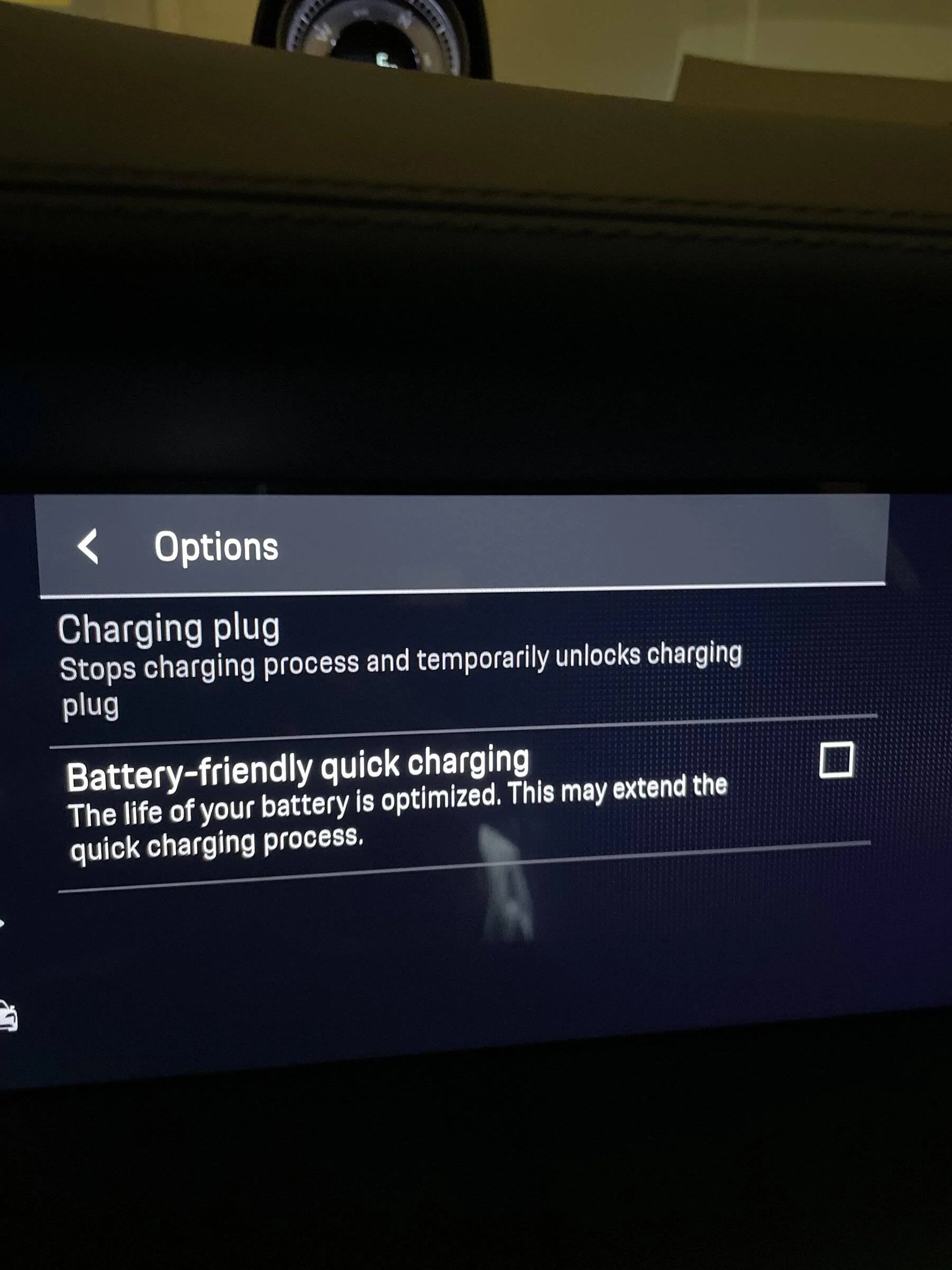

This is what I have..
Guess a trip to dealer is due.sigh

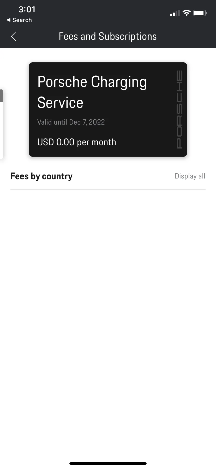

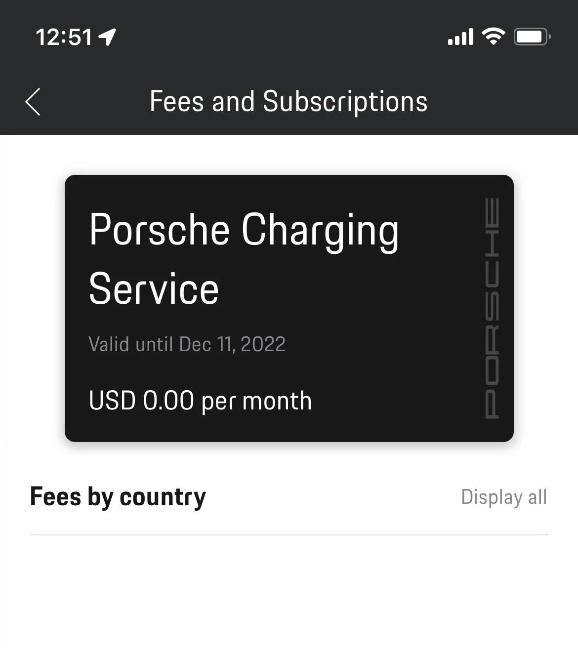

When you go in the Connect app, go to “My Account” then Subscription and Fees. Does it look like this?

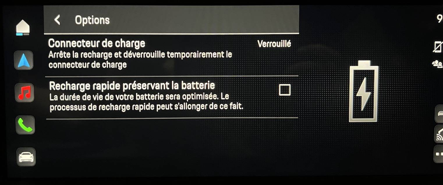

Thanks for the reply but we already have tested that and the plug & charge option doesn't appear...
In the PCM menu where this option should be, I have that:
Porsche Taycan MY22CT Plug and Charge Option missing? 315930089_503071381787775_5053233332548387977_n
My Porsche Center is talking with Porsche Germany but after 2 days, they have no solution about this problem...

Yes I did the two finger reset and my issue was resolved. Now for the past three weeks I am dealing with PCM integrated apple, Spotify and online radio function is not available, not working. Germany is looking into, still haven't heard a solution. Taking to dealer next Monday.
