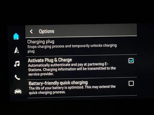

From main menu click Charging, then in the lower right hand corner click the three dots which will send you to the next screen where you activate Plug & Charge.
Porsche Taycan Plug and Charge Not Working IMG_0843
RPTRXV
105
Los Angeles
Audi Q7 / Taycan CT4 / Model X (ordered)
That was super helpful, thank you very much!
