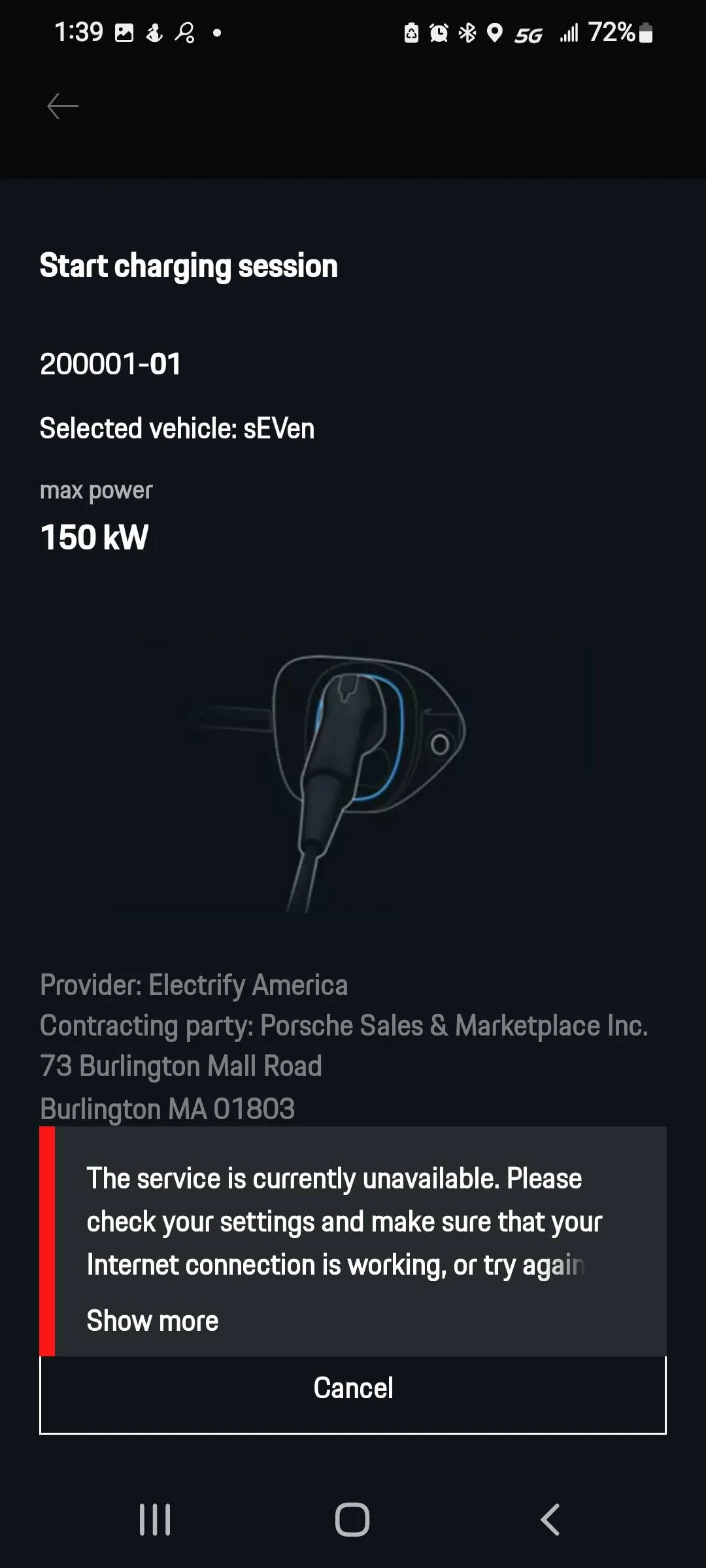

Don't suppose any of the other folks with Plug and Charge issues had that when they first got their cars? Just picked up my '22 Taycan 4S 9/1, added a credit card the my porsche account, the My Porsche App under Charging Service says "Charging Service valid. Ready for charging", and I have "Activate Plug and Charge" Selected from menu in the car. Just plugged in to EA station where PnC worked on my Mach E and it gave the dreaded "Payment Declined" message... Looks like I should be able to work around this using My Porsche app in the future (thanks, Hirschaj!) but that looks rather tedious...

Thanks for the input... Just tried it from the app and it can't initiate from there either... I think Porsche hasn't updated a database somewhere yet with my data...
Porsche Taycan Plug and Charge Not Working Screenshot_20220904-133954_My Porsch

Second try later with the app and it worked... First time the car was still plugged in, second time I started charging from the app before plugging in... Hopefully Porsche gets it's act together with updates and P&C!
Also seems this is an issue related to latest Porsche Software update and there is at least 1 workaround involving a sketchy app download :
https://www.taycanforum.com/forum/t...problem-after-update.12342/page-3#post-185033

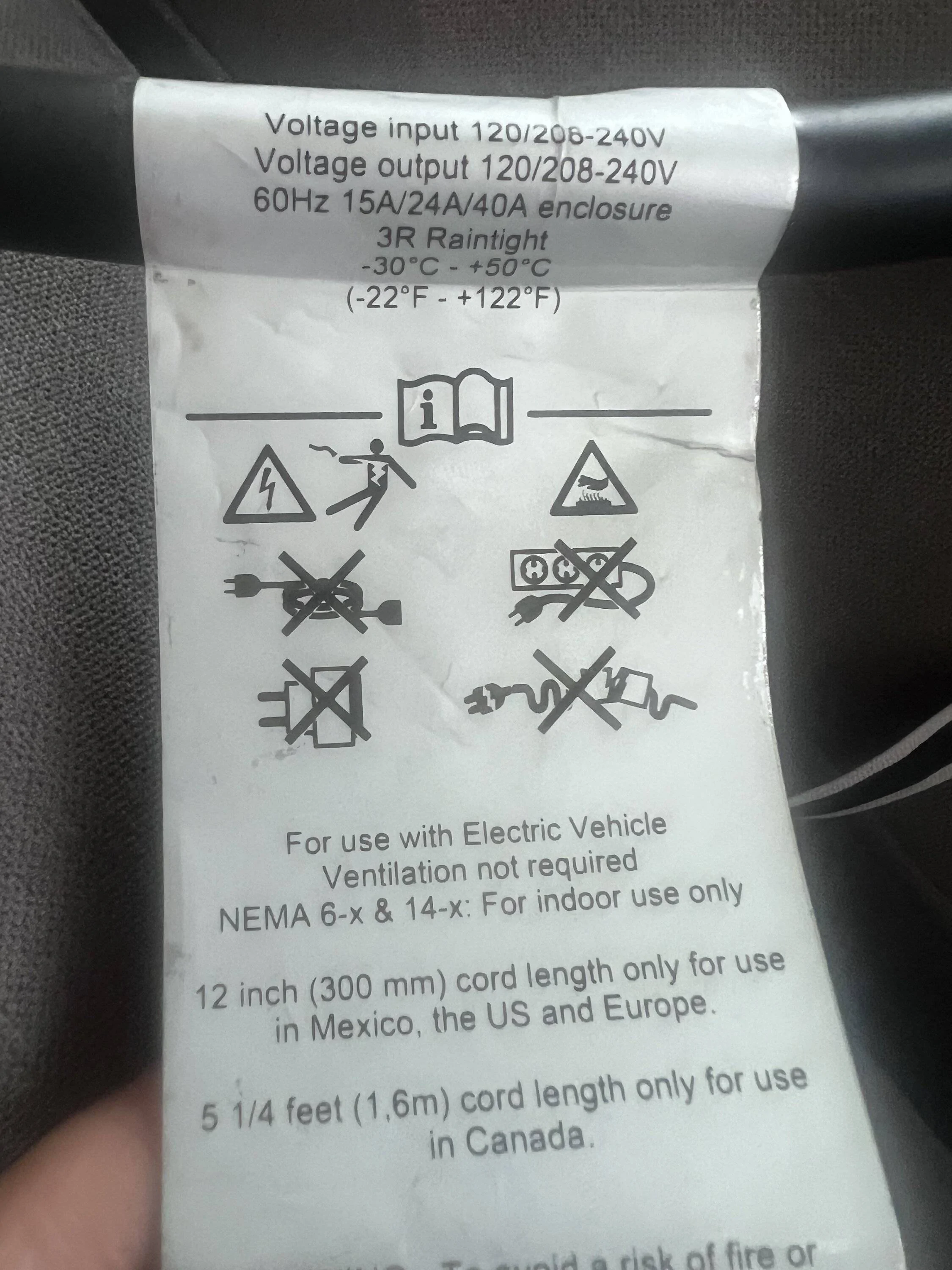

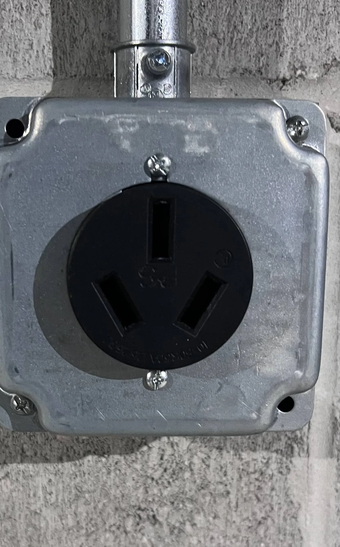

Hi I have question about charging plug. Porsche gave me a nema 14-50P plug and I have a 10-50 socket. Has anyone tried using converter? Is it safe to use a converter as charger has x (cross) sign on converter or extension.thanks
Porsche Taycan Plug and Charge Not Working IMG_1078

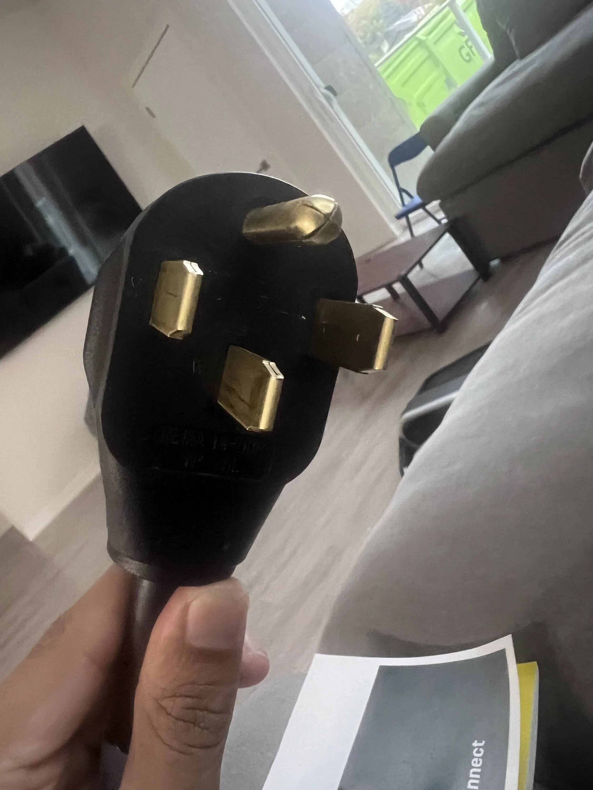

Jun 20, 2023
Porsche Taycan Plug and Charge Not Working IMG_1077
