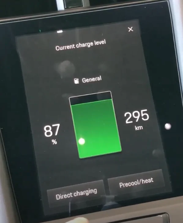

@SWORDER - is this battery configuration screen where the checkbox should be? Or, is it under CHARGING >> OVERVIEW >> . . . ?
go the the charging menu in settings then press the three dots at the bottom right. a new menu will come up with a click box
Go to the Charging screen from the Home page and click the three dots in the lower right corner. The following screen will appear:
Porsche Taycan 19.2kW charger fix for EA charging and Plug & Charge IMG_0329
You want to make sure that the Activate Plug & Charge checkbox is checked. If the option doesn't appear at all or is greyed out, making it inaccessible, it means the update/patch wasn't properly installed.
If it's accessible, check the box, and wait a few days. P&C should then work for you.
