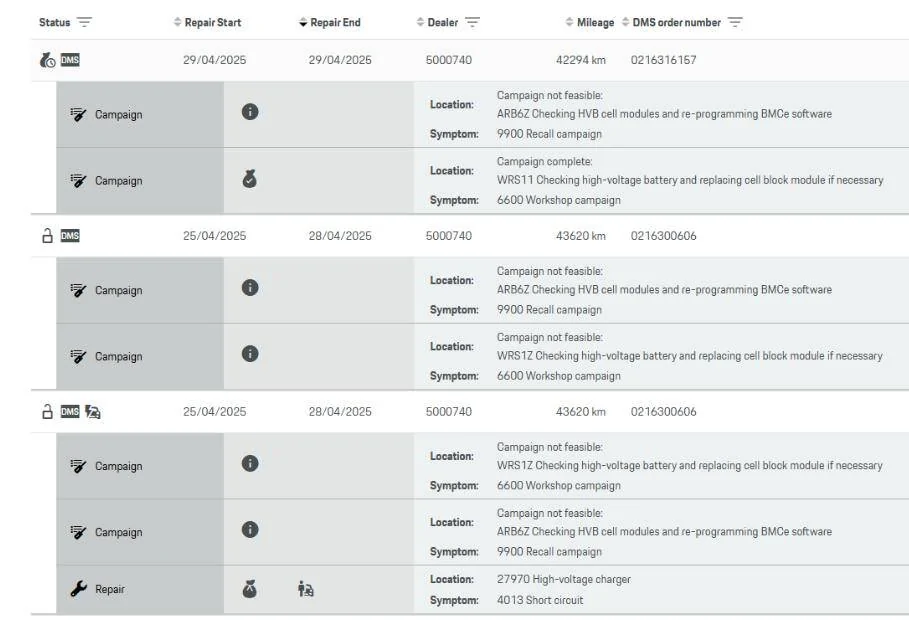

I picked up the car today. They replaced the OBC and checked the HV battery. The OBC charter was replaced, and sadly I do not have the part number but I asked again and was again told that this is an upgraded OBC. Apparently after this upgrade they didn't see any taycans fail again.
Porsche Taycan Taycan died on the highway... Screenshot 2025-04-30 at 17.38.26
