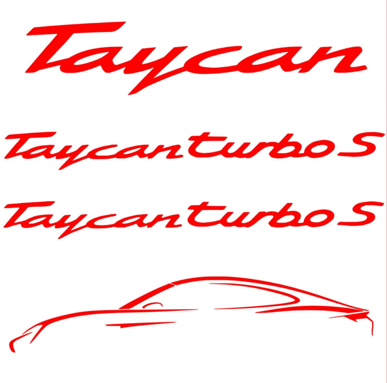

OK, here is an archive of DXF Cut Files. You can use these to make Wood Cutouts (CNC Router), Acrylic Cutouts (Laser Cutter), Vinyl Cutouts (Decals and T-Shirts), Metal Cutouts (Waterjet or CNC Plasma Cutter), Plastic Logos (3D Printer) and some other cool stuff I'm sure...
There are 4 DXF files in the archive (two of the "Taycan Turbo S" as they are a tiny bit different). Of course each of them is fully scalable (as they are vector format DXF).
...and of course you can combine them. (Like putting the Profile above your desired Name to make a custom T-Shirt!)
Have fun! All I request is that you please post photos of anything you make so we can all enjoy your projects!

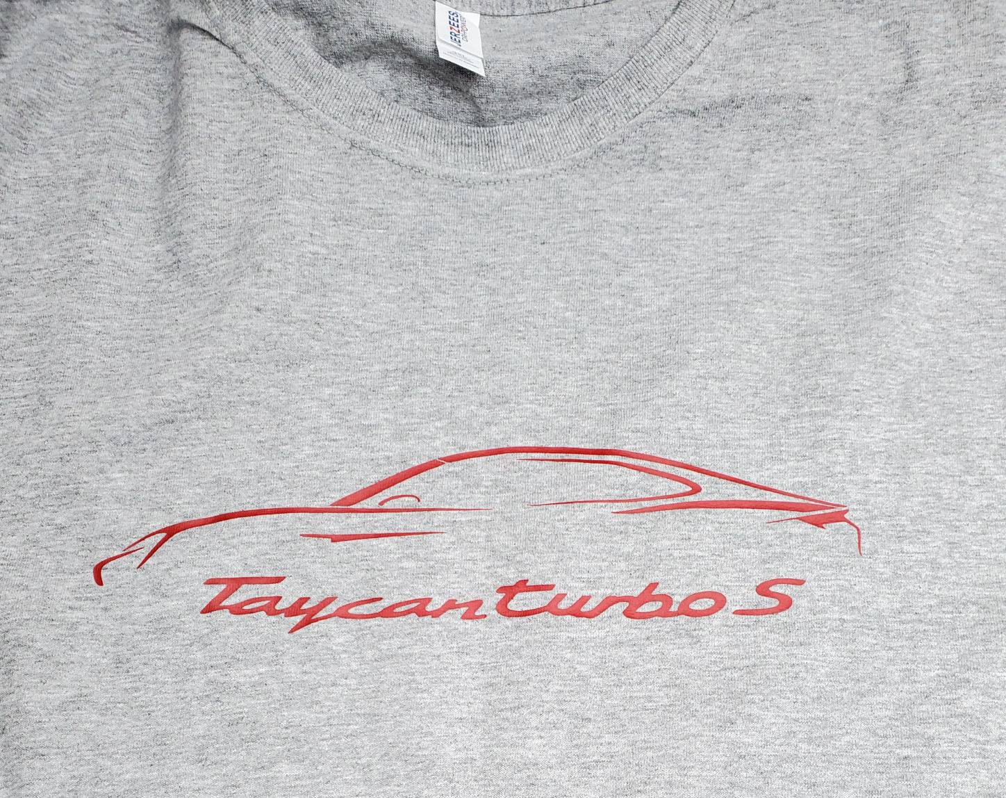

As a test, I just made a T-Shirt using two of the above files (My car is Red so...)
Porsche Taycan Taycan Font T-Shirt
Maybe next time I should make the profile a bit larger and leave it on the front ... while moving the name to the back of the shirt. That might be more "classy"... Hmm....

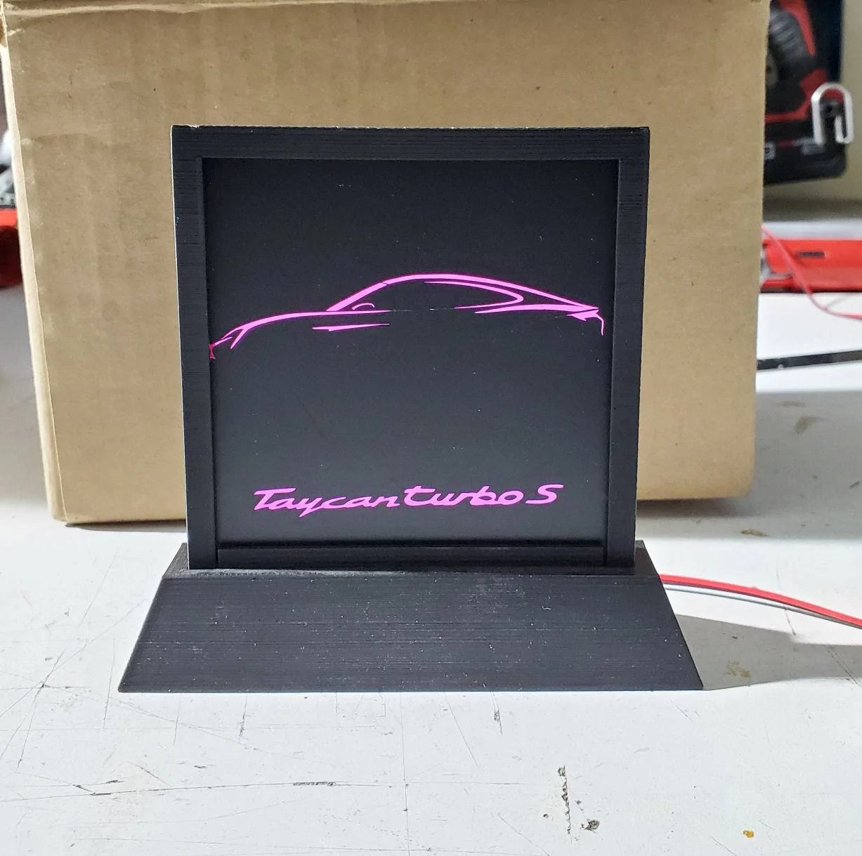

As a test case:
I went digging for some old 4"x4" (10cmx10cm) EL Panels I had in the attic. They are not very big, but should work as a proof of concept...
I laser cut some clear acrylic to match the EL panel size so I could stick the vinyl mask to the acrylic rather than the panel itself. (This way, I could simply swap out the masked acrylic panels like "slides" rather than committing the EL Panel to a single design...)
...and then put them into a 3D Printed desk stand I designed to hold them in a "frame"
Here is the "Taycan Turbo S" design in the holder, with a pink EL Panel behind it and the lights on so you can get a better view of the holder. The logo is pretty small here:

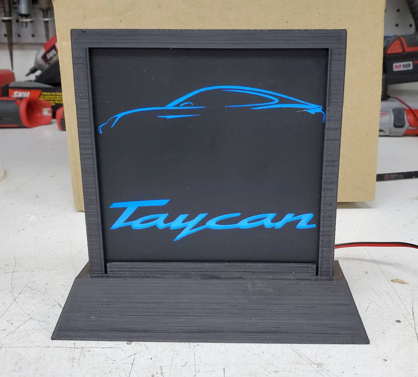

Here is the "Taycan" design with a blue EL panel in the same lighting:
Porsche Taycan Taycan Font 2

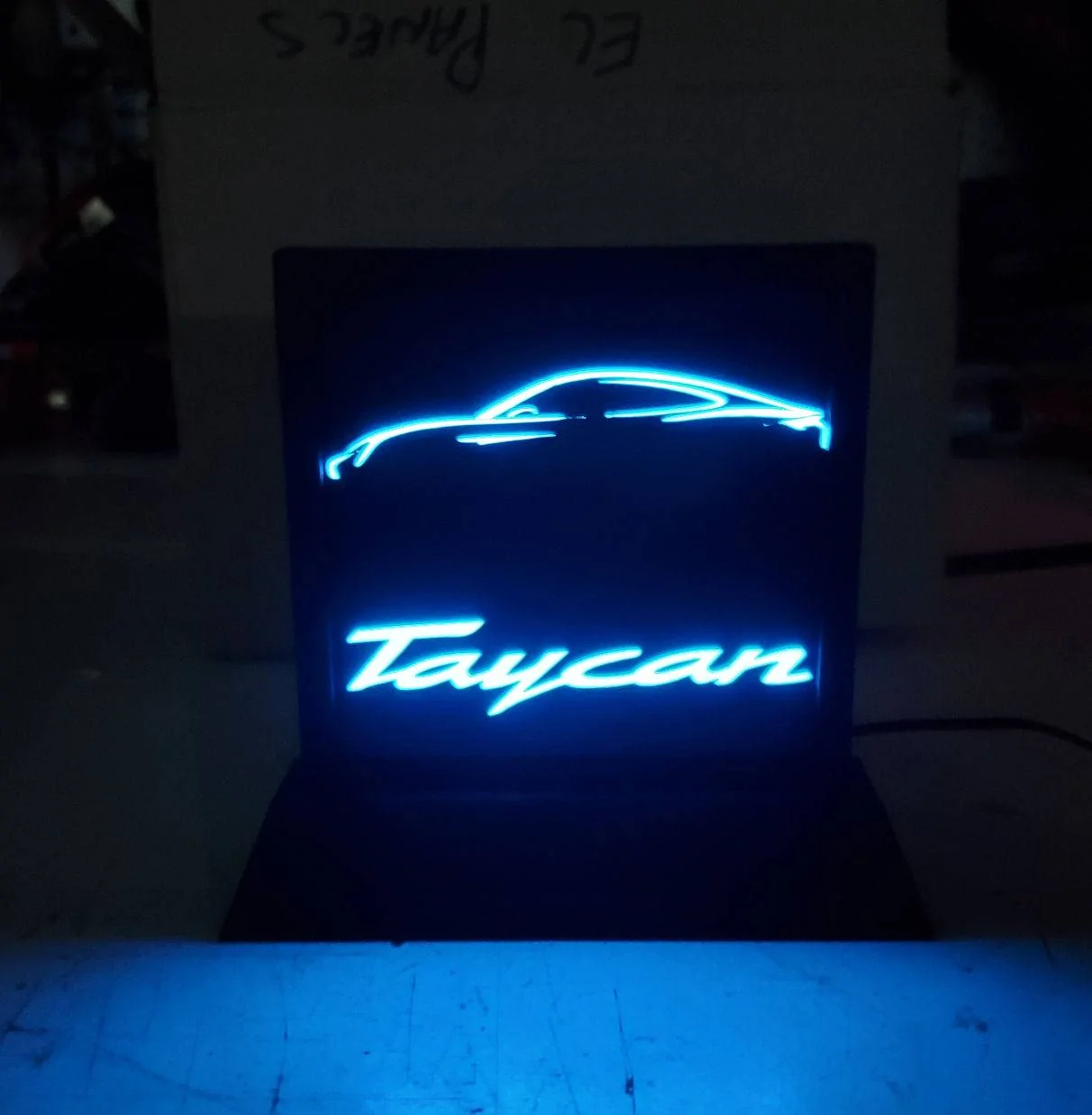

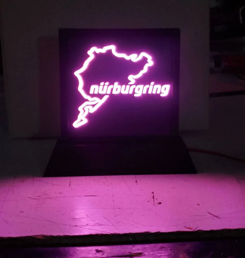

...and if one makes a couple of Taycan designs, might as well throw in a Nurburgring Track Map as well ;-)
Porsche Taycan Taycan Font 4
I think I would make the profile artwork a little smaller to give a bit more clearance around the perimeter. However, the lines of the clipart are very fine already. The "Taycan Turbo S" logo is also pretty small so I think the larger "Taycan" logo looks better!
In any case, masking an EL panel seems to work pretty well! The larger 12" x 2" EL strips would certainly make the logo look better. I don't think you would really see the illumination in broad daylight though...

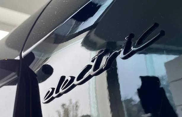

Thank you. The emblem is that one, but looking just for the vector file.
Not able to find out the digital image of the plain "electric" emblem.
Were you ever able to find a file for the "electric" emblem?
