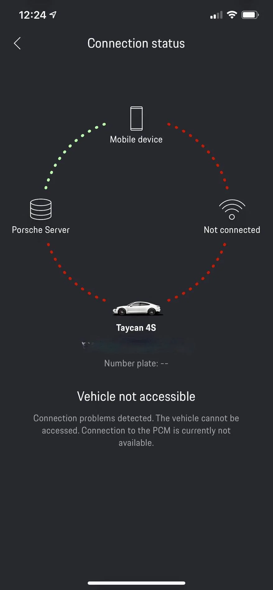

Has anybody else had problems with their Taycan not connecting to Porsche Server. Mine has been down for a month now, been escalated to Porsche Germany who are saying its part of a larger problem....no more details....the LTE sign does not appear in the dash...see attached what I get on my app

I have the same connection problem in the Connect app and the Connect webportal here in the Netherlands, but only since this morning.
Note: Your mobile device is also not connected to WIFI. I do not have this problem. This is a setting issue in either your mobile device, or your WIFI access point.
Can happen periodically and just checking that you are aware only 3 quadrants need to be green (you can ignore the bottom right as this is rarely / never required - only for phone to PCM calendar syncing using the in car hotspot).
Ask your dealer to check your OTA module - it could be failing / failed - as this is a core dependency.
Could also be a registration setup issue.
Have you tried resetting your PCM (remove your account) and start over?
Can you connect via My Porsche website?
11,073
6,854
Also, can you confirm you have PRIVACY MODE disabled (PCM function) - this is essential to remotely access your car and should be disabled always.

Thanks Benver.. all other devices connect to wifi in the house without a problem....seem to have the same problem when I connect to the website also
I have the same problem when connecting to the website, i have logged out and back in on the taycan no luck,
Thanks Winge, yes just checked, Privacy mode is disabled

I lost connection between the car and the Porsche server 2 weeks ago, so down to just one green quadrant between my phone and the server. Germany had a look and now I have all red quadrants!!!
Germany have advised that there is a problem with the car connecting (really?!) and that I need my dealer to look at it.
First available slot at the dealer is at the end of February.
I dont mind being a tester for Porsche tech, but I do expect some service from and organisation that has taken £100k off me and is holding a large deposit for a CT order (don’t get me started on that).
Sadly this is all too familiar. The Porsche Connect App is fundamentally flawed and the connectivity to the car equally flawed and generally unreliable (well documented on this forum).
It could be there is an issue with the car's LTE module (some folk have had theirs replaced 3 times) which is a core dependency for communicating with the car. A weak cell signal (or interference) is another. I'm also pretty sure that the car goes to 'sleep' if not used for a day or so and to conserve energy drops 12V power to the LTE module and hence you can't wake it up until you unlock the car again.
The 4 red quadrants is not uncommon either and generally occurs when no connection can be made and times out. Try unlocking the car, wait for the LTE connection to appear in the PCM and then re-try the App (don't bother about connecting to the PCM, this quadrant is generally always red / unused). This may re-establish your connectivity for while.
I've grown to not be dependent on the app for any remote activity - limited value - and so don't expect the app to connect when I want to check on something.
