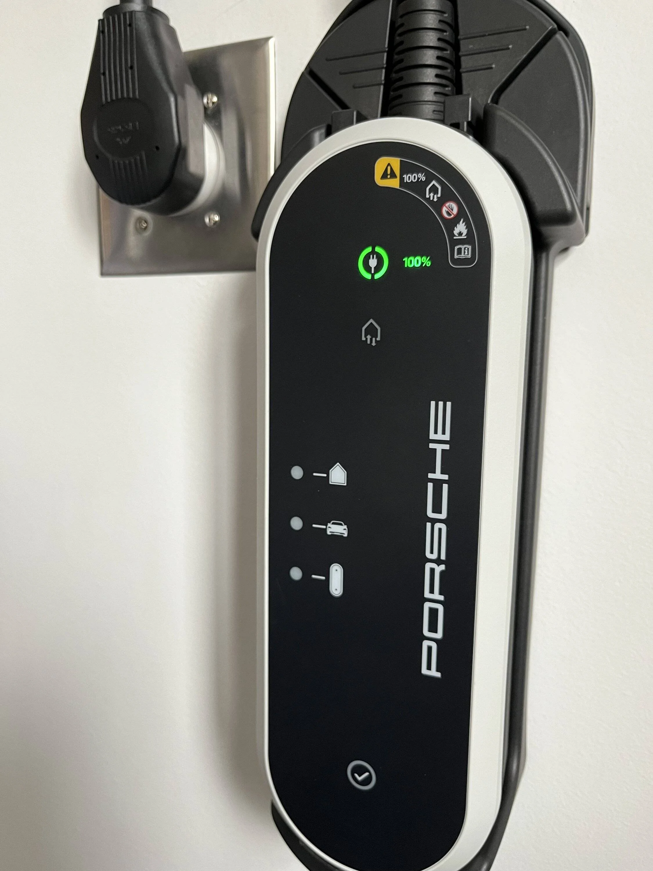

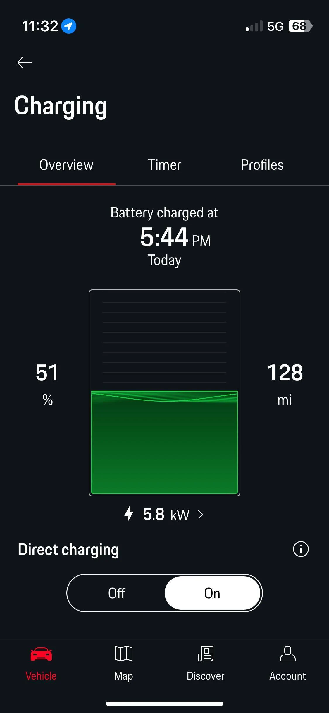

Normally, I charge overnight on a timer so I don't pay attention to the speeds, but today I needed to direct charge and noticed only 5.8 kW speeds. PMC+ unit is set to 100%. I've seen it charge at 8.7kW before so not sure what could have changed. Could it be a software issue?

make sure you haven't inadvertently pushed the 100% button at the top of ht unit which will set power to 50%
You could stop unplug and restart the season to see if goes back to 8.6 kW

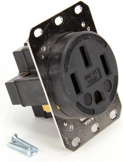

also your NEMA outlet does not look like it's a Hubble outlet - the PMC+ will overhead "lesser" resdiential sockets and over time cause them to melt and short out…you require the high quality Hubble socket so that it will not melt after repeated thermal stressing by the PMC+/PMCC - you can safely run your unit at 50% until you can get someone to replace your socket with a Hubble socket. Hubble sockets are best practice for EVSE industry wide (Tesla, Rivian, Porsche, Lucid, Ford, GM others all recommend/requlire Hubble sockets).

Porsche recommendation/requriement for the PMC+/PMCC is a Hubble Commerical/Industrial grade NEMA socket to handle the nominal operating temperatures of the PMC+/PMCC…
it's not safe to run the PMC+/PMCC with a non-Hubble socket…

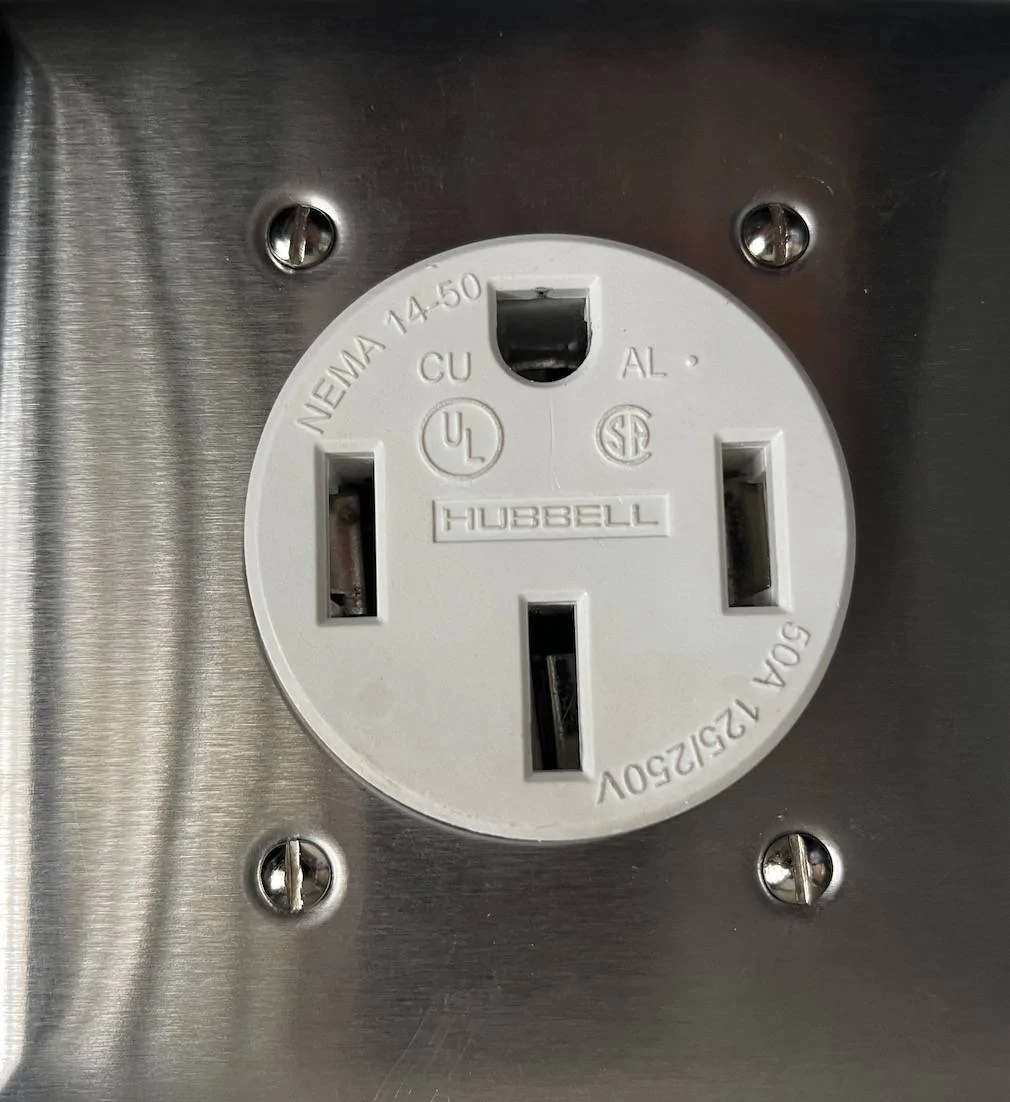

Thank you David, it's a hubble outlet. Just unplugged everything and made sure the pmc+ was set to 100%. Still only getting 5.8kw with direct charge. Perhaps it's a hardware issue (cable or onboard charger).

wow I'll stand corrected - I've NEVER seen a white Hubble!!!! that's awesome!!!
learn something new every day…
the 5.8 kW makes it seem like you're only charging at 32 amps which is odd…

OP are you certain you have a 50A circuit ? That charging rate is indicative of 32A just as Daveo4EV has suggested.

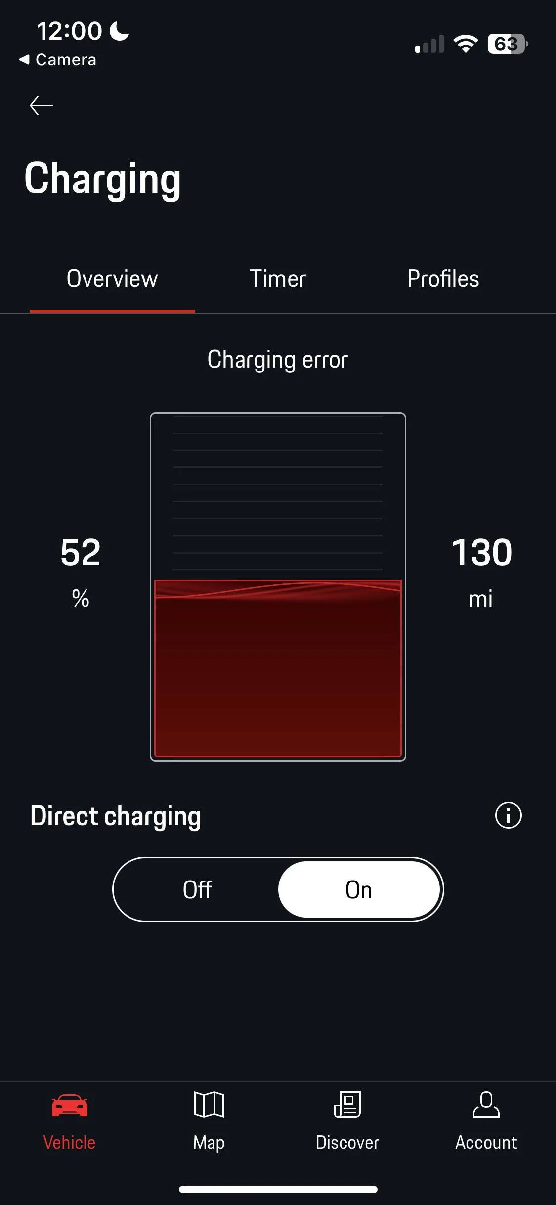

Coincidentally, just now my direct charging stopped via an error. It’s not clear where it’s coming from though so may need to get another charger to test.

8.7 kW is indicative of 40 amps (50 amp breaker) with about 10% loss typical from the EVSE to the car. 7.4 kW is indicative of closer to 35 amps, which is a very odd number (could not get that from 32 amps for sure). The 5.8 kW suggests that the issue is not the charger being set to 50%, because if it were at 50%, it would only deliver ~4.4 kW maximum. I wonder if there is a setting in the car itself that is restricting the charge? Either that or the EVSE is faulty. The plug isn't the issue. It would either deliver what was demanded of it safely, or it would blow out the circuit breaker if the wrong breaker capacity where installed (e.g., 40 amp breaker attached to a 50 amp plug it would just trip the breaker, not derate the charging equipment).
There is either something wrong with the on-board car charger (or the PCM settings) or something wrong with the EVSE. The wiring looks fine to me. Anyone know if there are charge restrictions buried somewhere deep in the PCM to check?
