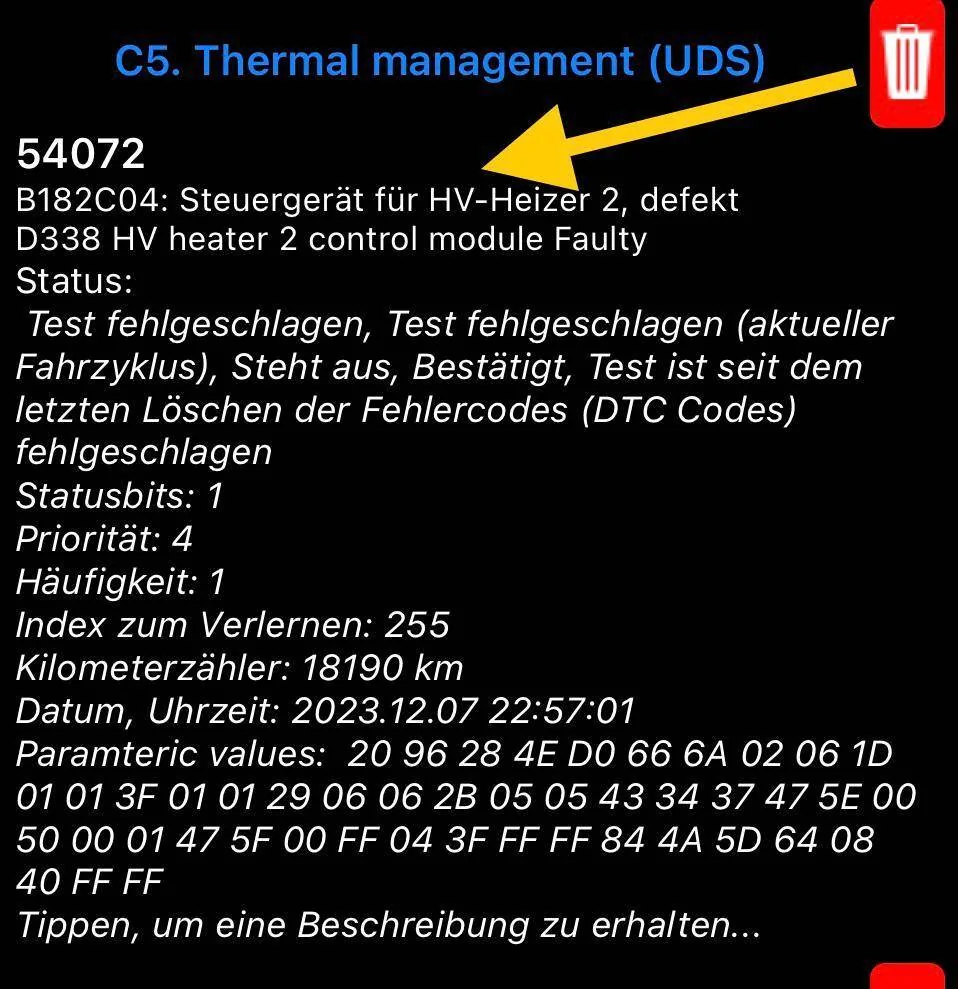

I heard from my Porsche Dealer 4 weeks ago that they are abolutely prioritising heater repairs of existing Taycans. From those I heard of being replaced lately they also have a very recent production date which you can read with e.g. VCDS.

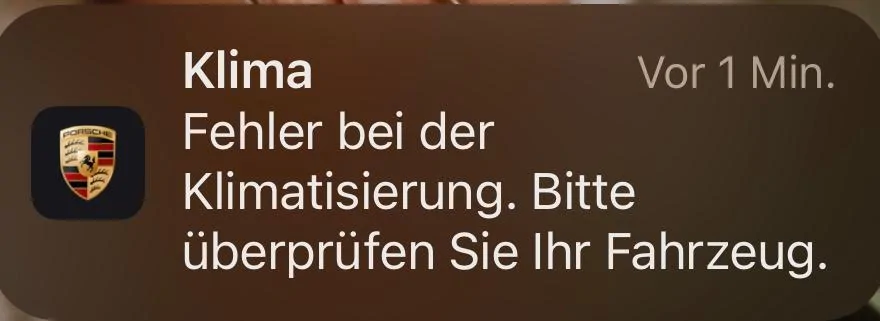

Btw: carscanner is now able to read DTCs from the thermal mgmt ecu, even the My Porsche app is telling problems...which is either new or a slightly different problem with the heater:
