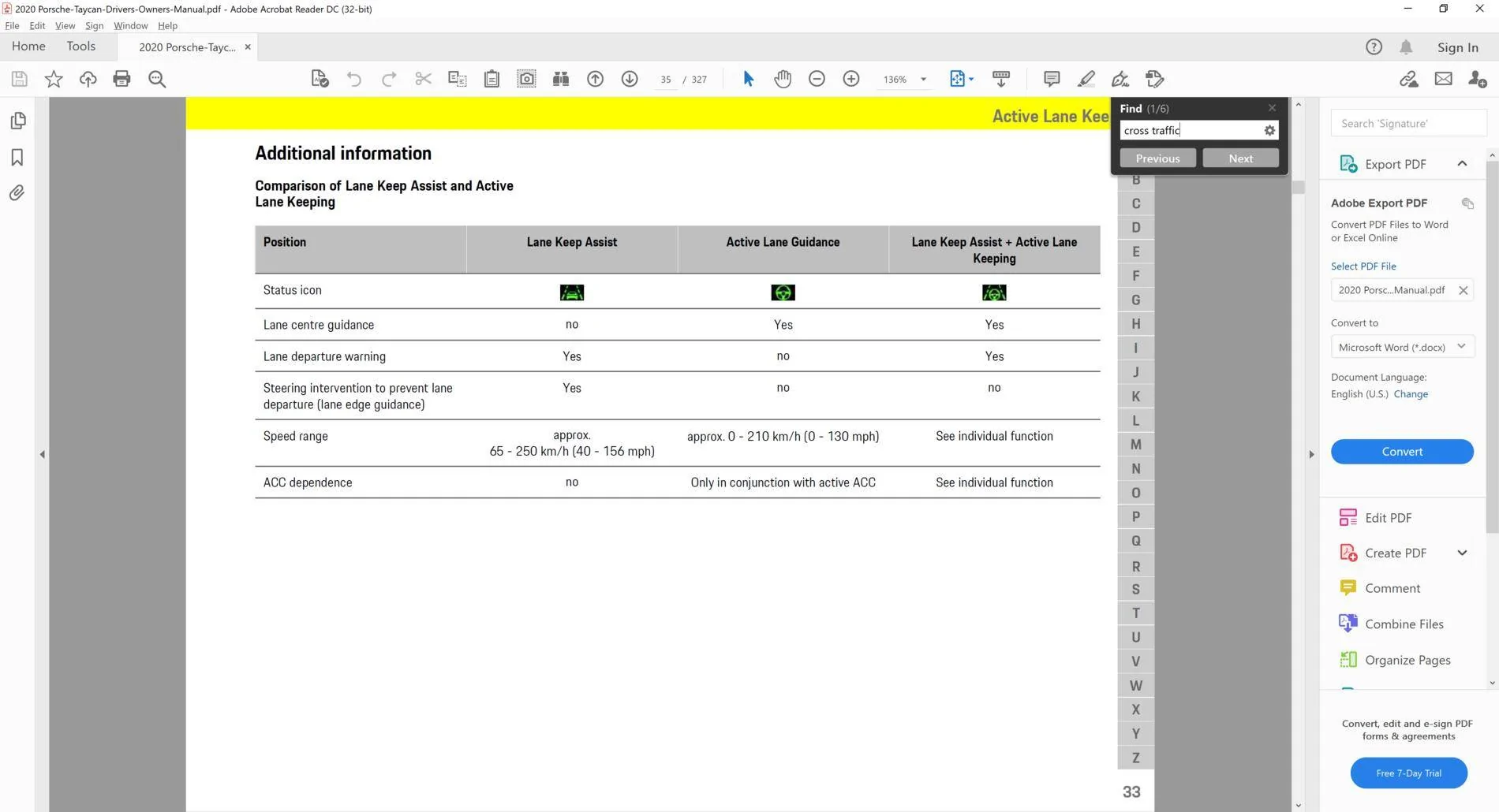

Has anyone noticed that after WMA5 update the "steering wheel" icon is no longer present when you use these modes? Mine worked and looked fine pre-update, now the assist functions don't work as well and the icon is gone (just shows the lane lines).

My car went back today. Both problems ( Active Lane Keeping disappeared and vibration) solved. Vibration by balancing the wheels

I had the same problem. They probably forgot to the mark the check box active lane keeping assist (as it has become a FoD) when they installed the software. My car went back today and they had to reinstall the software. It took 2 hours to solve.
