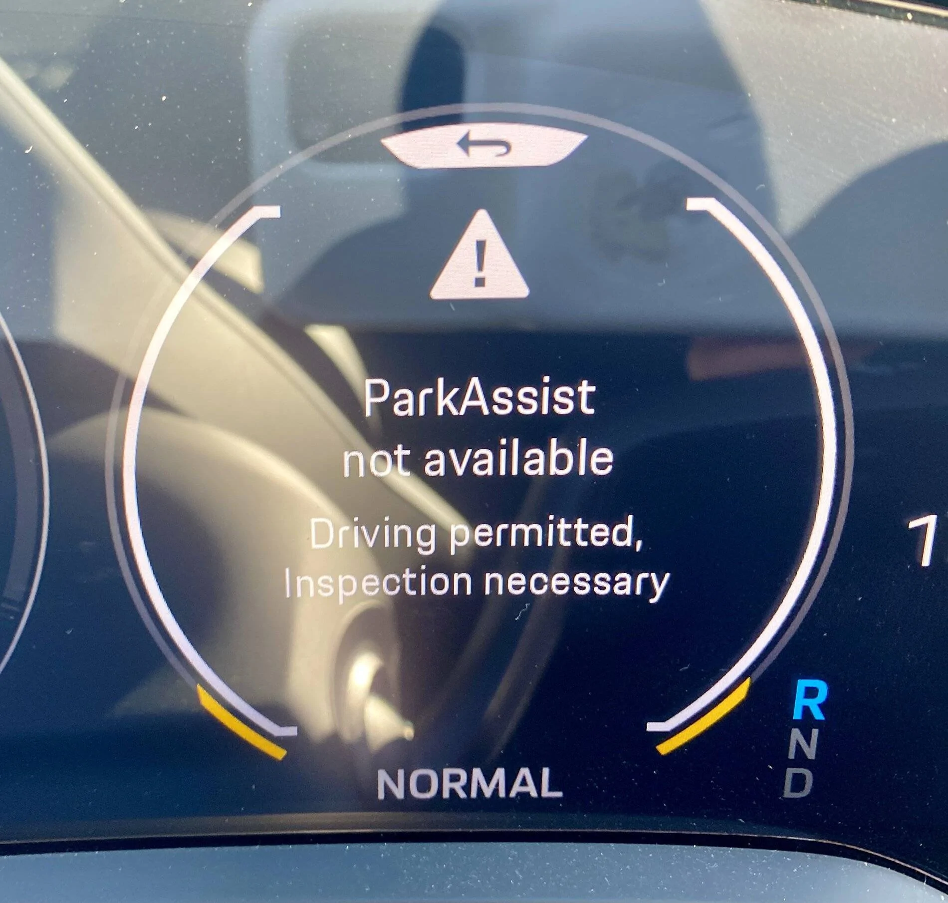

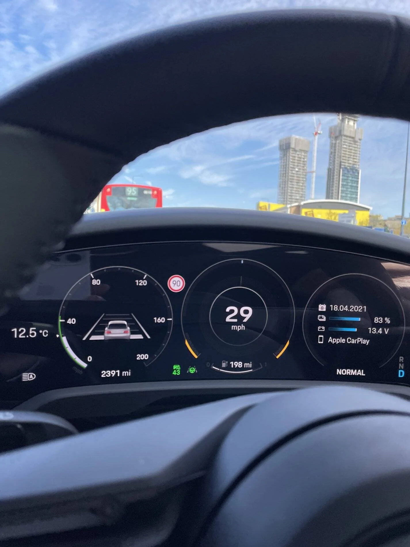

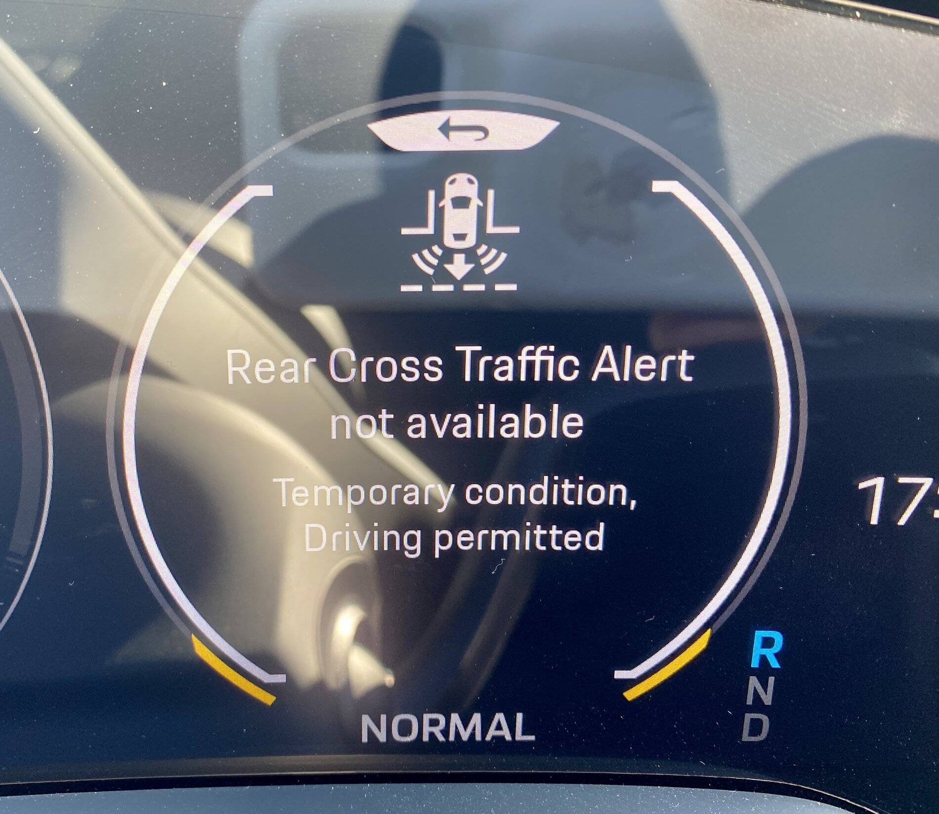

Three new features post update:
Park Assist Not Available
Rear Cross Traffic Alert Not Available
Increased Speed Limits in the U.K.
In all seriousness though, the driver assistance settings now seem to stay checked and Car Play starts a bit quicker.
The two failed driver assistance aids that have now failed means is almost impossible to park the car as the ultrasonic sensors don’t register proximity.
No amount of restarting the car makes any difference.
She’s going to have to go back.

Did you uncheck and check all the different settings again?

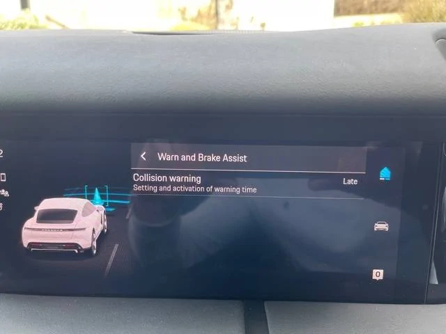

Since the update on MY 21 4S I’ve now had the Collision Warning – pop-up and applying some breaking twice on separate days on a road I drive very often near my house, up a hill with a blind bend. On both occasions there has been no near collision, in fact on both occasions there was not another car or pedestrian in sight, I wasn’t speeding (going 30 mph) , I wasn’t on the wrong side of the road and the weather was dry.
Never happened pre-Update.
Anyone else noticed any issues with any of the Assistance/Warning settings now being either faulty or too-sensitive? I’ll check the Good to Know App but I don’t think you can permanently turn them off and they reset each time you start the car, will need to double-check though.

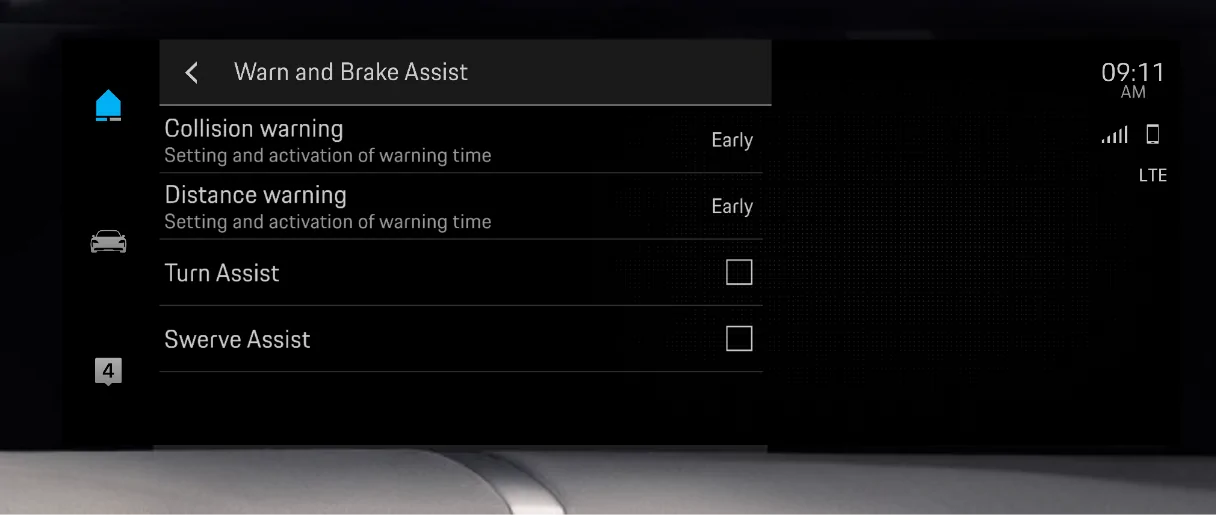

You may have to check if the warning is set to default (early) again.
Mine is set to "late" (not "too late" :) )
Settings -> Assistance systems settings -> Warn and Brake assist.
Porsche Taycan Taycan software update - reported problems post update Screenshot_20210418-193540
Porsche Taycan Taycan software update - reported problems post update WarnAssist
I don't have all the settings you have - I only have collision warning and it was set to Medium - I've now changed it to Late and will see if that makes a difference, not sure if it's country dependant and the UK spec doesn't have them or it's because I didn't spec something i.e. I don't have innodrive?
Adaptive Cruise Control is needed for all but the basic settings.
