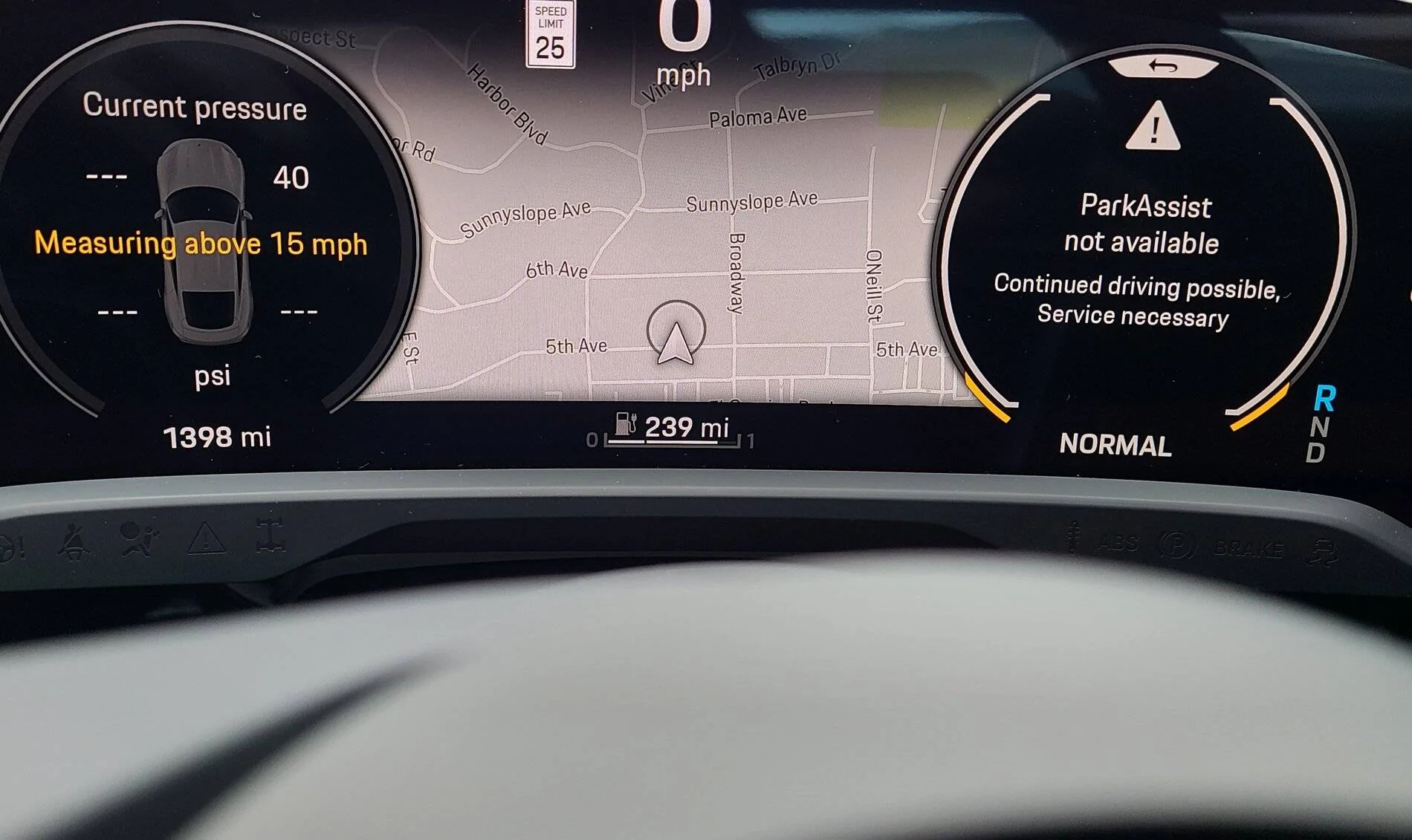

My ParkAssist fails frequently after the update. Before I had only one ParkAssist error in 4 months. After the update ParkAssist fails once a week. Certainly a software bug since a restart fixes the problem. All sensors and cameras are clean and I don't have PPF.
