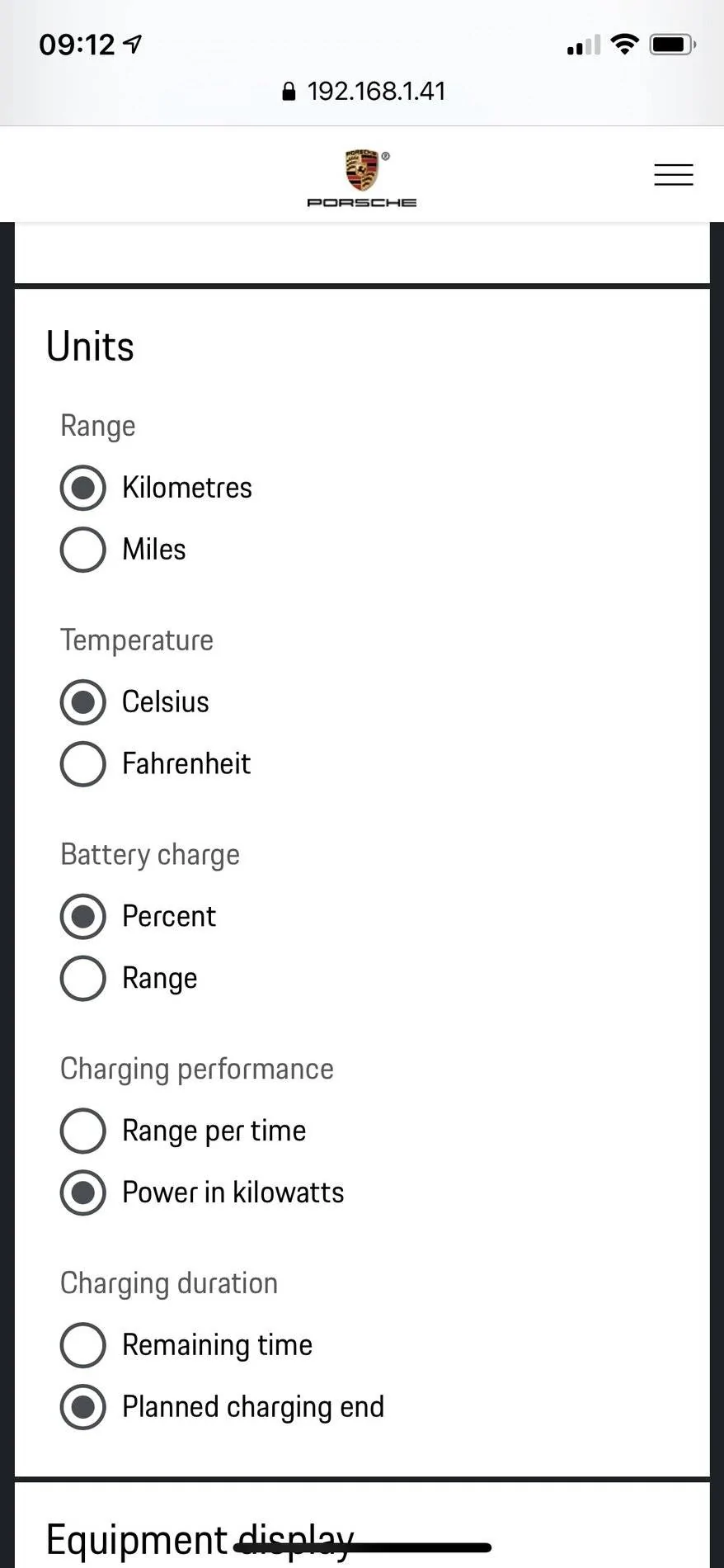

I have SOC displayed on my PMCC (MY21 car and no updates to PMCC following WMA6 campaign).
However, the stats recorded on My Porsche can be random and incomplete. SOC at start and end is not always populated plus the time axis is completely off by -6 hours which frustrates the hell out of me.

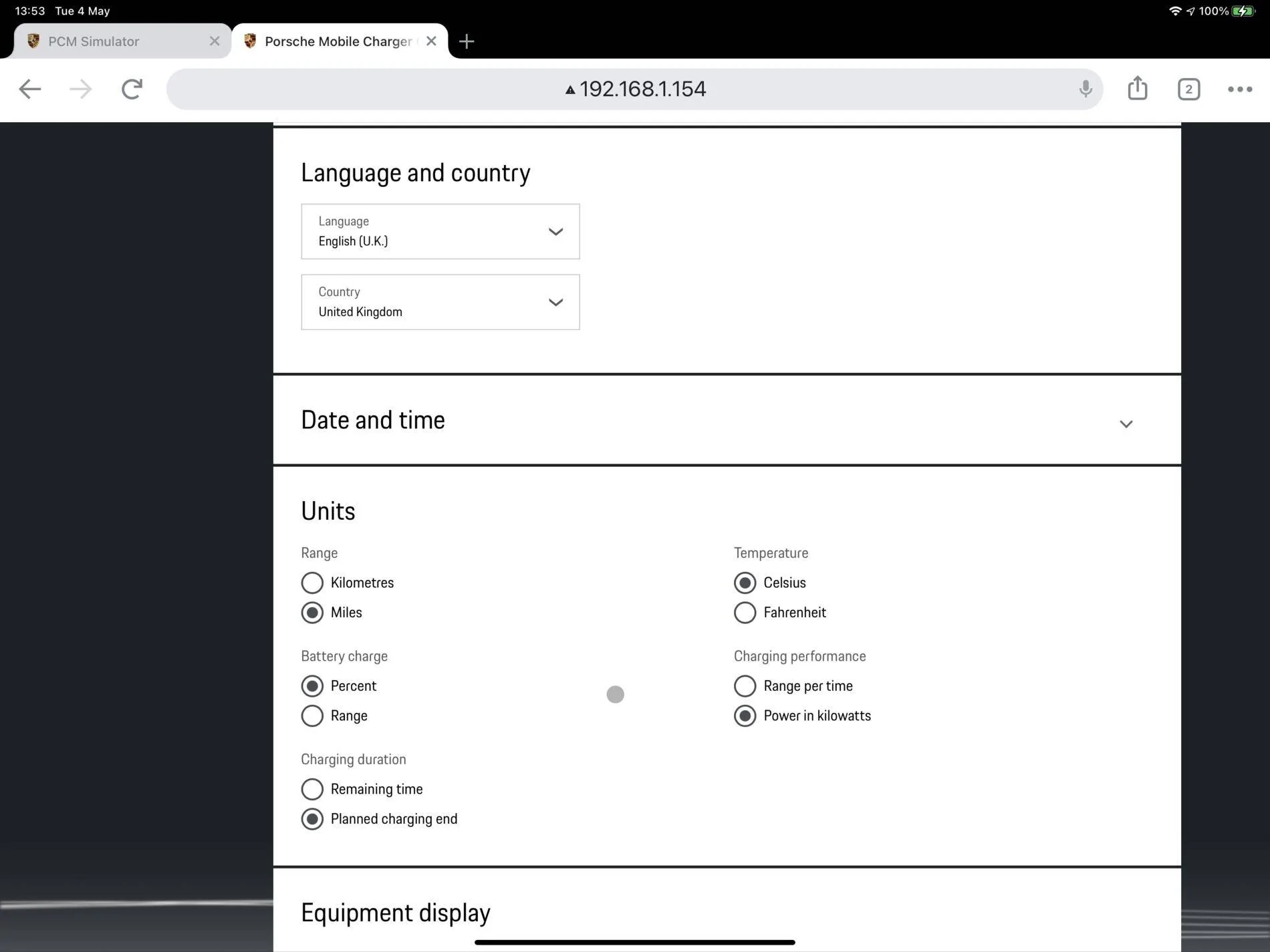

Just remembered I hadn't posted a screenshot of my PMCC settings to see if that helps with SOC display issue.
Porsche Taycan Taycan software update - reported problems post update 20210504_125356000_iOS

Thanks for the photo of your settings etc.
Here is a screen shot of my settings. Similar to yours and these have been like this for a year now. PLC communication to the car is enabled and has been also for a year.
Porsche Taycan Taycan software update - reported problems post update B3ACBE04-E5D8-4289-BDE3-80C8844F532B

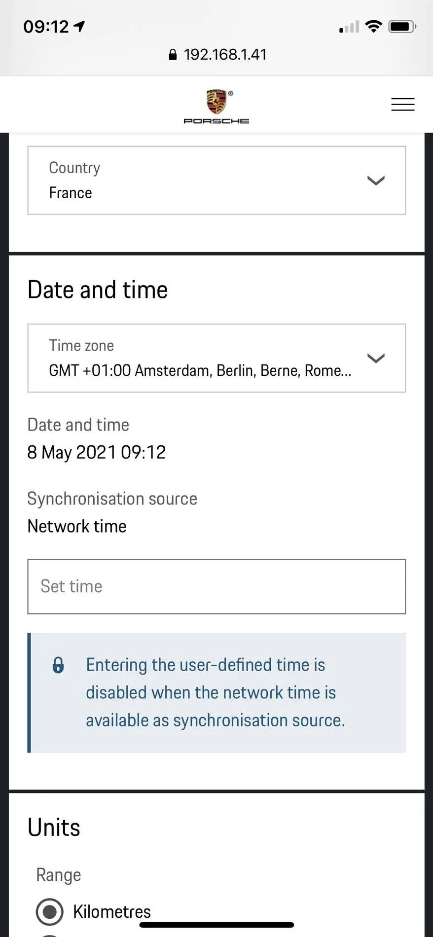

I do not have any problems with the time stamps. The charger seems to take that from the WiFi network. would you by any chance have your MyPorsche account registered in say the US rather than the U.K.? ( time difference US to U.K. is six hours, isn’t it).
Porsche Taycan Taycan software update - reported problems post update 30201954-B8B6-49CE-AECA-9C9DC9B8ADF5

Thanks but US is +6 and mine is -6 so easy rather than west (Taiwan perhaps).
Time from all sources is correct including on the PMCC (!).
When charging time comes from the car.
I suspect the issue is on the Porsche servers and my region has been set wrong.

I also noticed on your screen shot that you don't have an option to display battery percent unless I missed it?

And I do have a setting for showing percent of charge in the settings, but nothing is shown on the PMCC display. So like all others it does not seem to work with MY20! Very peculiar since all the settings have been in the PMCC and on the MyPorsche site all along. Have no idea what it will take to get this to work?
