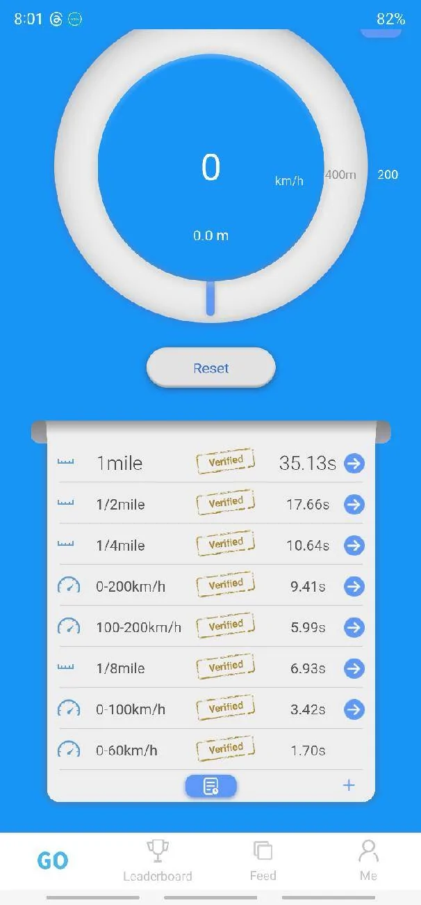

What was your trap speed on this run??
My Stock 2021 TS did several 10.5@131mph with 90% or higher SOC (dropped to 10.6@127mph under 90% SOC)
My RS is equivalent to a Turbo and when not in launch control, the same as the Turbo S.
I'm getting a full second better from 100km-200km, .4sec 1/4m improvement, 6mph improvement on trap speed
100-200km is more consistently 6.3sec on flat roads
I don't get any improvement on 0-100km because the front motor is already max power. This upgrade gives more power to the rear motor which is what we mainly use.
132mph
We are waiting for better weather to run with the upgraded Turbo S. Hoping for a 10sec flat 1/4mile

I have made about 9 runs in the 10.5-10.7 range @ 131-132mph so I am sure that the range for my stock Turbo S. I may do the tune to see if I can do 134-135mph and low low 10s. But mostly want the unfiltered throttle response (like Teslas have, my wife's Model Y-P feels faster sometimes due to the throttle response lol) and full-time overboost without starting from a stop.
You should get 5mph better trap, .04sec better 1/4mile
The problem is when its not in launch its sluggish.
Another member here and I were comparing the throttle response to a Tesla and specifically the time I drove a EQE350 AMG. It feels much faster because it gives all the torque instantly, but dies right after. After I told Mario, they found a setting called "Drivability Adaption". The Audi is even worse than Taycan because it's a GT so it kicks in way later.
Mario can set how aggressive, but I tell everyone to remove the filter completely. It's only as aggressive as how you modulate the throttle
A big unknown with the Turbo S would be the 0-60 time. Is there a benefit with the upgrade? We are waiting to test this
What's your best 0-60time?

My best is 2.72 sec 0-60mph, it's usually 2.74-2.89 on average
I don't expect much more than a tenth or two (2.5-2.6 will be my expectations on my car), but I am wanting higher trapspeeds and better throttle response mostly
