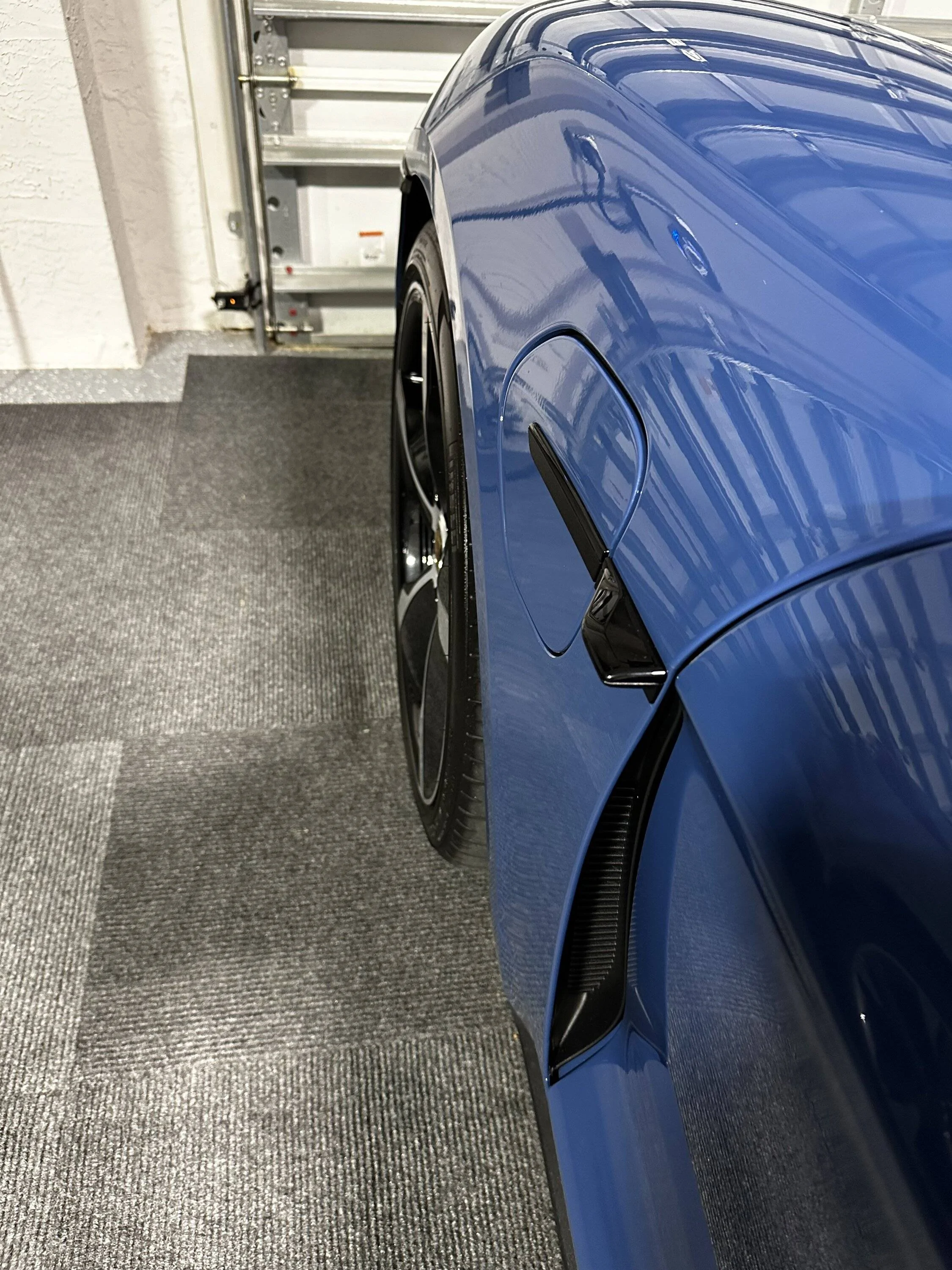

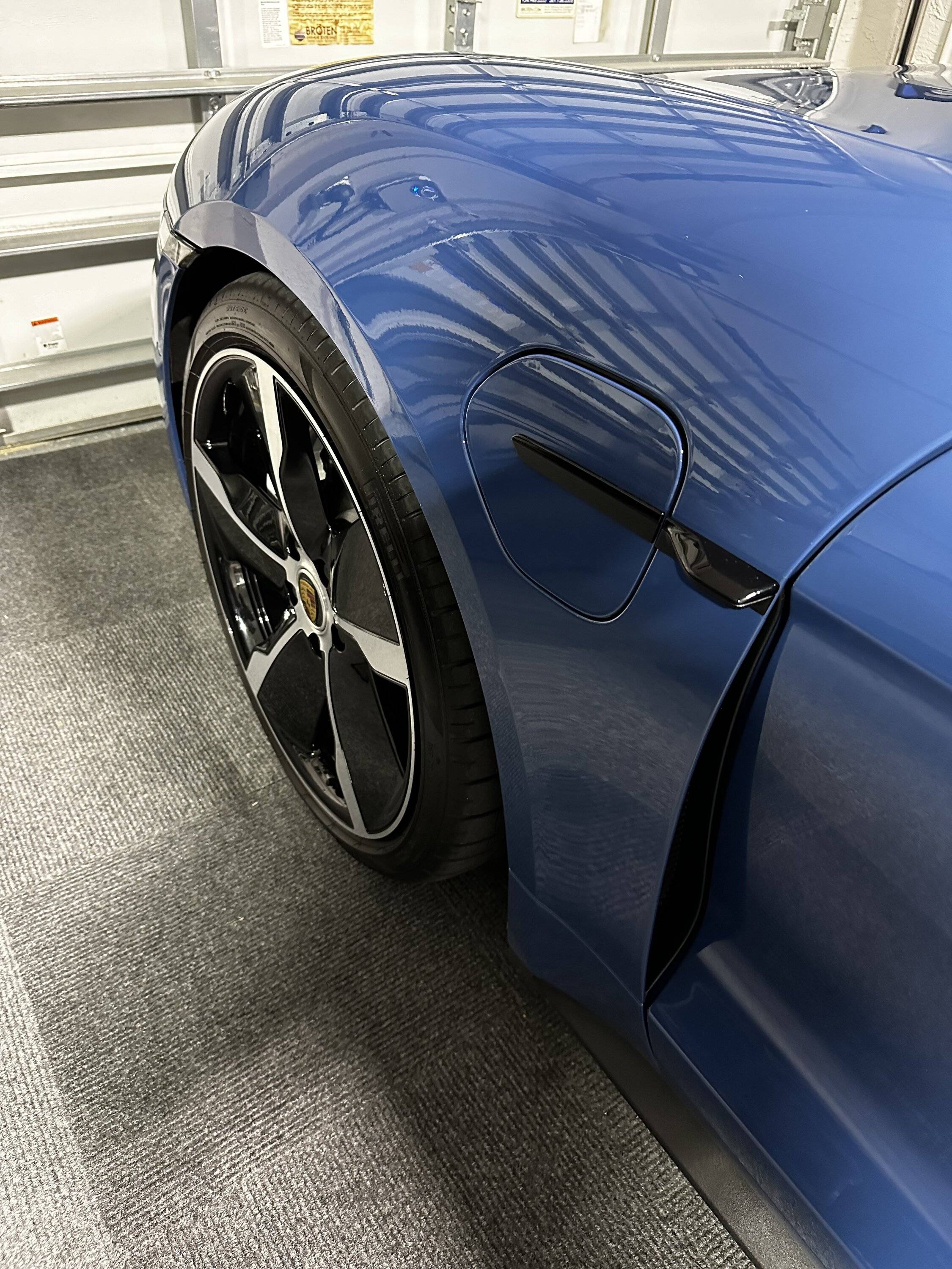

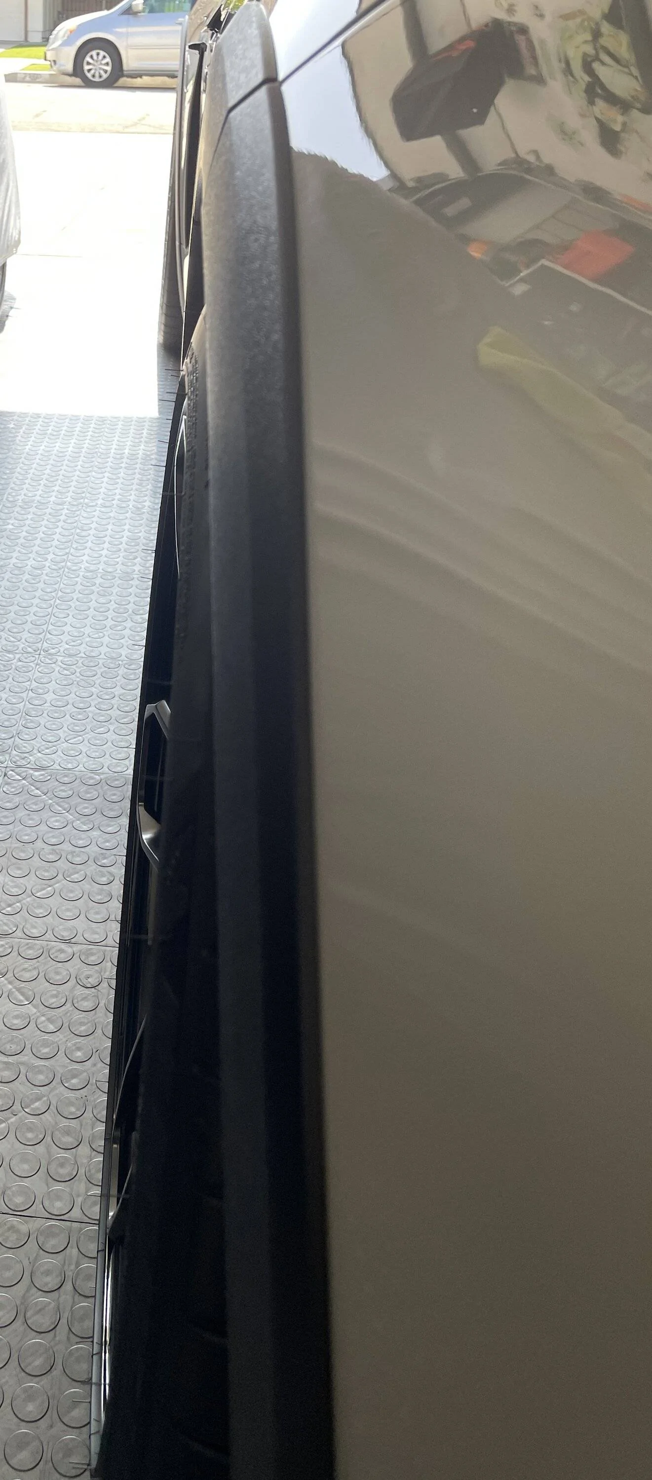

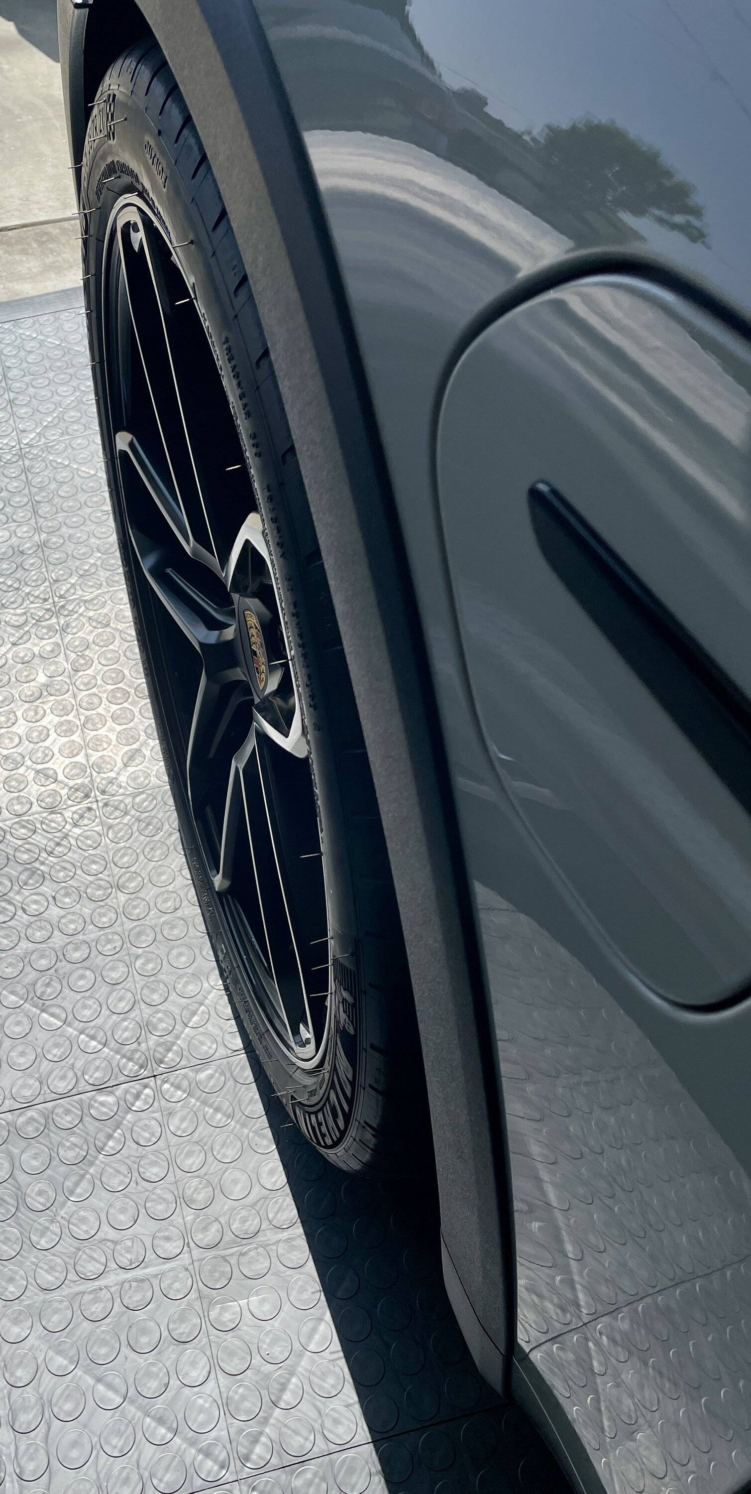

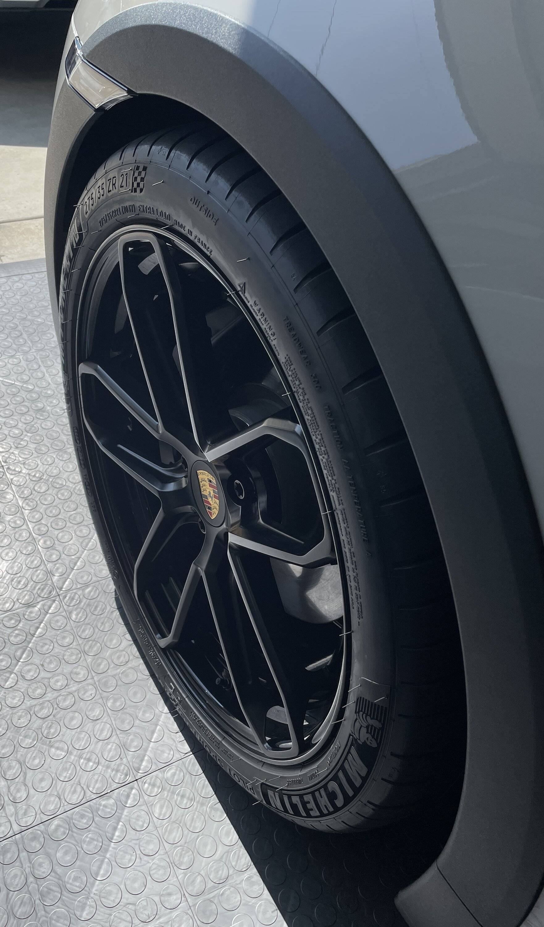

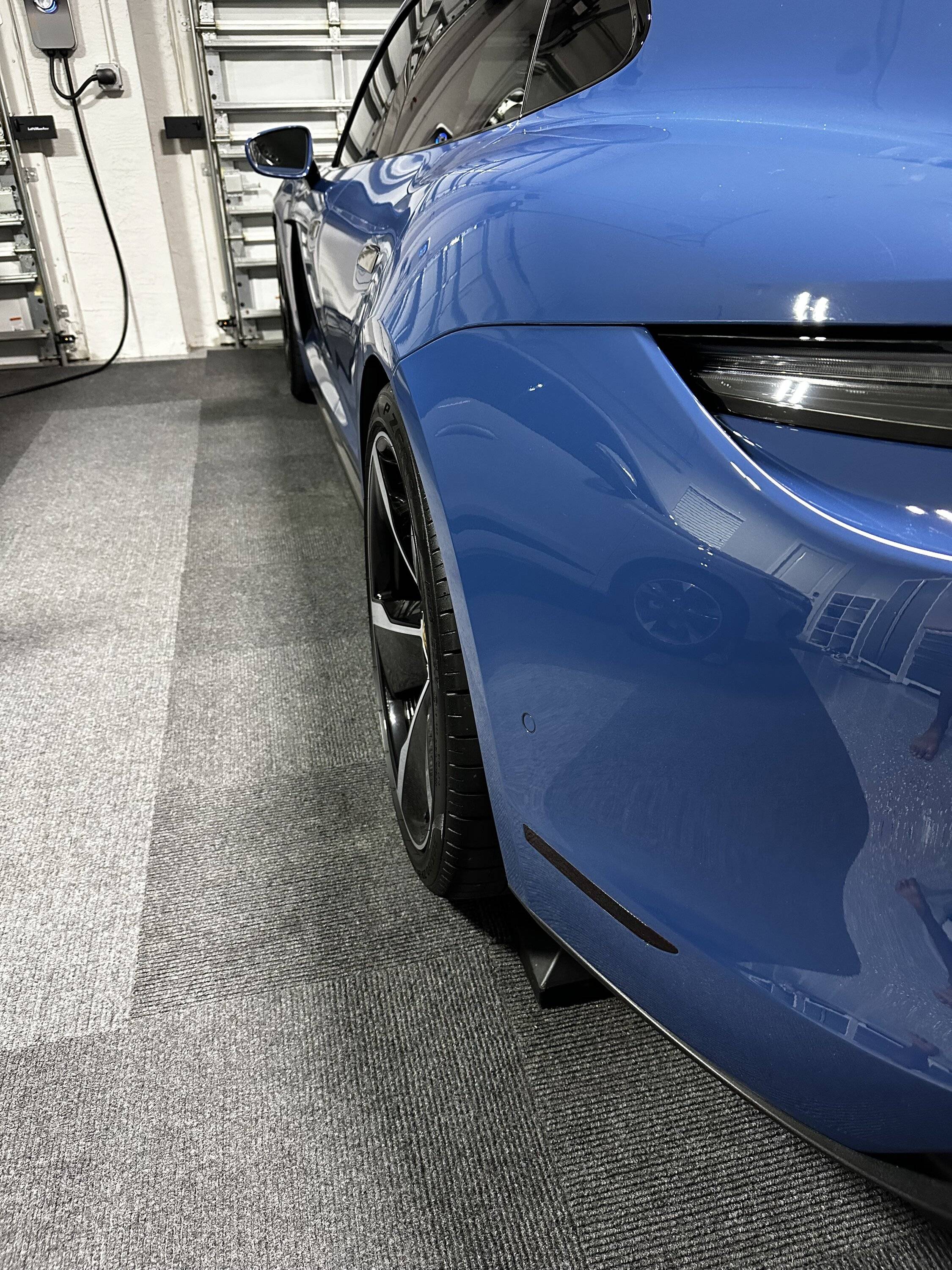

I did 15mm all around on 21” wheels and they look perfect, and no rubbing even on the lowest suspension height. I preferred keeping the offset consistent front to back. I have the air suspension and rear wheel steering.
Porsche Taycan Taycan Wheel Spacers IMG_1411
Porsche Taycan Taycan Wheel Spacers IMG_1412
Porsche Taycan Taycan Wheel Spacers IMG_1413
Porsche Taycan Taycan Wheel Spacers IMG_1414

thank you for the photos this gives me a good idea of what to expect! I’m looking for a little more aggressive fitment so I think 20mm all around might be the perfect setup for me.
nischalr
Nov 11, 2022
221
305
Ft. Lauderdale, FL USA
Taycan GTS ST, Audi Q4 E-tron
Yes, I think you will be ok with that, my intention for my first tire change is to increase width of tires to 275/35 in front and 315/30 in the back with Michelin pilots sport 4S, and wanted a little headroom for that. I think the oem tire size look a little too stretched and the slight increase in width of the tire will give a more “squared” look that will complement the spacers. Hopefully it works out. With rear wheel steering, I wanted to stay slightly conservative to prevent any chance of rubbing even in the lowest setting.
Good luck!

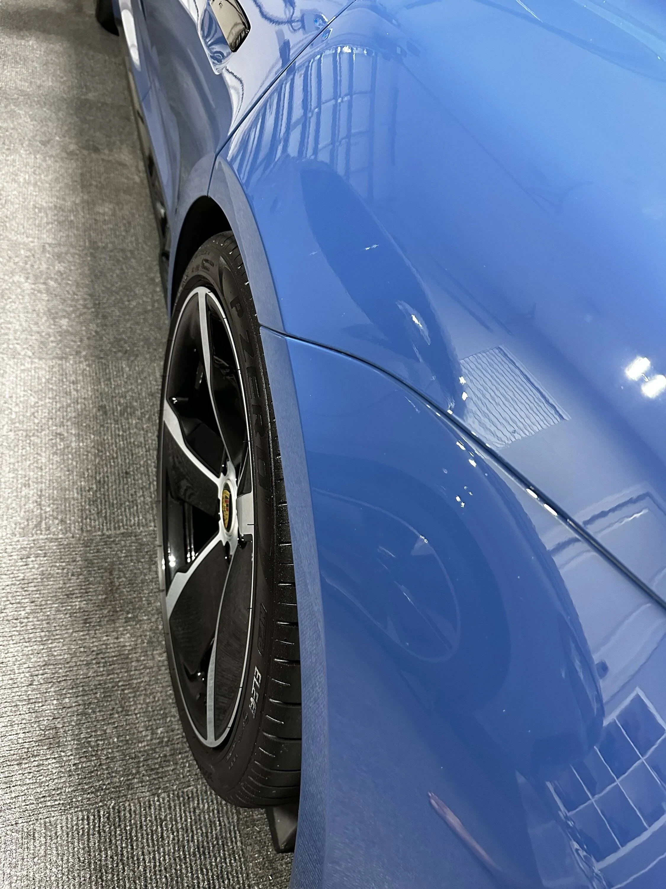

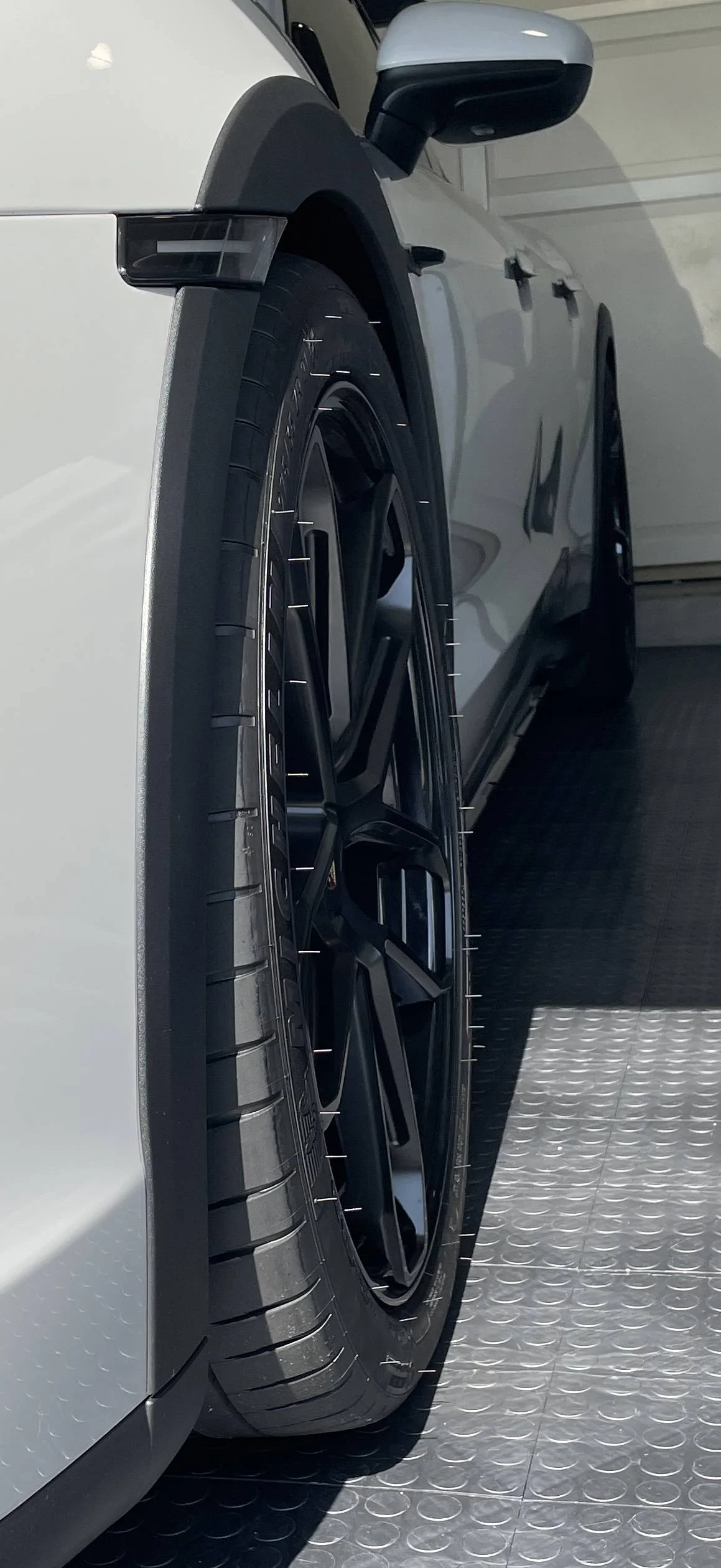

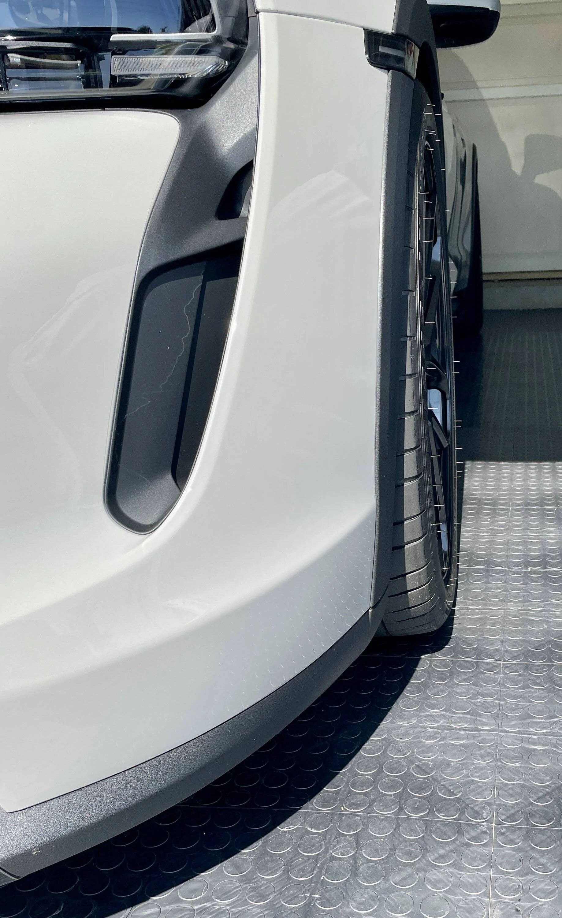

Here are a few images of spacers on a Cross Turismo hard to really tell.
But hope it helps a little.
275/35 21 Front 21 x 9.5 @ 50 + 3mm spacer
325/30 21 Rear 21 x 11.5 @ 55 + 7mm spacer (will move to a 10mm)

Thank you for the photos! I like your wheels!
