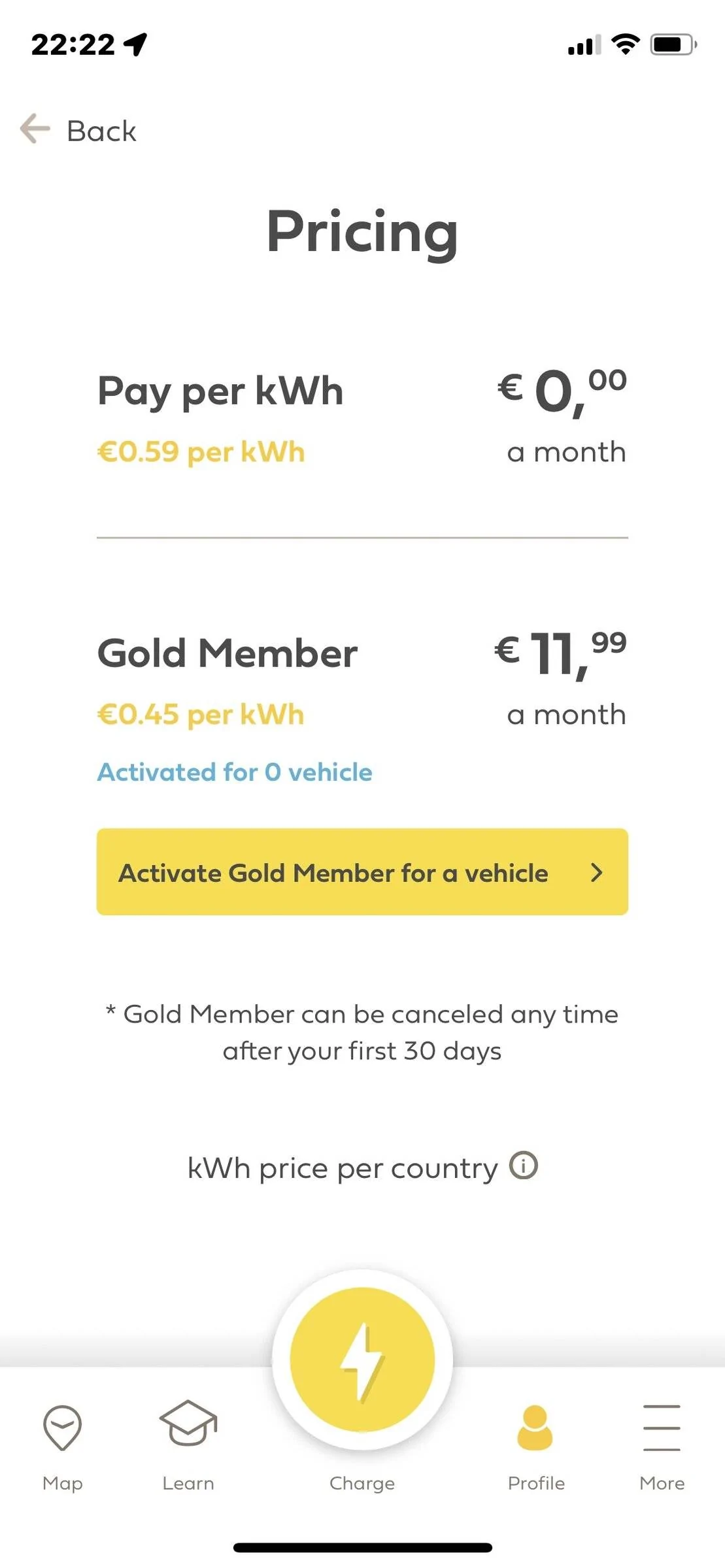

I could not find any better charges for Fastned in France though, without a monthly subscription. The price for me has been 0.59 cents per kWh. So nearly the same as other providers except Ionity. The good thing with Fastned was kWh pricing without minute charge though. This was what I saw for France

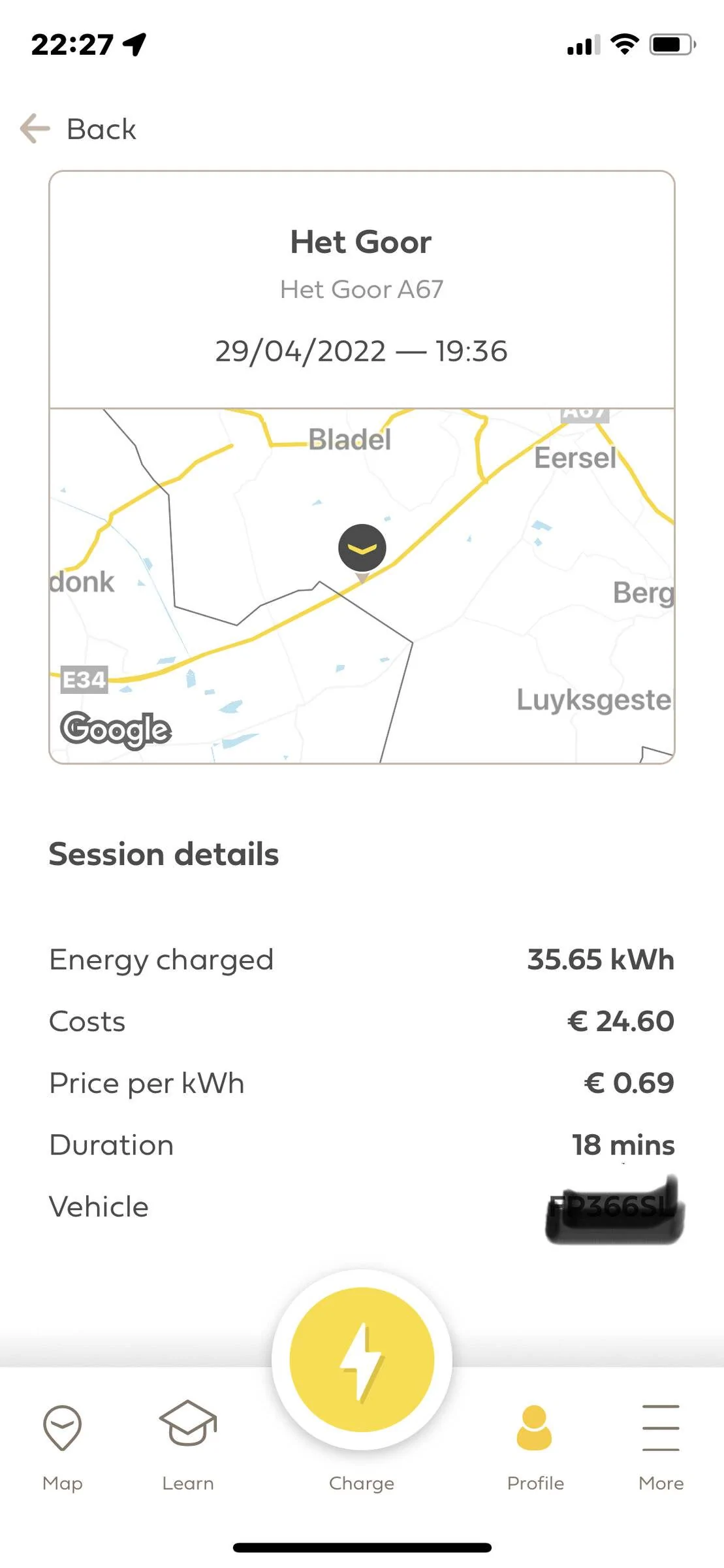

And this was what I was charged in Netherlands at Fastned. I do not have any subscription though.
Porsche Taycan Tesla Superchargers opened in Sweden 52F8BD5E-42A4-4E61-AE9F-6C6E921D8DDF
That was 0.69 Euro per kWh with the Fastned app.
So yes it needs to be checked and double checked.
