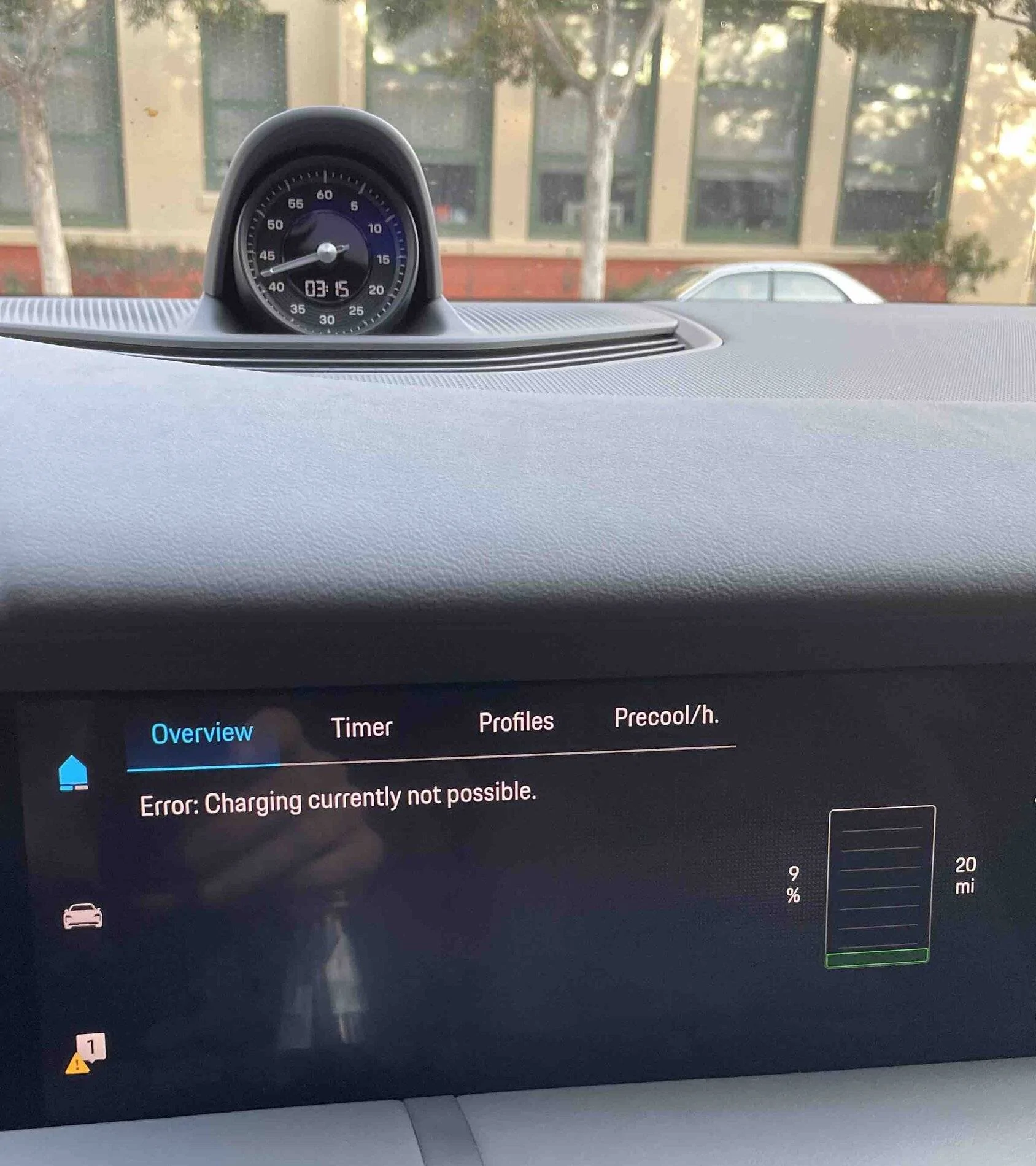

Hi everyone,
I recently purchased a TeslaTap and when I try to use it, the Taycan says, "Error: Charging currently not possible." Has anyone encountered this and resolved it?
I am trying to use a Tesla Mobile charger plugged into a 240V 30A (NEMA 14-30) outlet. My Tesla charges fine from this outlet with this Tesla mobile charger, and the Taycan charges fine from this outlet with the Porsche charger.
I am trying to use the "TeslaTap 50 amp - high power" unit. I emailed the company for tech support 11 days ago and haven't heard back. Their website "conveniently" breaks when you go to the "Contact Us" page.
I followed the three directions on the Teslatap itself (Confirm green light on Tesla charger; Secure teslatap to tesla plug, which appears to just be seating it firmly; wait 30 seconds; go for it).
Any thoughts of helps greatly appreciated!

sometimes you have to “seat” the TeslaTap very firmly and deeply - mine always work great - might just be a bad unit.
