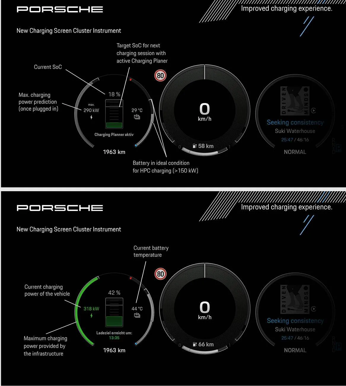

1. Left tube changes of the refresh model is the biggest envy of us first gen owners.
Left kW number is a prediction of maximum charge rate at a DC charger that depend on the temperature so to maximize that number the temperature needs to be in the ideal condition within the right bracket. Do not get me started on the feature where the car will actually blame the charger if it is not providing maximum speed the car can consume!
Porsche Taycan Three interface questions: kW readout, HVAC, map view 1745243591538-sd
2. My understanding having 3 cars is that there is no such a thing as pure fresh air setting in a Porsche where you can actually feel that the outside air just flows. The best thing is to just set it to Auto and let the car handle it.
3. Map view should be customizable as others said by pressing on the right wheel to pop up additional settings. I cannot verify how it exactly works on the refresh since I have the first gen and I know they have changed tube navigation interface that to me is less intuitive having driven several 2025 Taycans for a day.
