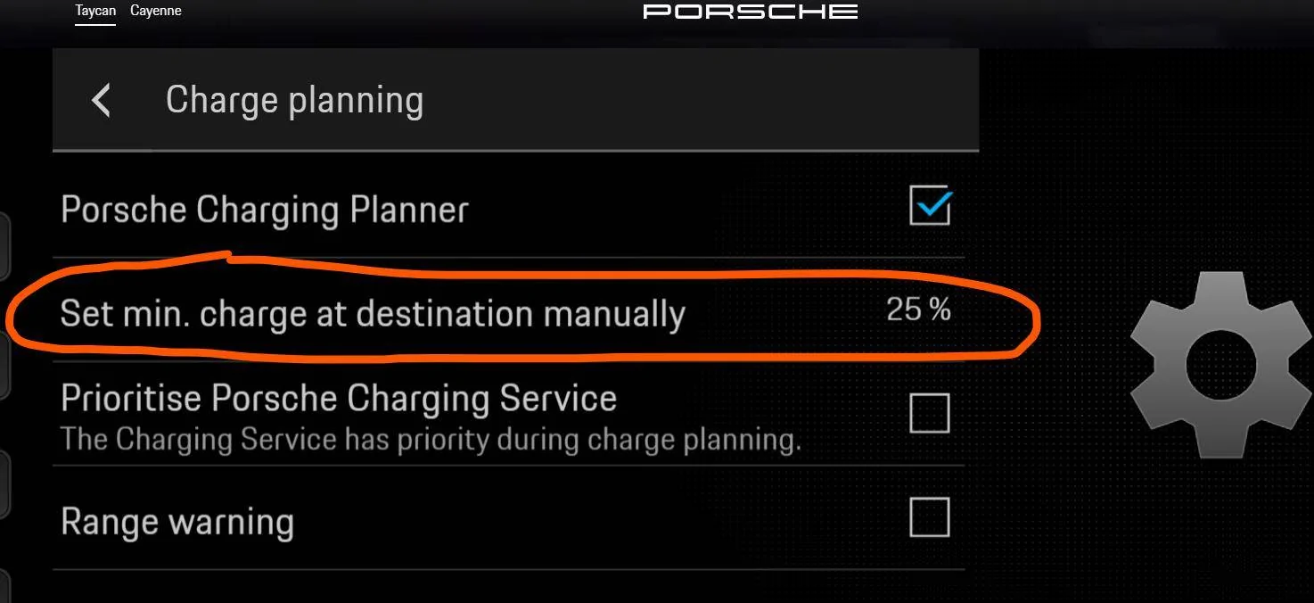

Short of turning off PIRM (which I don't think I want to do because I want to retain the battery pre-conditioning), does anyone have any suggestions on changes to settings to address this? Can you designate your house as an exception or as a charging destination (for me only as it would be a disaster if a bunch of Taycan owners started showing up for a charge)?
If you set the SoC at destination to a very low level ( I think 3% is the lowest) it will not try to make you stop at any charging station in your case. If the charge level would be lower than 3% than you need to stop and charge. I am so happy to not have PIRM in my car because of that adjustment of speed.

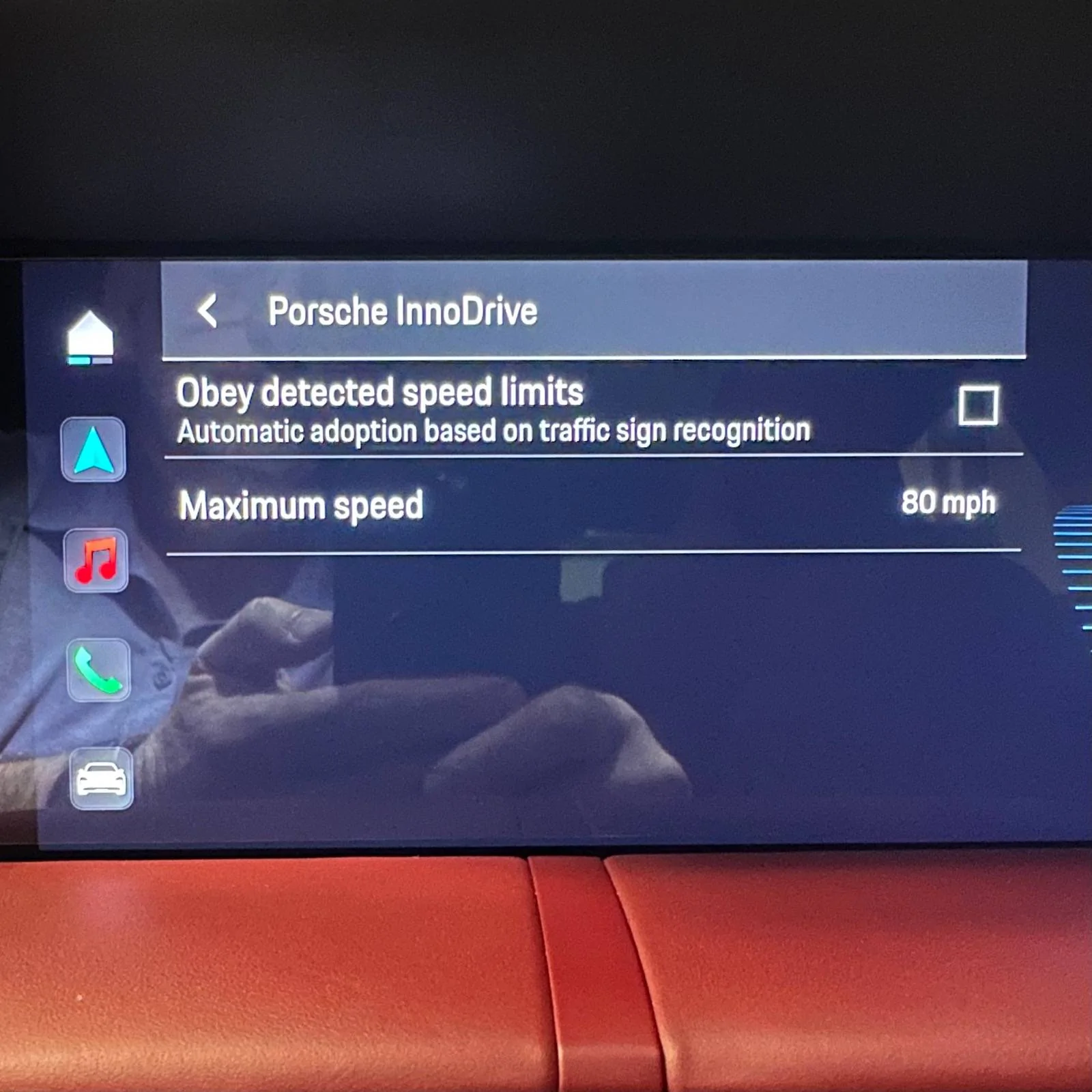

I know this is a late reply but could your speed variance problem be caused by using InnoDrive instead of the standard adaptive cruise control? I find ID useless since every time the speed limit changes (and it changes often) it slows the car down to match the posted limit. Just a thought.
