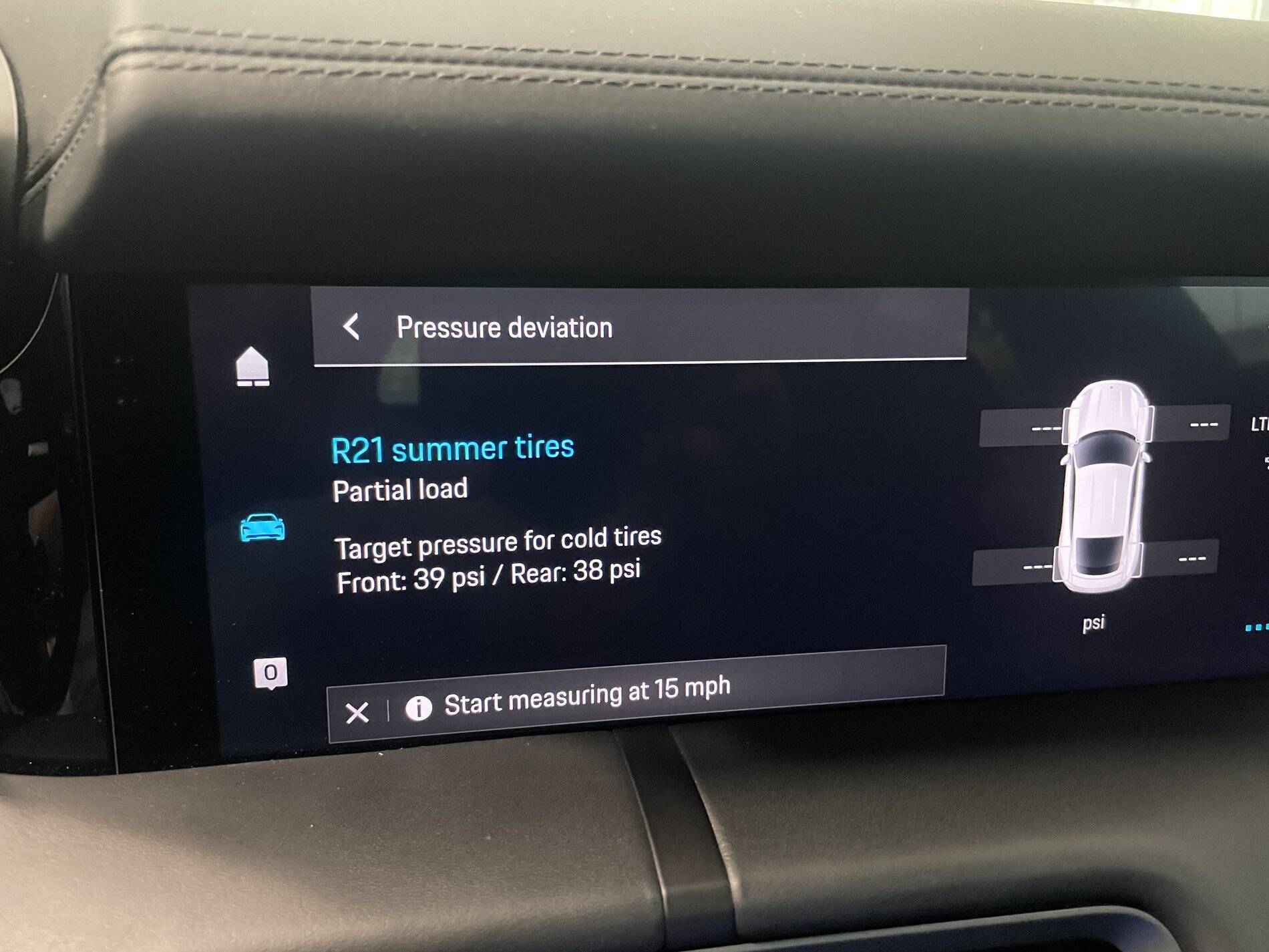

Before going further, try going into the menu Settings; Vehicle; Tire pressure monitor and reset the values for tire type, etc. in the central display, just as if you had installed a new set of tires. (see page 256 of the manual) Maybe that will "reboot" and clear the system.

Change twice the size or type of tire in the settings and drive a bit. It should reset correctly.

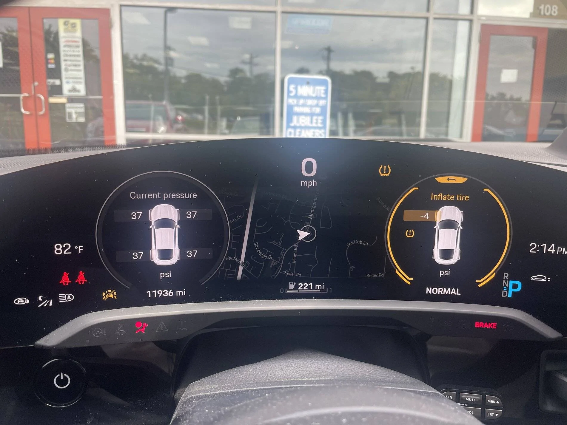

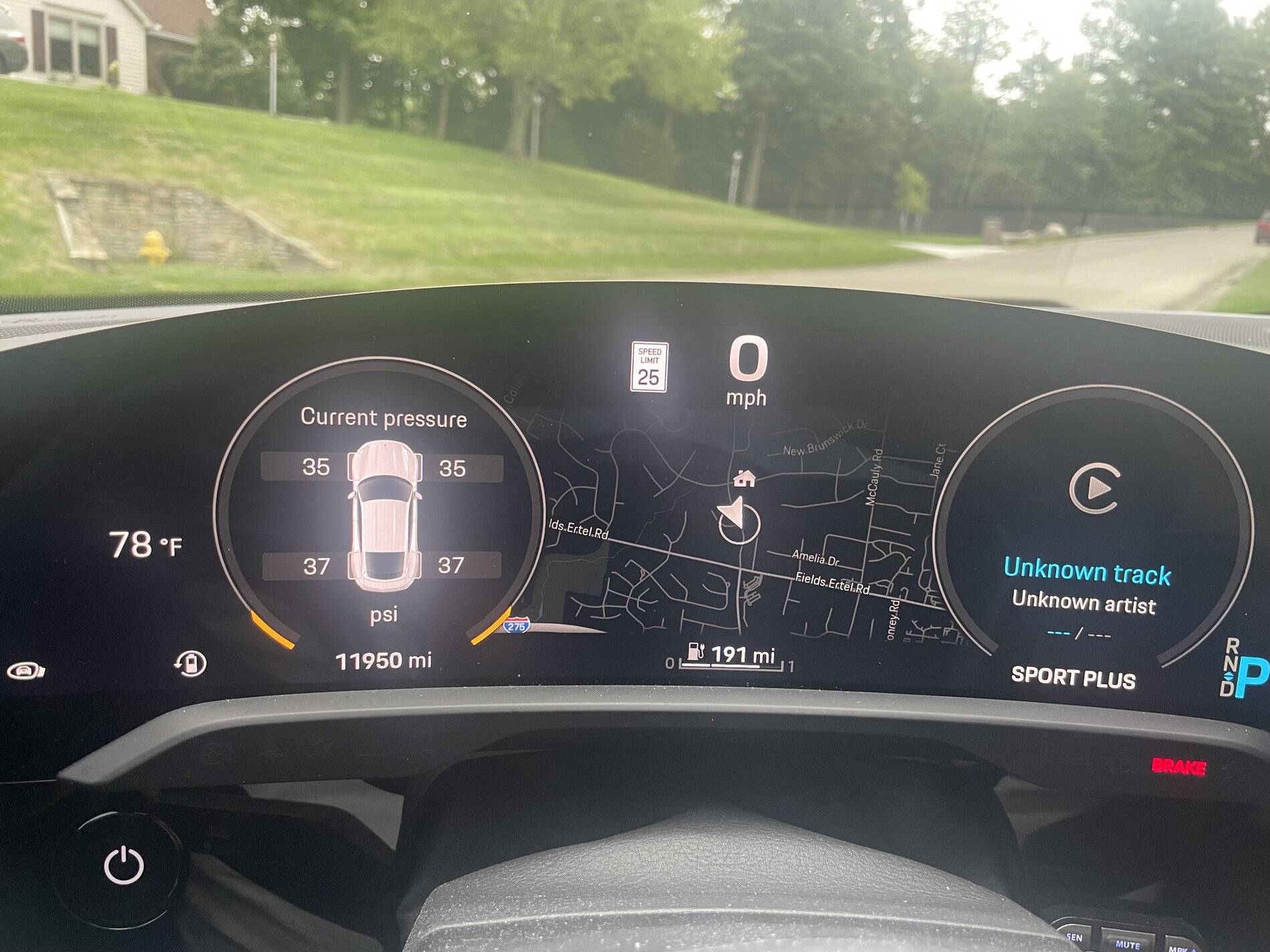

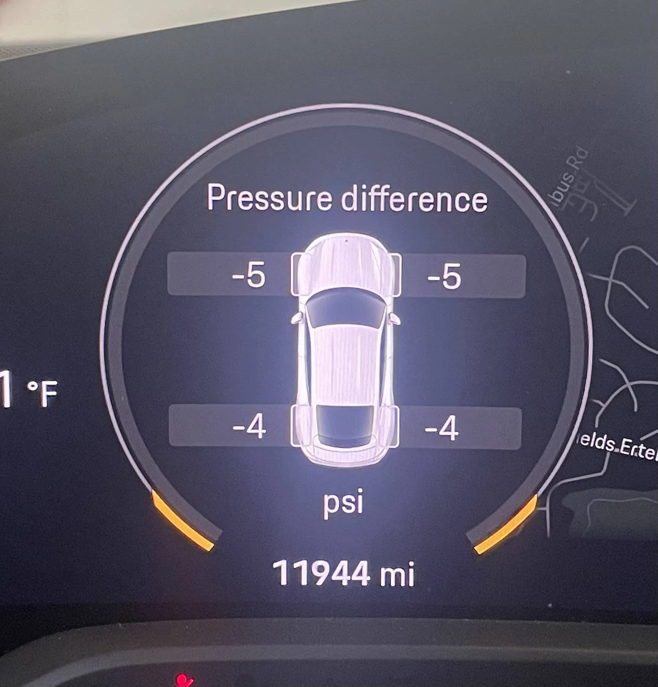

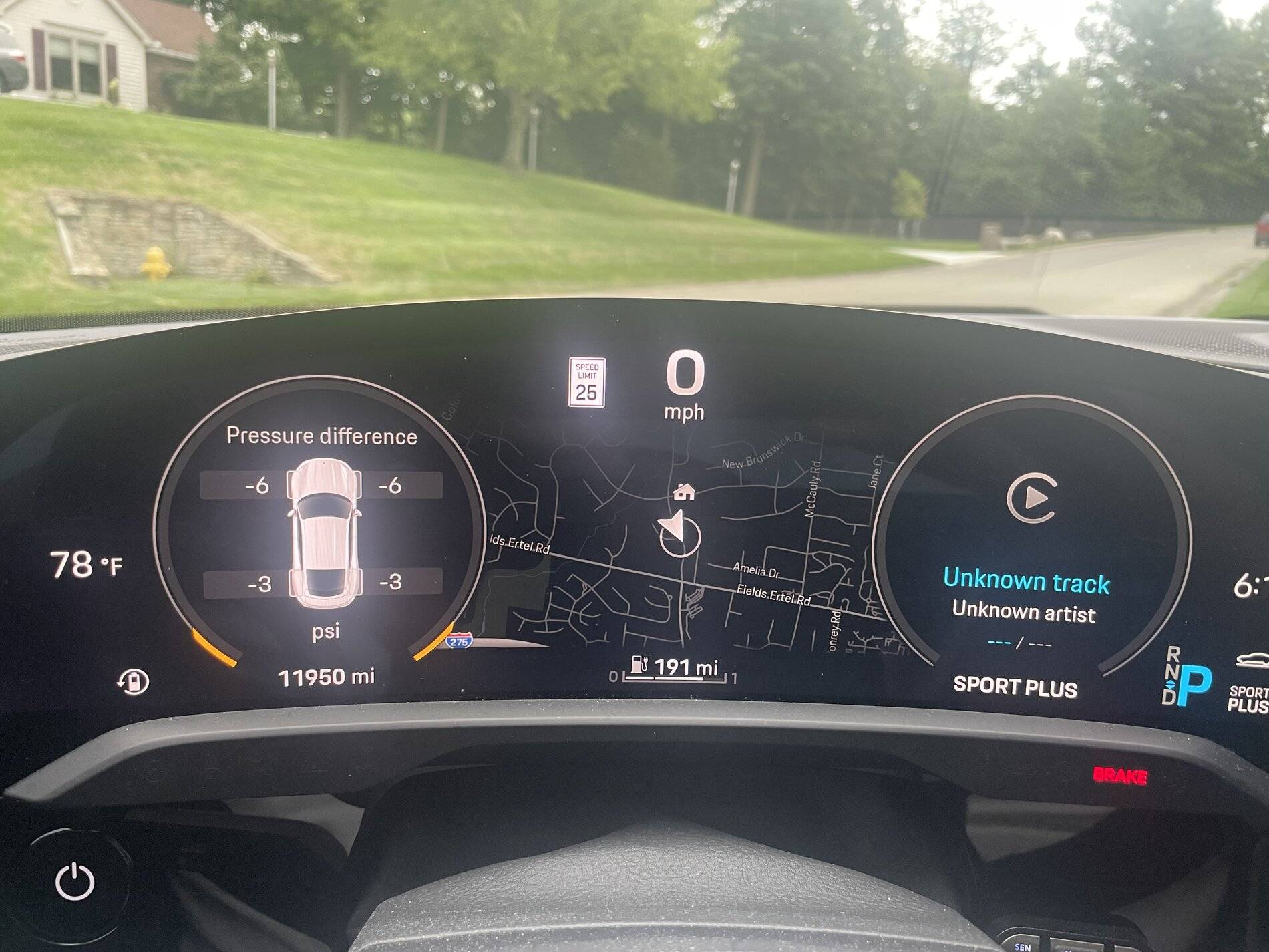

I've had this happen multiple times, and will be taking this into the dealer. I've switched from 21" summer to 20" summer tires and the TPMS resets for a few days and then it comes back to the warning shown below. I switch it back to 21" and it is ok for a day or two, then gives me the same message every time - low pressure on the lf tire.
I checked the recommended tire pressures in the manual and they are 39/38 so I don't quite understand why my 37's all around are showing 5 psi too low in the front and 4 psi low in the rear.
Did you ever find a fix for this? Every day right when I pull into the parking lot at work, my front right tire warning lights up saying it is flat at -5 (it never is). I reset it by switching to a different tire and back, and usually randomly one time on the way back home, at least 1 and usually more than 1 tire will once again light up as flat (between -4 and -6). Have confirm multiple times the tires are fully inflated while cool and warm. Frustrating to constantly have this warning on, and potentially miss a real flat tire.
