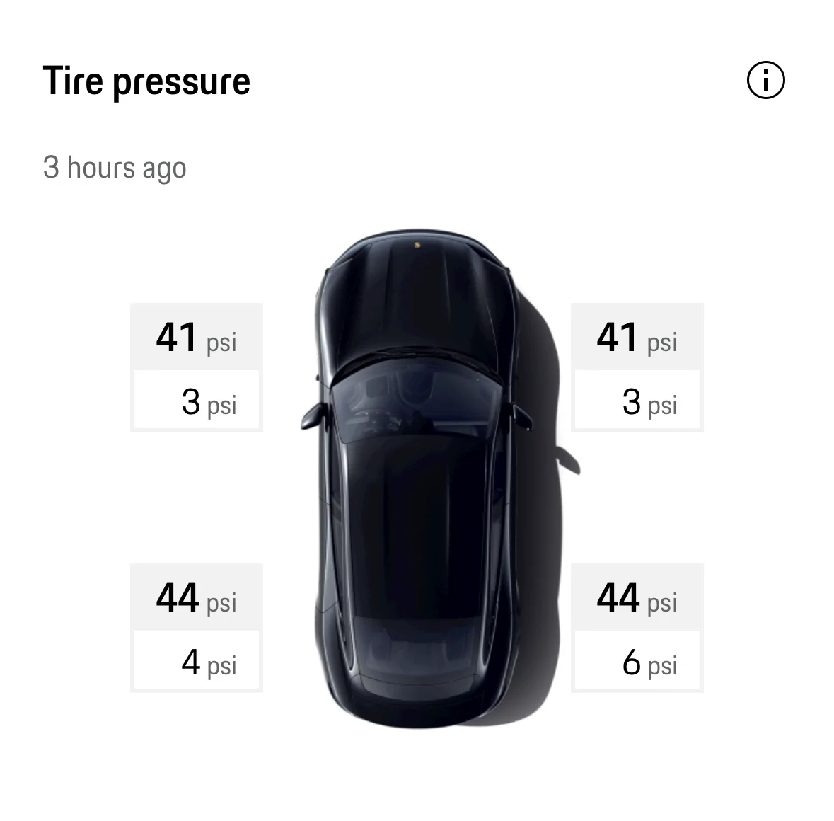

So, safe to say that the dealer put in too much air and I should let some out, or do they know something that the app/car doesn’t?
21” Mission E wheels.
41/44 is my cold pressure target based on the sticker on the car. ?

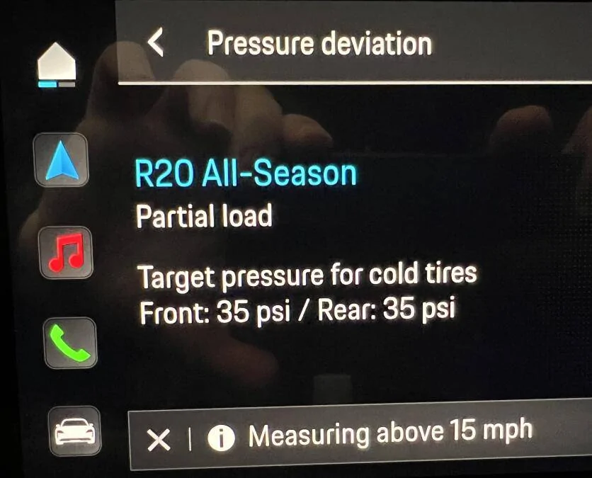

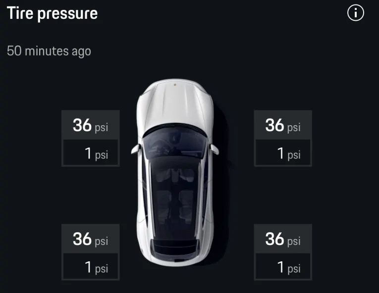

My car has been in my garage since yesterday. Even though the tire pressures are supposedly measures only when driving, apparently the car reported a measurement 50 minutes ago. Given it's about 63F outside, garage probably similar temp, I'm going to guess "cold tire" is probably defined at maybe 50F/10C? I currently have R20 all-seasons on at partial load, PCM says it's expecting 35's all around, which agrees with the pressure differential of +1psi showing:

The current pressures are actual, not adjusted for temperatures, so the tires which are at exact desired pressures can show different values as their temps may differ. The pressure deviation is adjusted for temperature (according to the manual).
Ah, that makes perfect sense.
What makes a little bit less sense, is that the deviation is now showing 6 and 7 psi respectively for my rear tires.
Since this is temperature-compensated, it should have stayed stable. I didn't mess with the tires, and I doubt someone's put air in without my knowledge... ?
I guess my best option is to let them cool down and then carefully drive to an air station, and measure there. (The "careful" part only so that they don't heat up messing with my measurements, not because I think they're about to blow, they should be well within tolerances.)

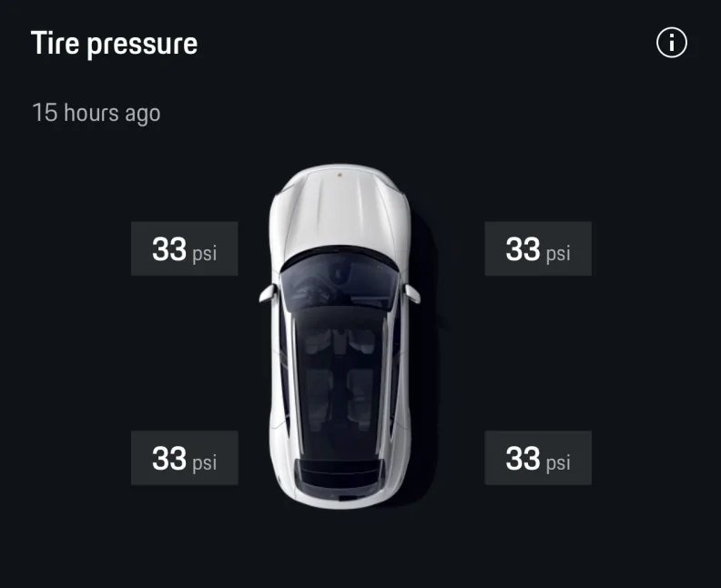

Ok, so I adjusted my tire pressure using the differential pressure it was showing. It worked to show +0 for all tires. Then temps warmed up, and the tire pressure showed +1 again. I left it alone, thinking maybe rounding error. Then it got really hot (>80F) and pressure started showing +0 again (on all 4 tires). It cooled off somewhat (58F outside right now, car in garage showing 64F), the car shows the tire pressures from 15hrs ago show +0 at 33psi even though the expected cold shows 35psi all around

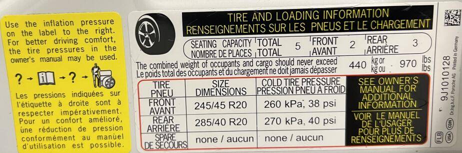

while the plate shows this:
Porsche Taycan Tire pressure after buying 1684805034344
Worth nothing, the all-seasons is what came from the factory with the car (I speced them).

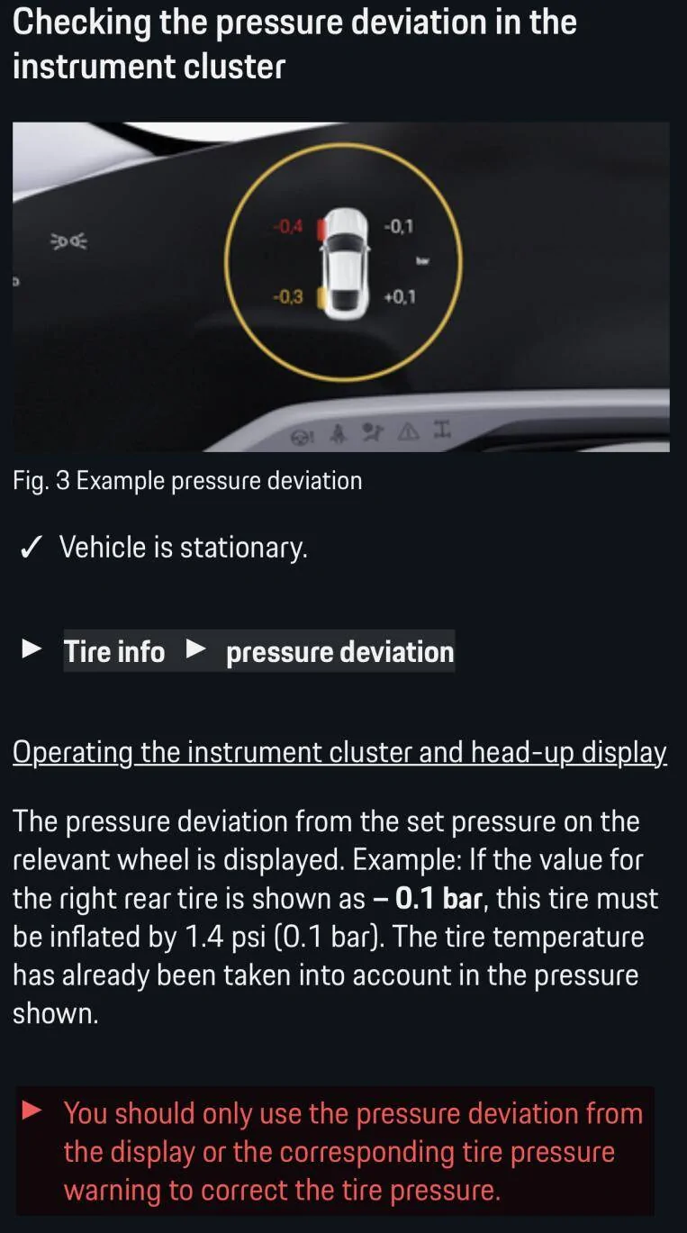

So, following the yellow sticker above, we are supposed the label on the car, unless we want better driving comfort, in which case we are supposed to be using the user manual, which says to adjust the tire pressures as per differential pressures showing on the instrument cluster or PCM (see red text below).
Porsche Taycan Tire pressure after buying 1684805225673
So it seems you just have to follow directions and read stickers, manuals, and car screens. :CWL:
