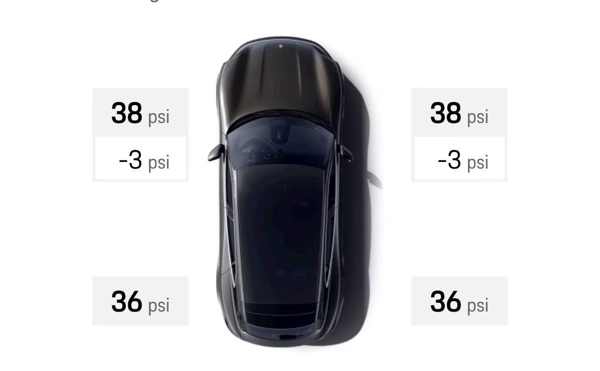

Hi,
I moved from 21 to 20 but the tires pressure plate is for 21 inches. When I compared the manual and the tire cluster on the dash the pressure difference give me contradicting information.
Can someone with a CT 4/4s having 20 inches wheel delivered take a picture of the tires pressure plate from the driver door frame?
Thank you

Thanks. The issue is only with the front. The TSB or the manual says 37 psi. The PCM shows -3 psi when it shows 38. then it should be 41 PSI.

The charts in the US manual / TSBs are more comprehensive than the door sticker.
Have you updated the TPMS settings in the PCM to indicate the change in wheel size, tire type, full/partial load etc?

21" summer Tires on our 2020 Turbo S inflated to the values in this table agree with the PSM within 1 psi. We inflate all four tires to 40 psi (partial load, two people and groceries) and the PSM tire pressures are never off by more than 1 psi.
