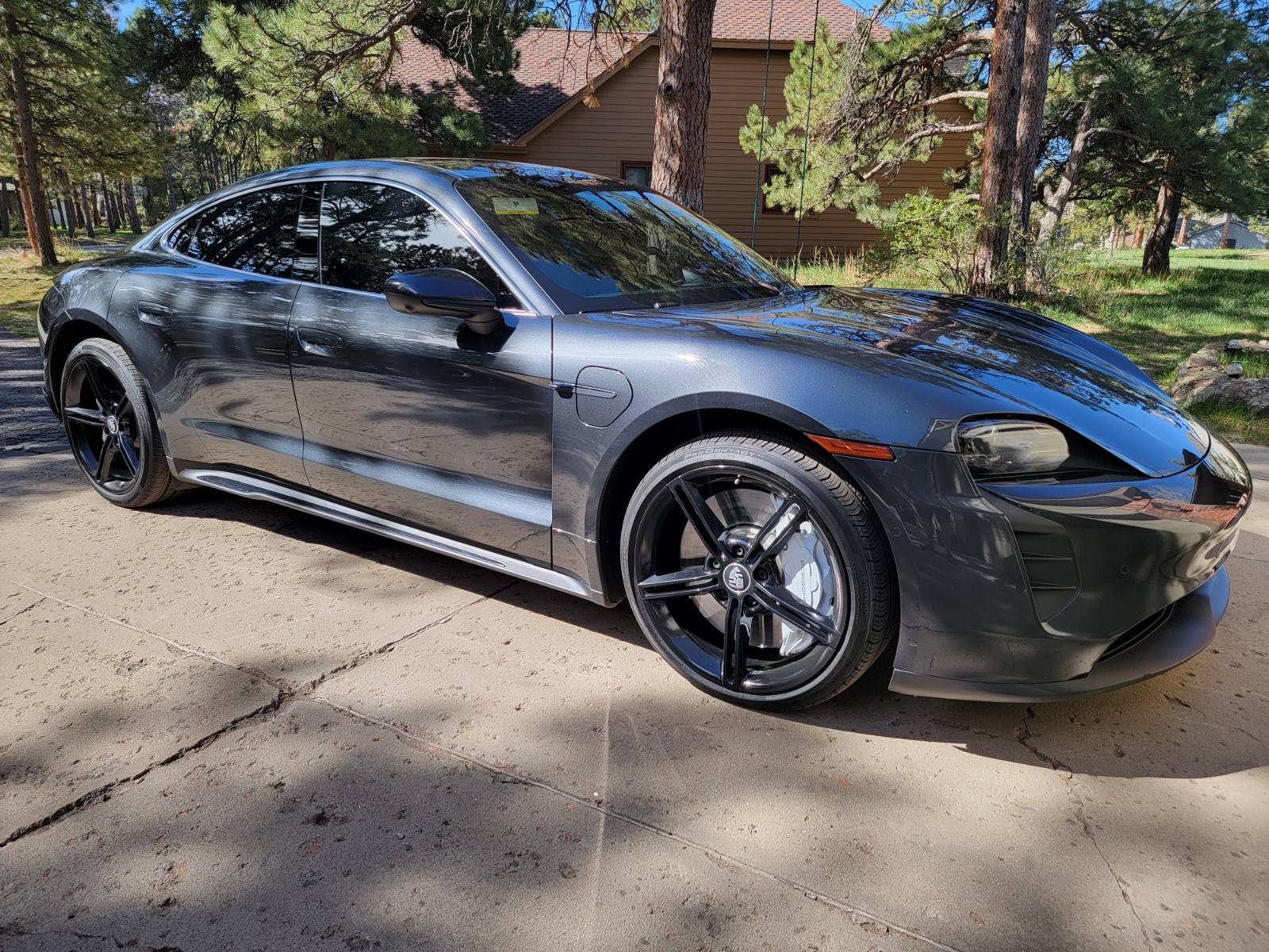

Going to take the Taycan to the track. Being such a heavy vehicle and heavy technology curious get some input some I'm prepared. I've tracked my 991.1 TTS at Novice level.
Here's my Spec:
2020 Taycan 4S with Sport Package (Sport S) with the Continentals
Things I know.. Bring torque wrench.. Tire Gauge/Tire pump. Remove items..
-? Any insight on the tire pressures at say 75 degree cold starting pressure.
-? Any insight on best ride high/drive mode and custom settings to enable?
Thank in advance.

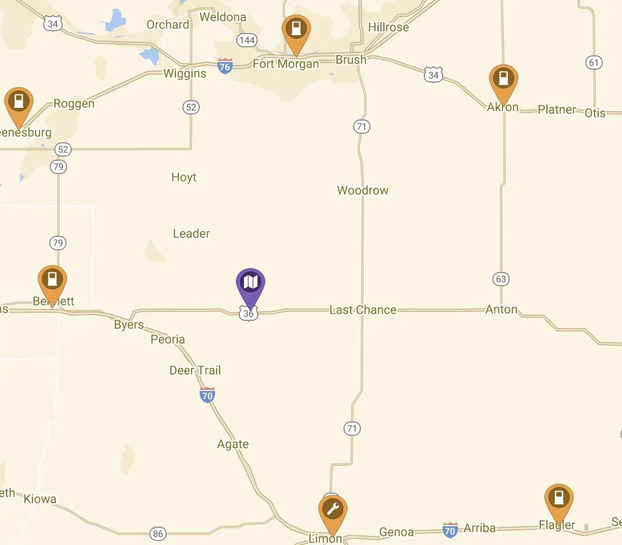

here are all the fast chargers around HPC…according to plug share
clock wise from the top - color coded based on charger speed…
  • Fort Morgan - EA 47.8 miles - 53 minutes from the track - 350 kW stations - 40 min charging to 90%
  • Akron - Chargepoint - 65.1 miles - 1 hour drive to chargers - 62.5 kW - 80 min charge to 90%
  • Flagger - EA 85.1 miles to track - 1:20 min drive - 350 kW stations - 40 min charge to 90%
  • Limon - under construction
  • Benett - Free EV chargers - likely to be congested mid day - 125 kW - 30.5 miles to chargers - 29 min drive - 125 kW - 60 min to 90% charge
  • Keenesburg - 58.7 miles - 1:02 drive time - Chargepoint 62.5 kW - 80 min charge to 90%
that's it for fast charging - so best case is 1 hour round trip (Benett 125 kW) + charging time to top off battery after one session on track…and you need 20% battery + buffer to get there from the track.
this will be a very very hard track day with very limited track time given consumption and lack of fast charging at/near the track - but I might be wrong. you might get 2 session before you're at 25% battery and need to leave the track to top off…
