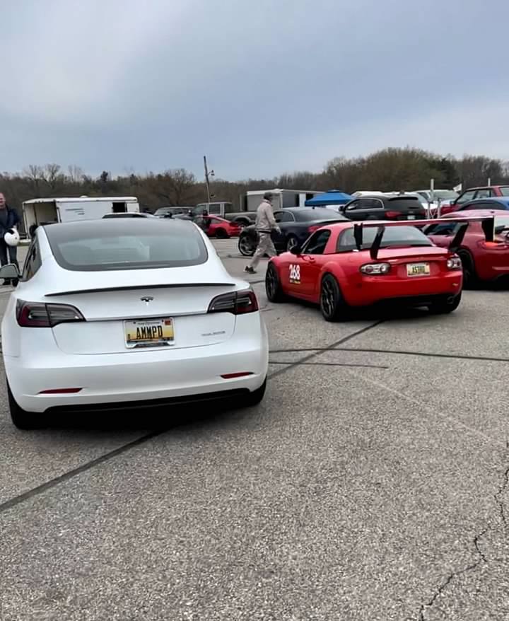

Fun stuff, and I appreciated the video.
I took my Model 3P to a HPDE in 2023 - similar overall experience to yours, except that I was able to plug into a NEMA 15-50 outlet between sessions which meant I didn't need to leave the track to charge. I only ran every other session, which was fine as it was plenty of track time for me.
