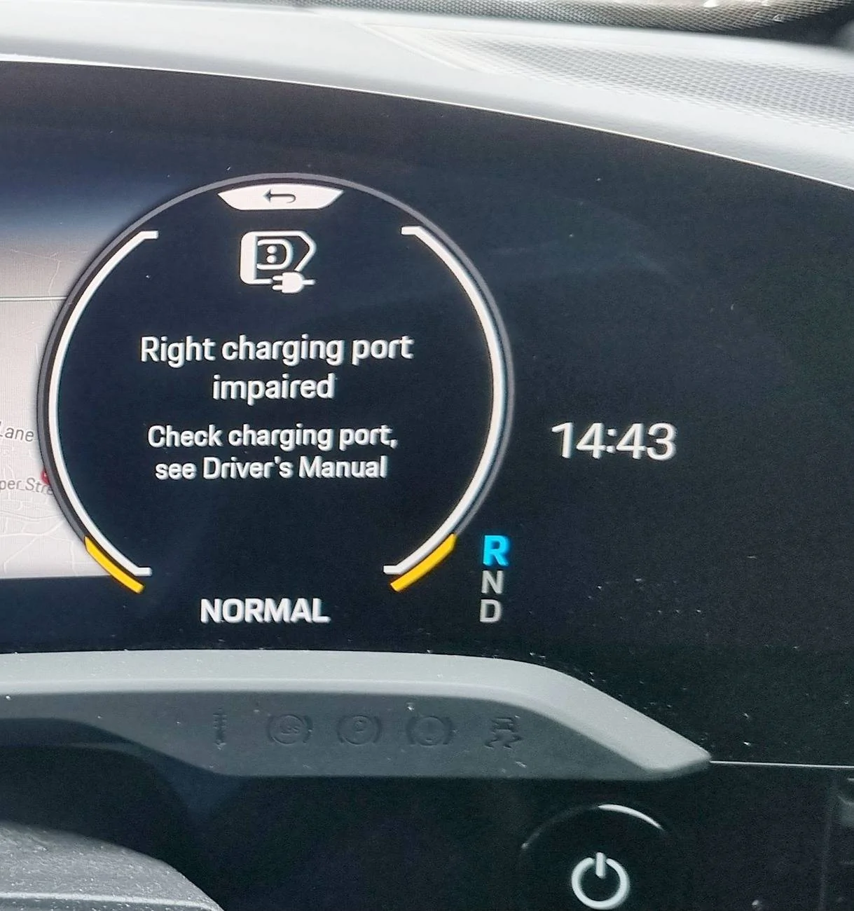

May be a different issue, but I've got red error on RH port.
Won't AC charge on that side now.
Continuous message when driving of 'charging port impaired'.
Pings non stop - driving me crackers!
Will phone Porsche tomorrow (again)...... Can't believe how often this car is at the dealers with faults and recalls.
So busy I really don't need this right now.
The cars a liability.
