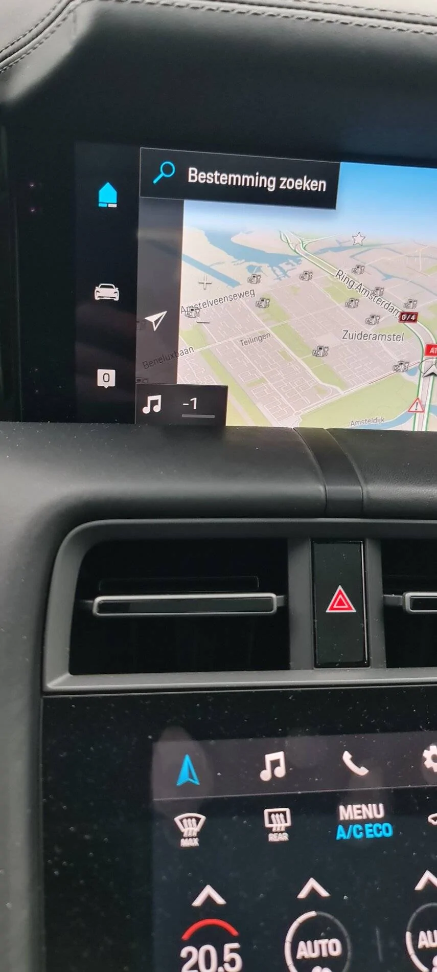

Recently I had two new " problems" one serious and other minor.
1. Suddenly my Taycan decided to switch to a "negative" volume (see pic). Obviously no sound during my trip. The next drive I worked as it should be.

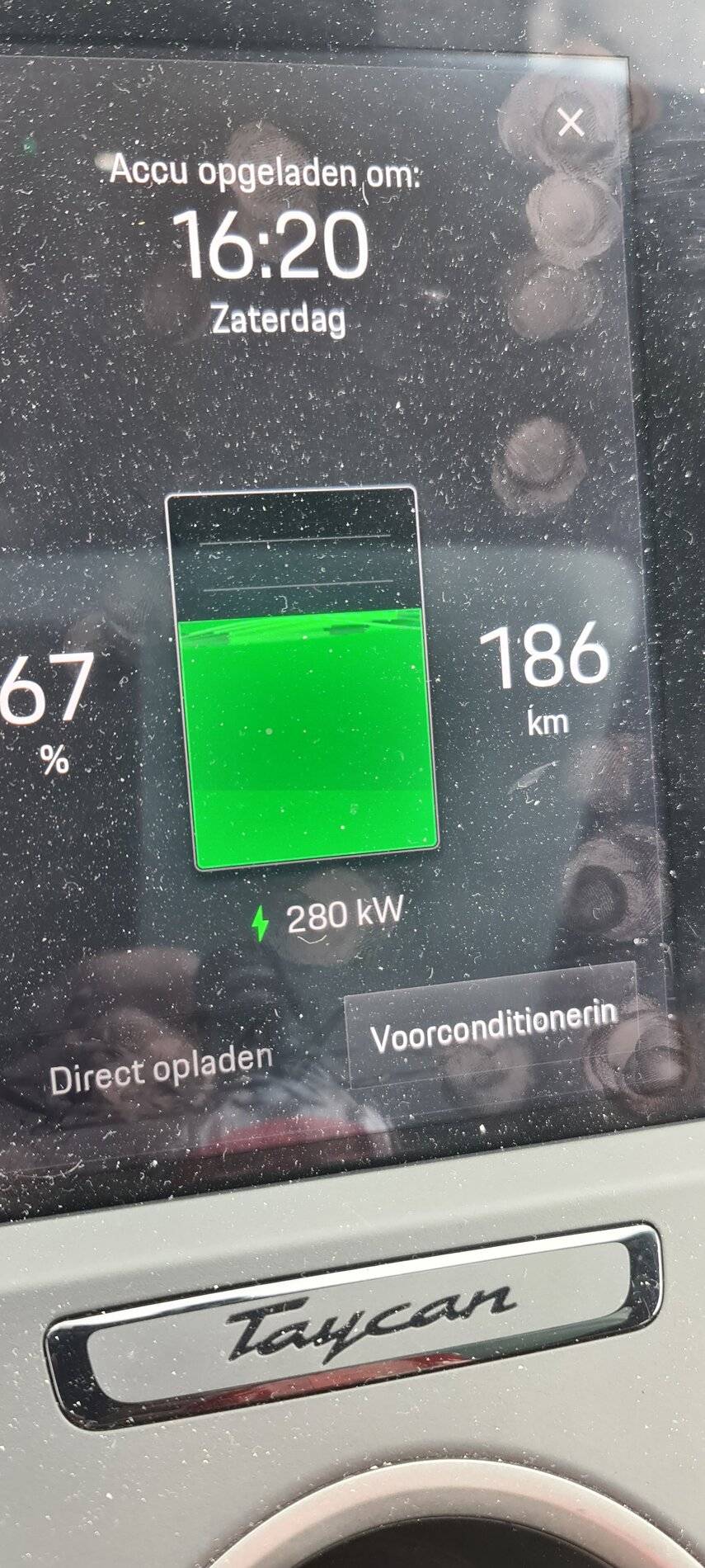

2. A more concerning problem arose during charging. Luckily, I checked at a certain moment how fast it was charging and at 67% SOC it was charging at 280 kw and the charging rate was increasing. Battery temperature was already almost 60 degrees and turtle mode kicked in. I immediately terminated the charging and had to wait untill the battery pack was below 60 degrees before I could drive again. Anybody had a similiar experience. BTW I have beaten all of you with the highest charging rate experienced ;)
Porsche Taycan Two (for me) new glitches / problems 20210911_153444
Did any of you experience these problems?
As others have reported on the forum, this seems to happen when there is a software update in progress.
I can not recall that, I have had enough infotainment updates but never experienced this bug but will check if it happens again. Thanks
