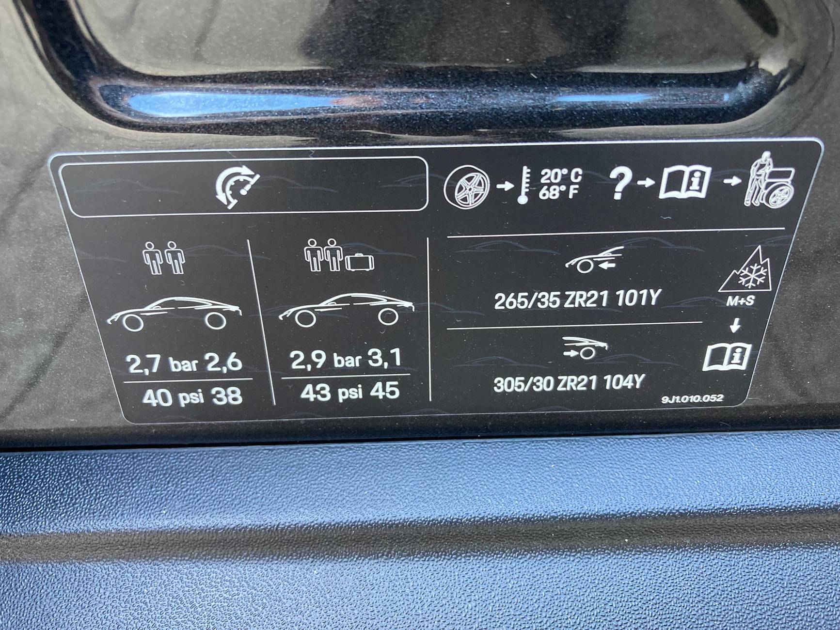

In September they advised me 2.8 all 4 corners; on a turbo.
I have been driving anyway at 2.8-2.9 at all 4 corners, and have seen very little tire wear over 7000+ km

I would think the sticker is the most accurate one because the pressures are probably tire manufacturer specific to a certain degree, or am I wrong on that one?
3,904
3,550
At an earlier stage we concluded in the forum that the sticker values, for same model year, varied depending on tyre manufacturer. Pirelli could have a different sticker value compared to Good Year.
I would have thought that Porsche used the OCM and tyre pressure monitoring system to give the correct value in the car. Depending on options included and tyre manufacturer. They could then easily via OTA update the values to current ones, should they find new data to support new NF0 approved tyres.
Oh wait! Porsche and OTA! Not gonna happen!

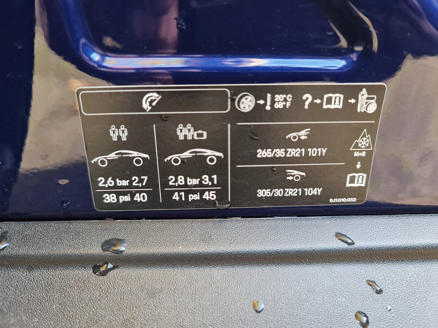

On my CT I have 2.6 2.3 with 20”.. difference at the rear.
its also odd how a Tesla 3 same wight double motor with something like 150kg less requires all wheels 2.9bar!
I reckon suspensions have a big play in it..
Thats with winter tires, no? Lower pressure is understable, for more traction & more safety.
Tesla recommends 2.9 all 4, on 21 inch, for increased range.
I would not trust what it says on the pillar, as they have updated their recommandations in the manual at least 4 times. I would suggest following the manual, in which case 2.7 front and 2.9 back or 2.8 across all 4 is the latest recommandation - 21 inch.
For winter I am also on 2.6 & 2.3 on 20 inch; not what I would like myself, but it is what the dealer recommended me for increased safety

Do the PCM. There you select wheel size, tire type and load. I feel that is the most accurate.
