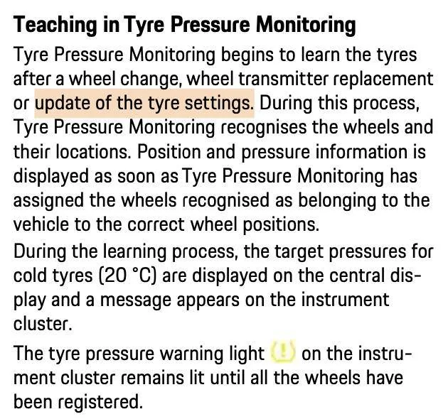

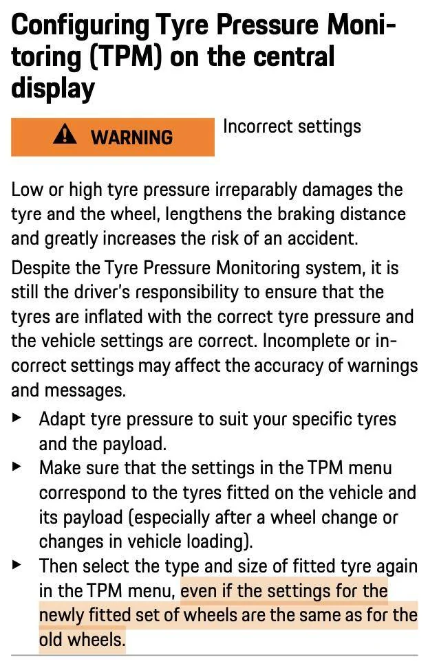

Goto
Settings > Tyre pressure monitoring >
Now change your Tyre Selection to something other than what it is currently selected.
Then select the tyres back to what it was originally.
(Make sure that you select the correct tyres)
The TPM system will now reset.
Now drive away.... and a few minutes later, you should have the new pressure values.

Rational explanation...it's not a Volvo, or an Audi (in which the tyre pressure is usually the same irrespective of tyre choice).
Summer/all-season tyres have very different handling characteristics and Porsche design their cars to handle and ride to the same standard irrespective of tyre choice (after all, why should you have to compromise if you need/want to fit all-season tyres?).
Furthermore, the Porsche TPMS system is more comprehensive than most because it is temperature dependant (with an allowable deviation before it notifies the driver - some TPMS systems show the tyre temperature, but don't use it for calibration).
To be critical of the system is to perhaps not understand it and what it is trying to achieve.
The options are not non-sensical, the tyres you have fitted will dictate the required pressure and hence the calibration of the TPMS. How is the TPMS supposed to know what tyres you have fitted if you don't tell it when you adjust/reset the system?
