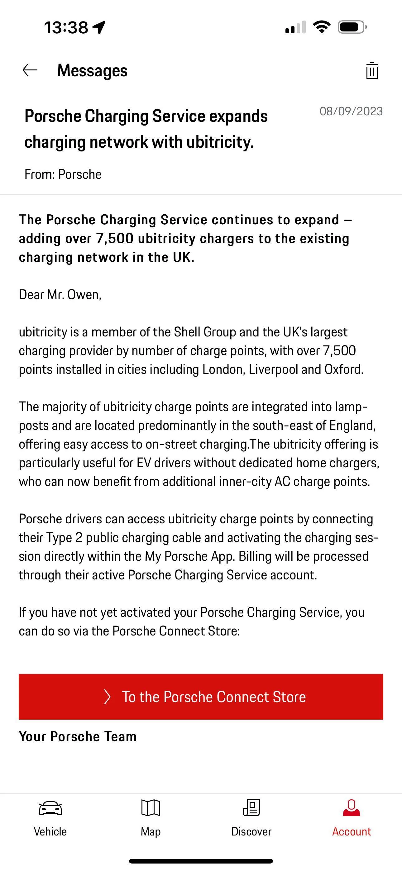

A few weeks ago I get the message (attached) in the app saying that the Porsche charging service now supports ubitricity charging (mainly lamppost chargers in London).
But the QR codes are never recognised by the Porsche app when I try to scan them and the Porsche email support is as useless as ever (they literally know nothing!).
has anyone figured out how to get ubitricity to work with the Porsche charging service?
