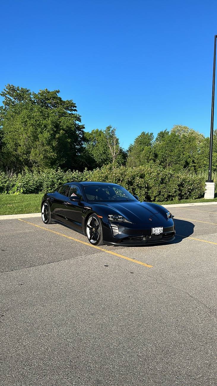

Hello,
After 4 good years with the 4S and 96,000kms (daily driven). Got a sweet deal on a brand new gts 35k (CAD) offf sticker.
Has there been any notable changes from 2020 to 2024? I know 2025 is the refreshed model?
