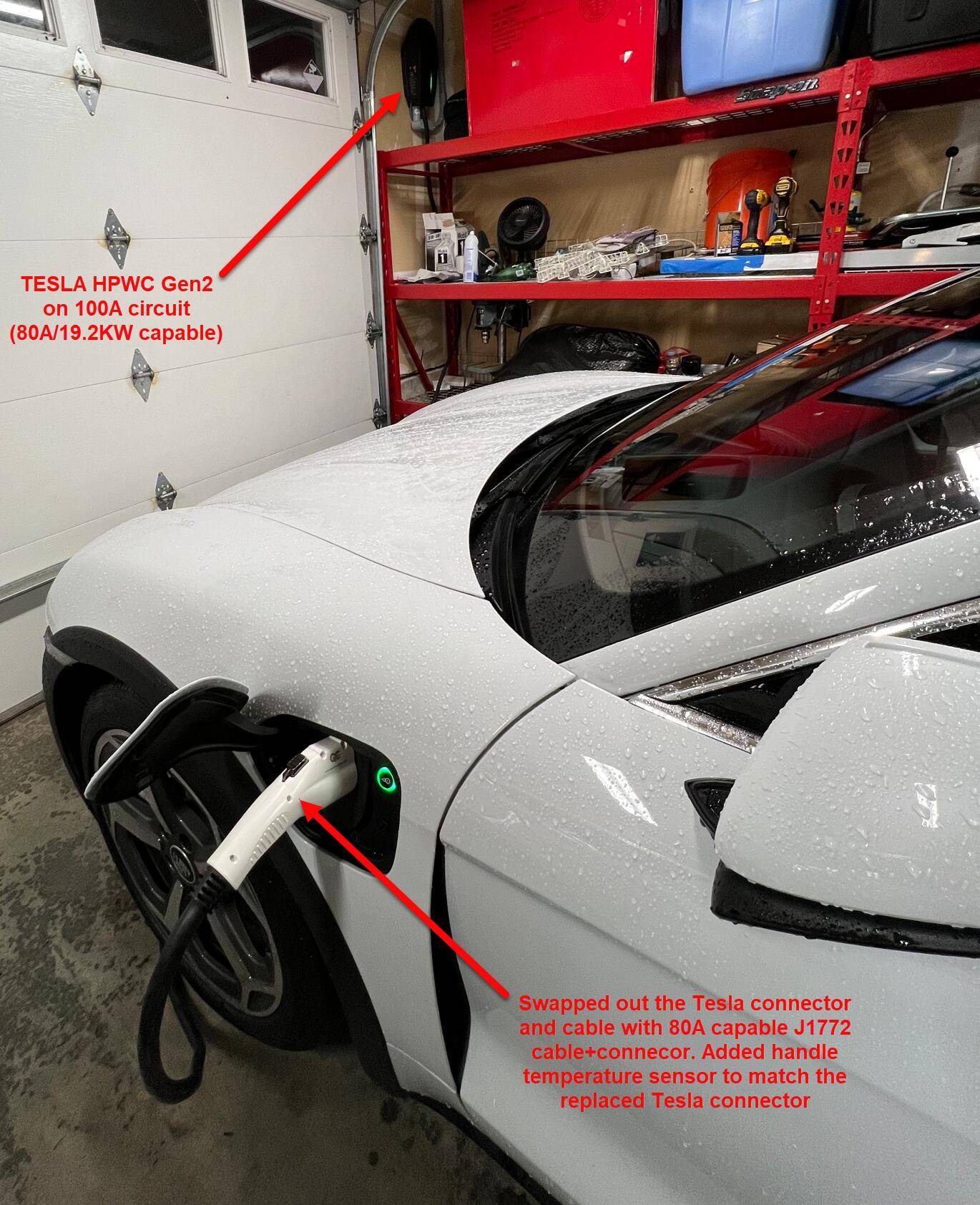

Catching up on updating threads like this, adding my garage to the "for those who wish to overdo it".
Porsche Taycan [US] - Over the Top - the well equipped EV home garage…for those that wish to "over do it"… 1682578337197
Porsche Taycan [US] - Over the Top - the well equipped EV home garage…for those that wish to "over do it"… 1682578351020
There are 2 additional NEMA 14-50 wall receptacles on the back of the garage, one by each car, in case we needed to use a plug-in one. One of the NEMA 14-50 is connected to a whole house generator circuit, so can charge (at a reduced rate) during power outages if absolutely needed. In 10 years of driving EV's however, never ever charged from the generator though (ok, once, to test the generator since I could use my Tesla as a custom load, as Tesla lets you control the AC charging current from inside the car).
