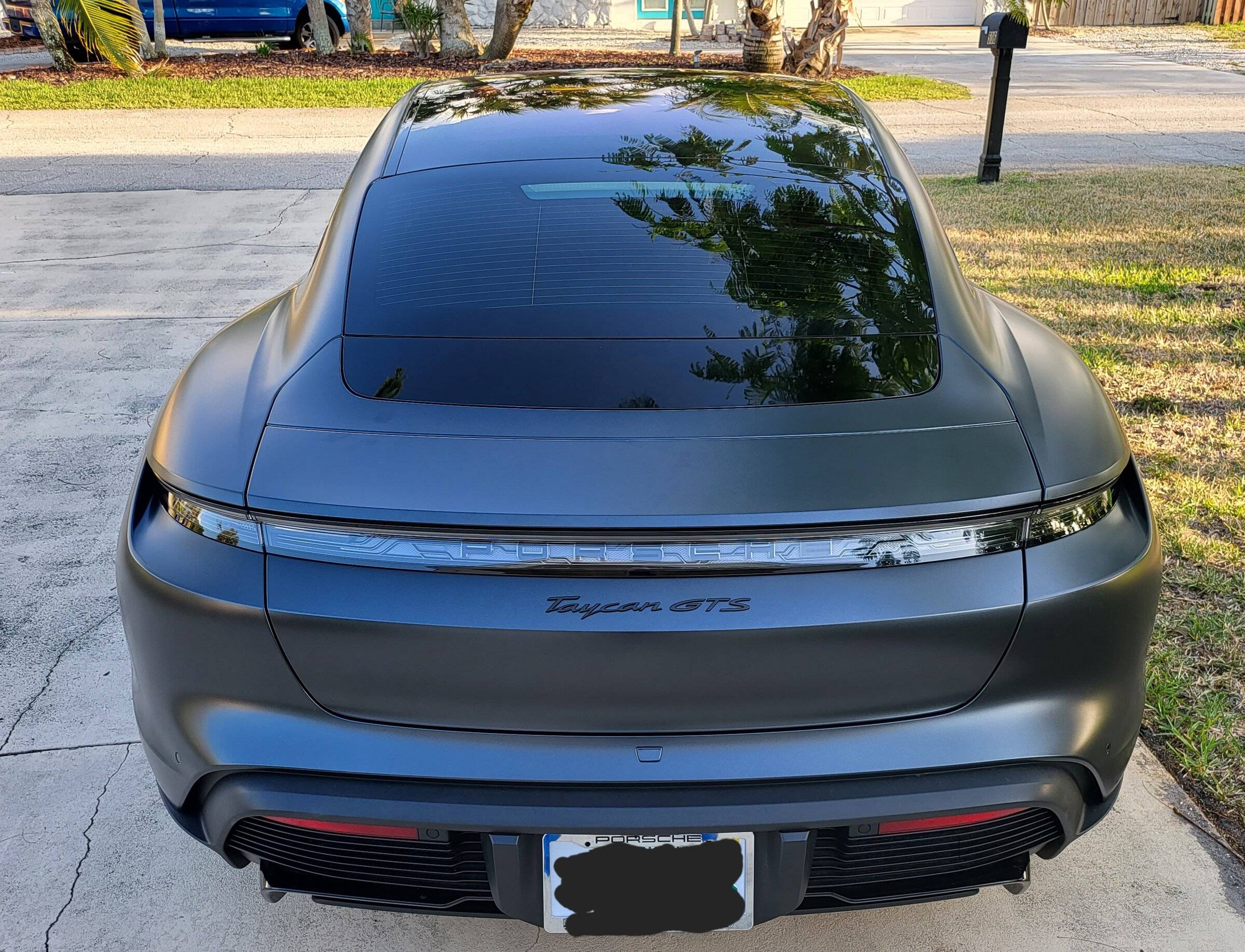

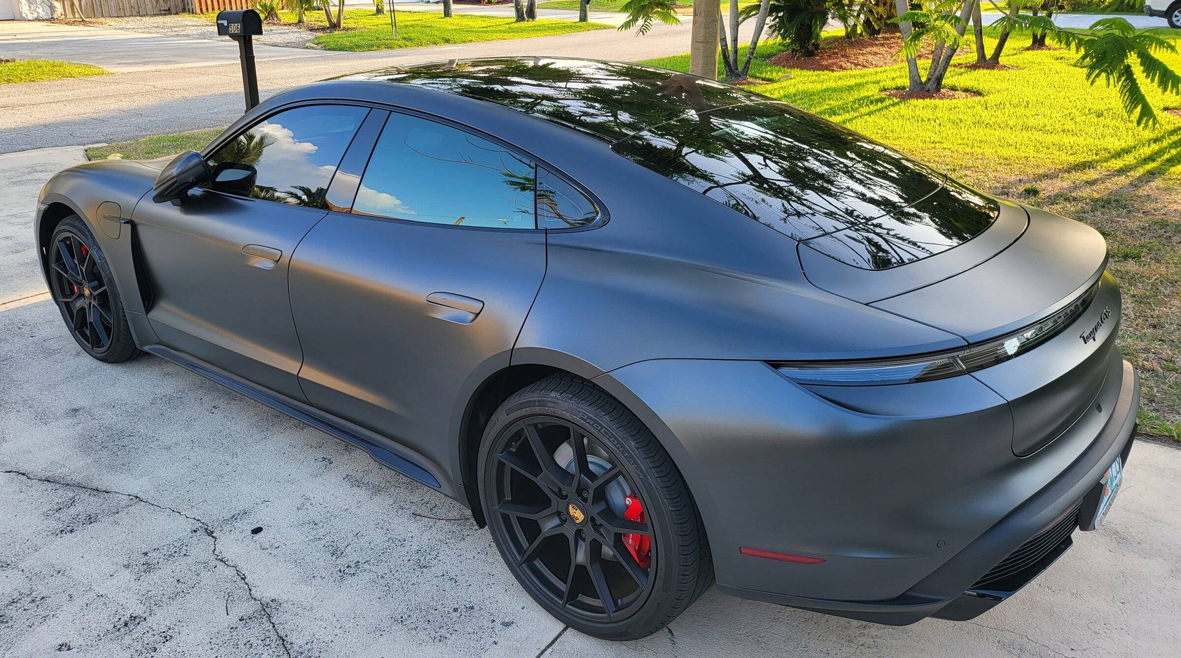

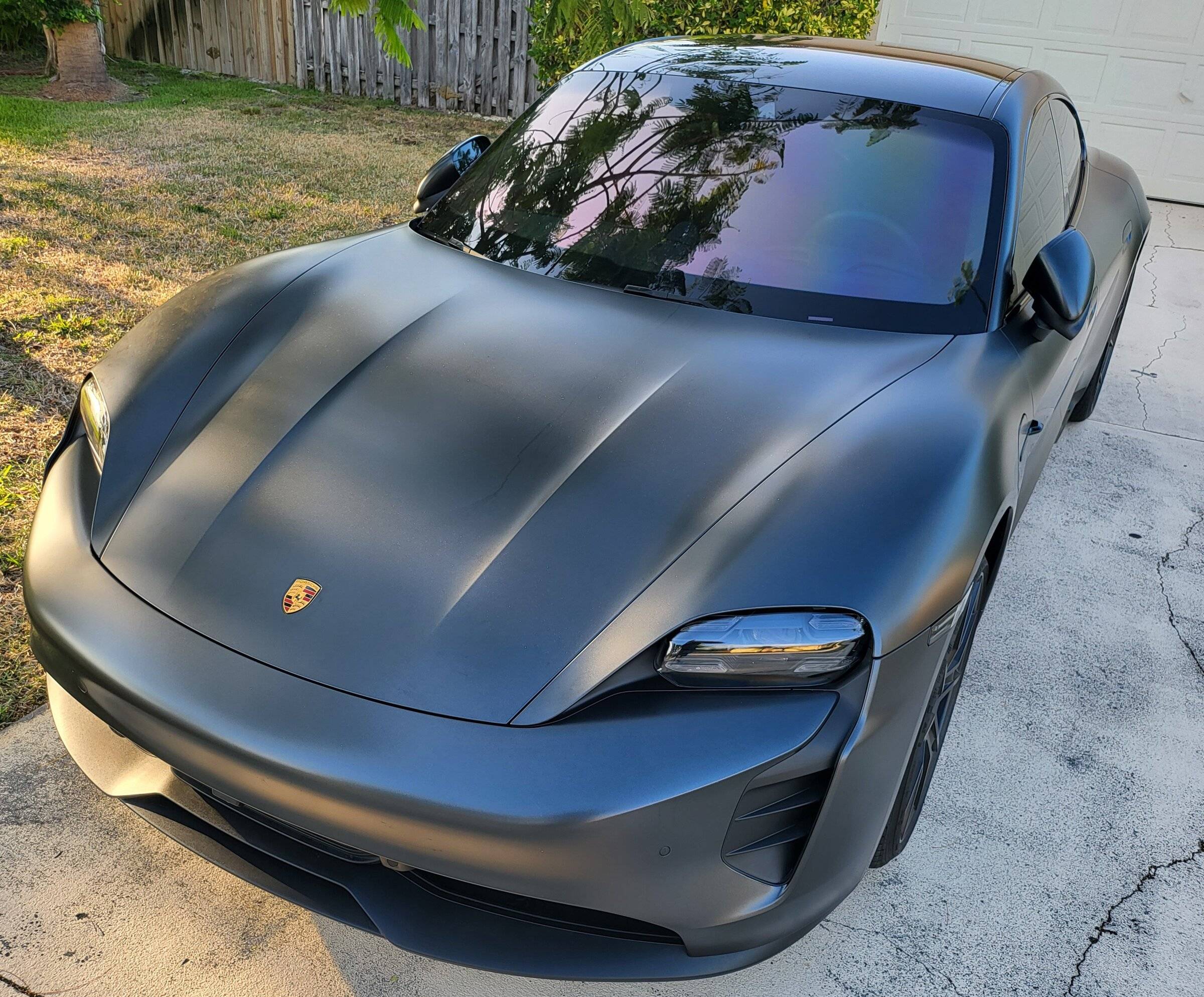

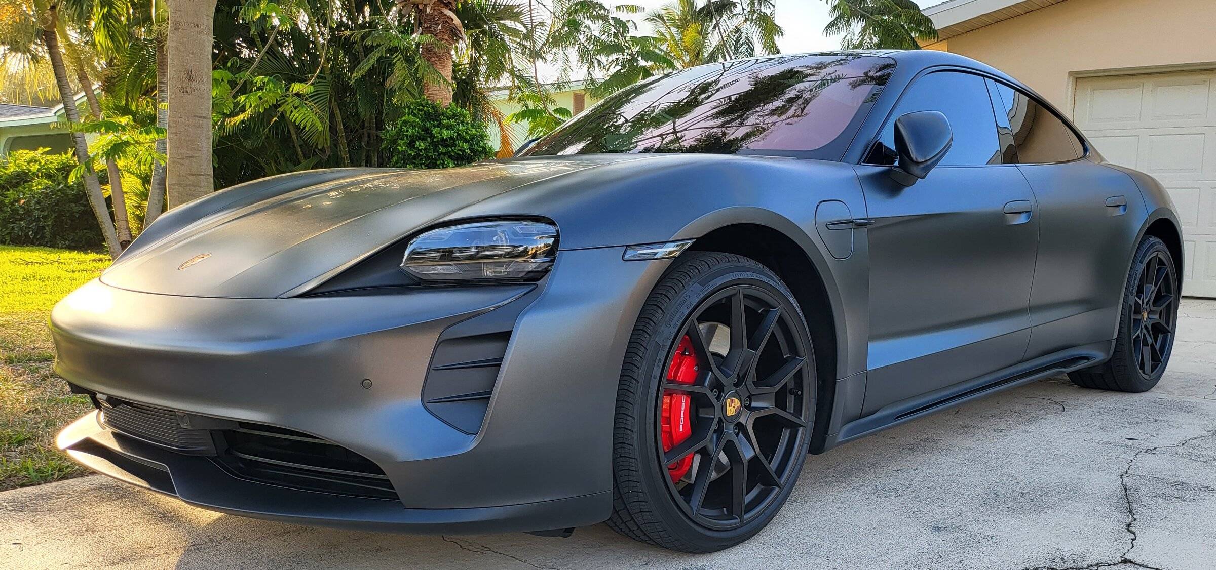

Just picked it up. It needs to be cleaned, but no wash until I take it back for the one week evaluation to make sure everything set correctly. XPEL Stealth.
I forgot I had the lift on for the driveway, so ignore the stance..lol.

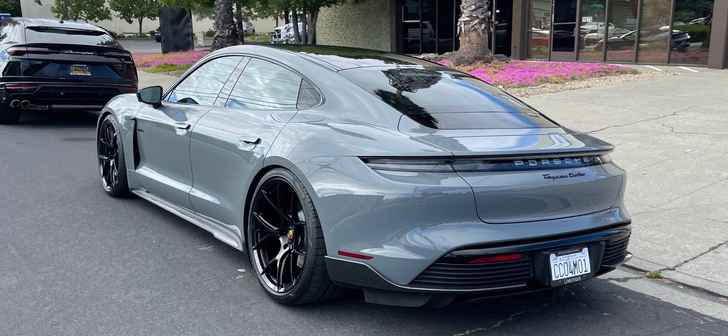

It didn't. Drove it for a year without a single false positive (I don't own it anymore). That issue has a lot to do with installation though. If the installer leaves any detectable gap between the material and the sensor, it will see it as an obstacle. It can happen after the fact too.
