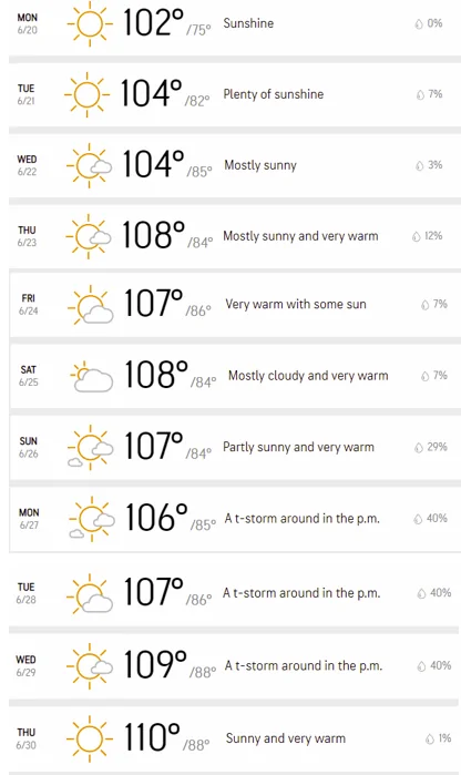

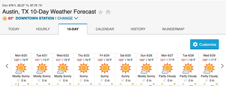

Austin TX forecast for the next 10 days. Only another couple months of 100 degree + weather ?

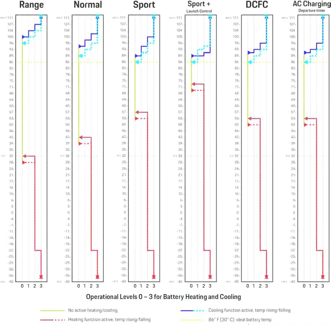

It is pretty simple to understand. In range mode, your AC is in eco mode so not much working frankly. The same AC system is used to cool your battery. So if you have a very hot battery following a high speed DC charge, the range mode have no ability to cool back your battery. If you set yourself in "normal", the AC system will work at full force cooling your battery temp.
The battery is integrated into the vehicle's cooling circuit via a line system and a coolant pump. It can be cooled or heated so that it always operates in an ideal temperature window. The battery can also store the waste heat from the liquid-cooled high-voltage components. As a result, it serves as a thermal storage device or buffer, which permits intelligent functions such as conditioning to ensure driving performance: the target temperature of the battery is determined on the basis of the battery charge and the selected driving program. This ensures sporty driving performance and allows Launch Control to be used.
Depending on the outside temperature, the battery is preconditioned to a certain temperature level when the vehicle is connected to the mains for charging. The interior can be preconditioned independently of the mains

I didn't come across that nice drive mode diagram before, thanks!
This explains so much of what I was assuming, guessing, measuring.
If what you're saying is correct, that means any time you drive in Range Mode you risk potential additional aging, since the battery temp could always get up there. So for example driving through mountains in Range mode just as bad (uphill large power draw, downhill recuperation - both heat up the battery).
you also risk even more aging at the lower end of battery temp, if 86°F (30°C) is the optimum.
my BMS reports 94.1% state of health at 18000km and I drive a lot with range mode but nearly never with battery above 35°C. So I could assume that battery wear would be less with driving normal and sport mode in the mostly cold months?
I think this image explains everything
Porsche Taycan Warning about using range mode, in hot weather, after DC charging 150kW+ E6C83A89-299A-46B4-9230-6469713A55BC

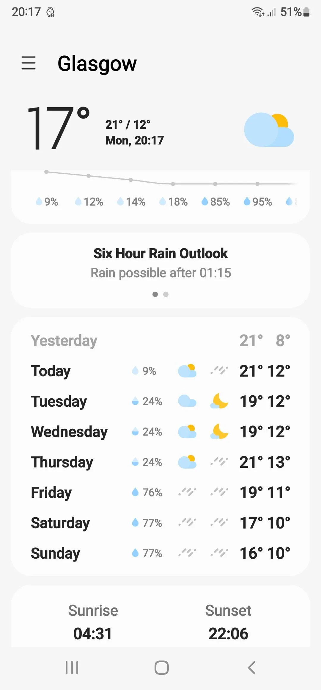

It's positively balmy here ?
