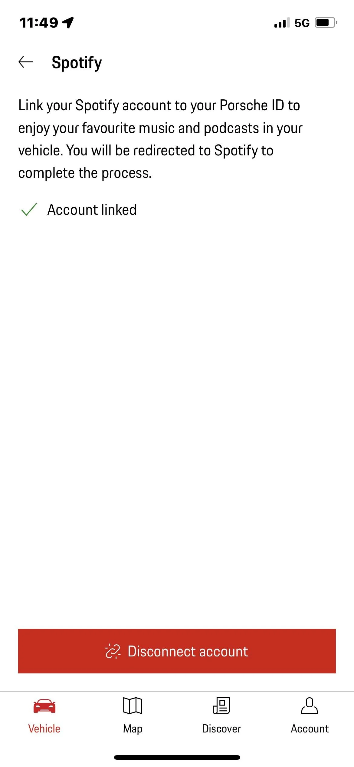

Somewhere in here or a related thread, an owner suggested initiating the link from PCM to Spotify within the mobile app. So I tried that (see screenshot from my phone), then rebooted the PCM. This time, the error looked the same as it always does, except this time it gave me error code #3019 (was #3011 before). This doesn't feel like progress.....
4thPcar - I went through the same process and also received these errors but it doesn't fix anything. I've spoken to my dealer at length about this. Porsche are aware they have a problem with Spotify logins but are taking a ridiculously long time to fix it. I suspect they've got other bigger problems with their software stability and up time and so are addressing those first.
