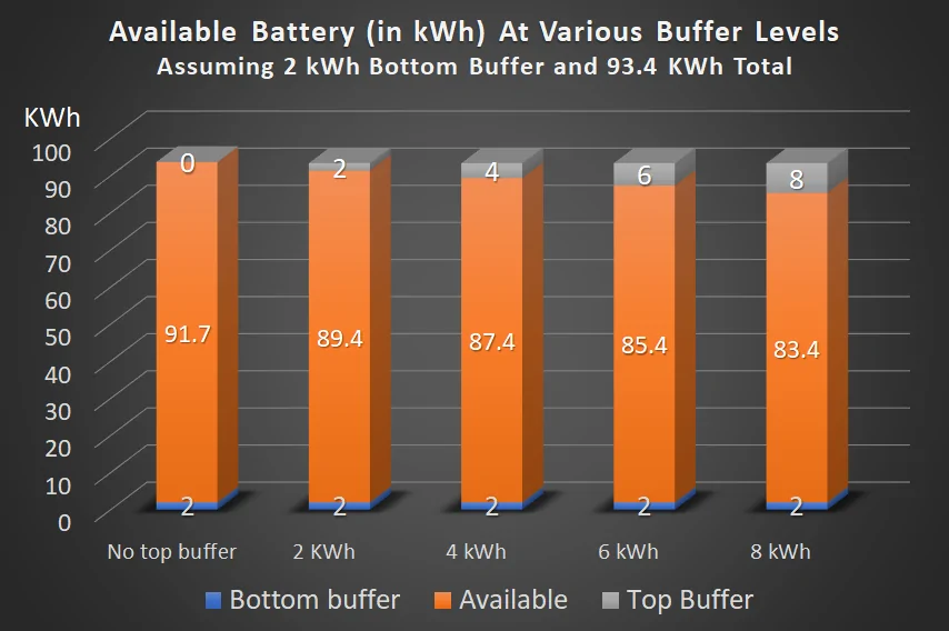

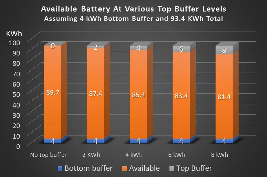

You may be correct - as I said, only Porsche knows for a fact. Let's do some math though. First, theoretically available energy assuming 93.4 kWh total. The model S batteries have a reported bottom buffer of 2.5-4 KWh, the model 3/model Y batteries a 2.5 kWh bottom buffer. Let's assume Porsche has similar bottom buffers (2-4), and that gives us the following available energy at 0 /2 /4 /6 /8 kWh top battery buffer:
Porsche Taycan Why is 85% battery recommended as the normal maximum? 1597809993630
Porsche Taycan Why is 85% battery recommended as the normal maximum? 1597810015718
So range of total available is 81.4-89.7 (4 kWh bottom buffer) or 83.4-91.7 kWh (2 kWh bottom buffer).

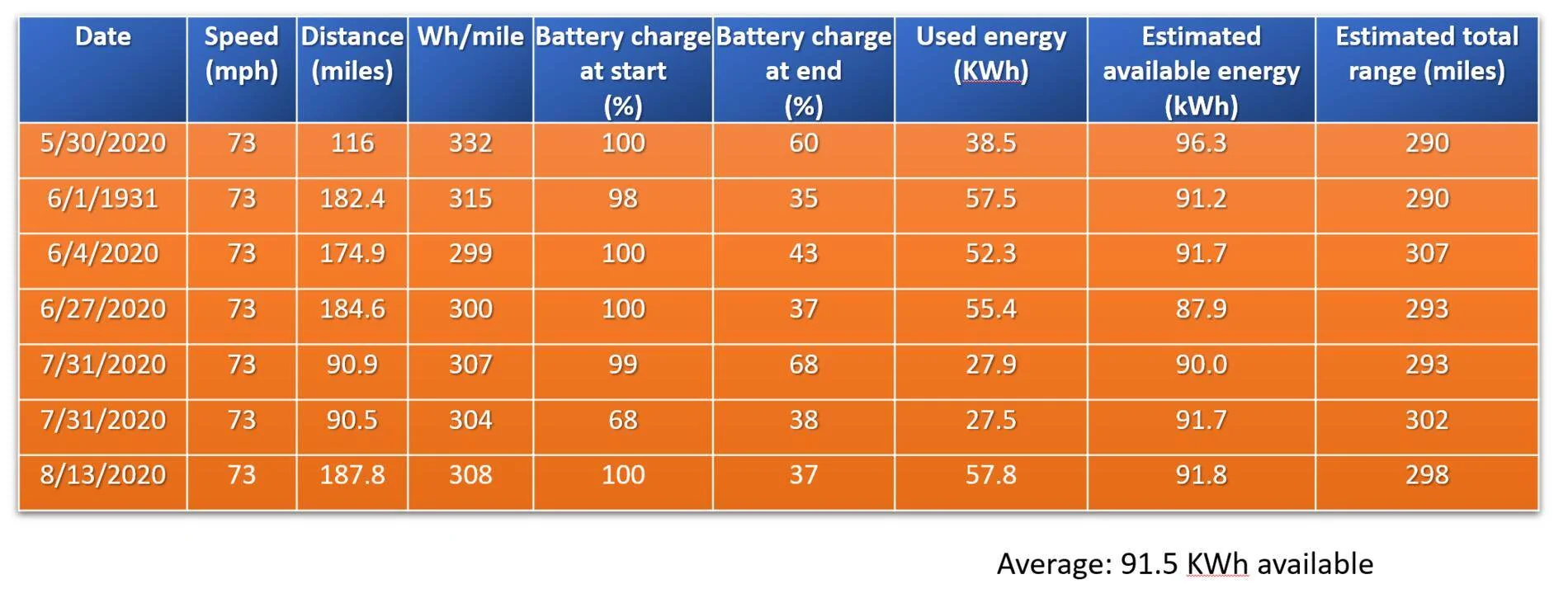

Now let's take my previously posted consumption data on several medium distance trips. I calculate the energy used by multiplying the distance by Wh/ mile, then infer total available energy corresponding to 100% from that.
Porsche Taycan Why is 85% battery recommended as the normal maximum? 1597811475678
As you see, the average estimated available energy is 91.5 kWh. Now of course there are errors:
1. The odometer distance may be inaccurate. This is definitely true, but minor. I plotted on Google maps the routes and the distance was within 1 mile of the odometer. So less than1%
2. The reported Wh/mi is wrong. This can be the case, but there is no way for me to verify that. I would presume though errors should not be too large, probably within the same <1%.
3. Battery size is not precisely 93.4 kWh. This is quite likely the case (averages, imprecision in estimating battery size, etc.). Perhaps I am the lucky recipient of a 95 or 96 kWh battery - which renders all the calculations wrong. But if I assume I am just an average Joe, size should not be that far from 93.4.
I did look how much energy the wall charger delivered to replenish the battery (to 85% ;)) after the last trip (bottom row). It delivered ~13.4% more energy than the one used, which is in line with what I would expect from charging losses - but also indirectly supporting the used energy reported by the PCM.
So after all these exercises, you tell me how much buffer you think we have at the top given all these. My best guess is very little - close to 0.
